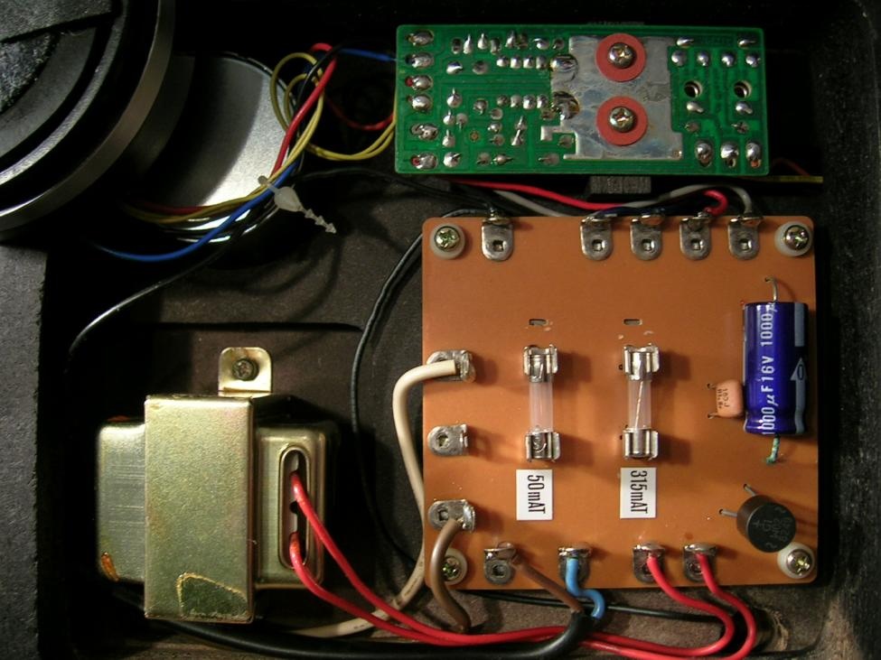

I have a Micro Seiki BL-77 turntable, and with no skills as a DIY guy I attempt to understand this thing.
Parts are not easy to come by, I need a dust cover, the finger lift on the headshell is broken and the headshells are impossible to find, and I am looking at the transformer and motor to if things can be improved upon. I will have to buy another BL-77 in order to get parts I think.
Anyway, the motor in this thing is called Matsushita FG Servo Dc 12 volt MHX-5F2R VM but I cannot find any info on this motor. What I find is this, it looks identical, except the the original cannot be easily opened and doesnt have that screw on the side to pull out a pcb.
Matsushita DC Motor 12 V 6000 RPM 39 mm Diameter 12 V Motor Low Current | eBay
From the turntable to the motor there are five cables, amongst them two yellow, and on the e-bay motor there are four terminals, I am just assuming the two yellow cables go together, but I am not sure.
Thought I should try the motor, but I dont dare since I am not convinced where the cables go.
I have a bit of transformer noise, the table is specified to 220volts, we have 230 here but I measure up to 239 at times. I tried a dc filter, by LCAudio, but it didnt help really.
Thinking about getting an enclosure and mount a new toroid transformer, and the power supply board from the turntable in this new enclosure. The power supply board is shown on the picture here with the fuses. Still have to measure the original transformers output voltage before I can get a new one, but I assume its 12 volts since the motor is 12 volts.
Anyone knows if these old DC motors from Micro Seiki is still available, under another name maybe?
