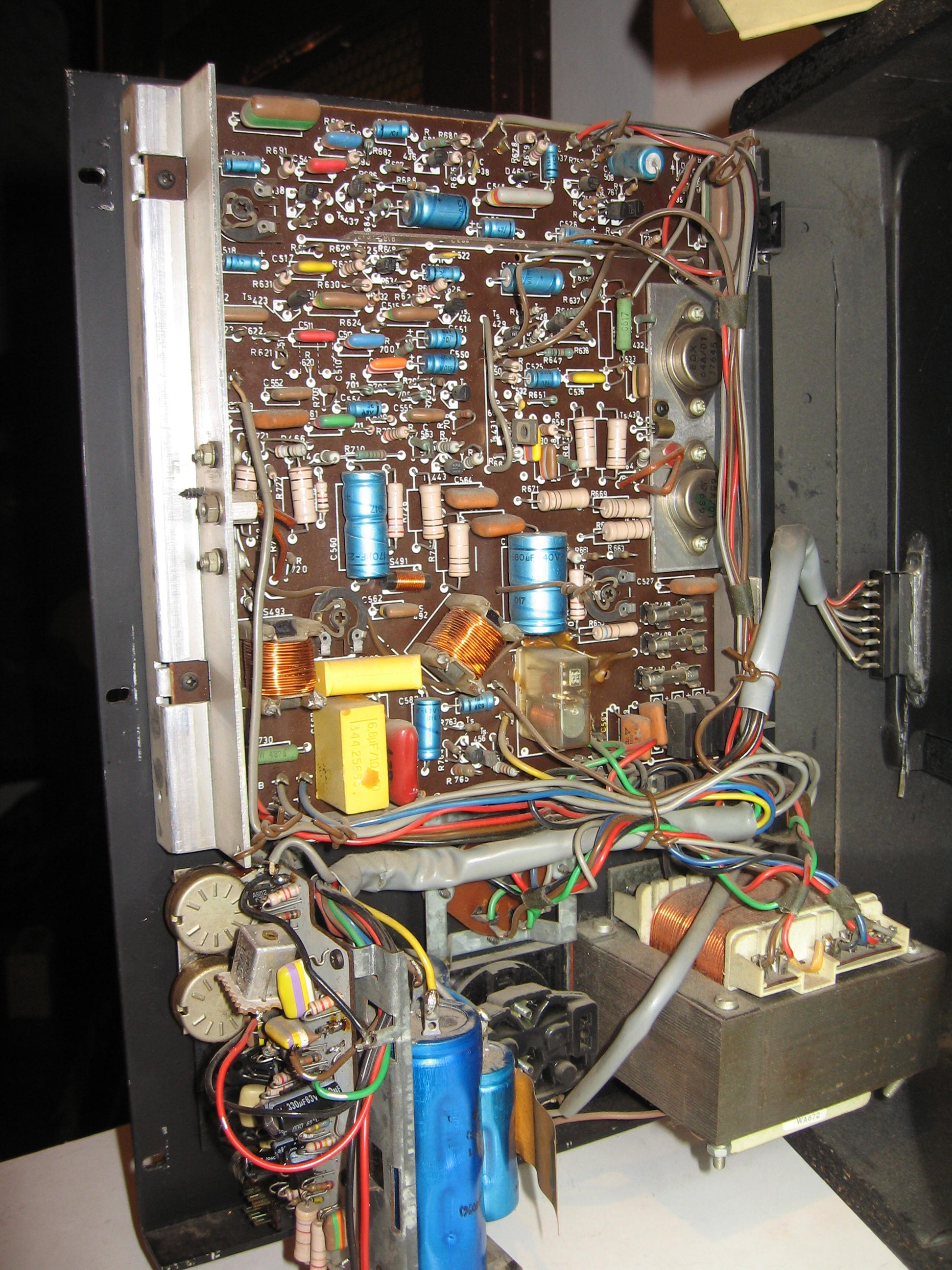

Hi
My job these days is to recap Philips mfb speakers RH544 which are 3 way. It is wery nice sounding speaker, beamped, with passive 2 way for mid n' hi band. Measuring with behringer rta from deq 2496, i got big negative spike-deep in curve (cca 10db), about 80 hz. for bass loudspeaker. This meaning, deq have to compensate this with giving more gain to that region. How to compensate this with some rc filter or something else? Original, not recaped one have same curve shape. Amp for this speaker is with condenser, 6800uF, only for bass, without any filter ...
Another problem (smaller, but) is positive spike-high (cca 6db) about 13 khz, in tweeter region. what to do with that?
Have to say, it is only measurement, speakers sound extraordinary, with deeep, almost stomach moving bass down to 30hz)

4. The Philips speaker connects to a power amp which drives the mid and tweeter but it contains a power amp to work with the accelerometer to drive the woofer. A characteristic of MF (and maybe accelerometer) woofers is indeed their gut-punching tight bass (which is what makes their sound so very attractive as woofers), in addition to the frequency plot.
