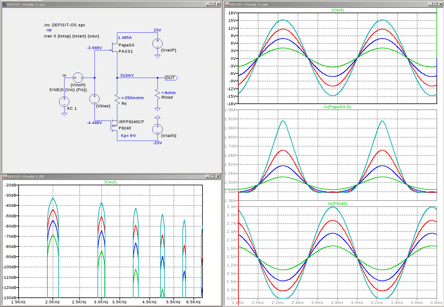

try moving output node somewhere else
didn't tried these tricks with PapaSit , but SUFI-SIT sim (#443) is best arangement I could get , with this brain
I did sims of DEFiSIT , to grasp as much I can , but didn't tried to make it better than it is

why should I try something which is so obviously worse in simulations ?
worse means - pretty much same THD spectra , but worse in level
as you pretty well know , one must have specific level of trust in simulations , not just based on general verity of simulations itself , but also in ability of operator* and , no less important, comparison of sim results with comparable constructions already confirmed in vivo
*which is , in case of Mighty ZM , always questionable

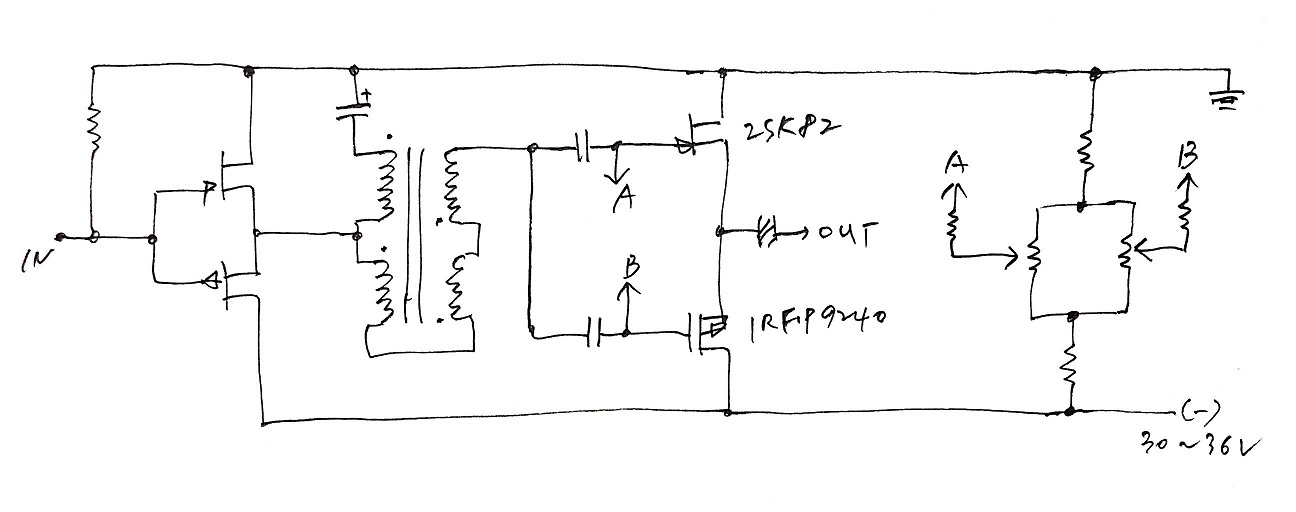

I thought that I can make the circuit from infant idea look more like the real one. Until I am given some easy-to-build circuit this is all I can think of.
By the way, I replaced the big FET from follower circuit with THF51-S and it is much better to my ears. (my only measurement tool..) It just raised my expectation about DEFiSIT. Maybe I should just buy SIT-3.
buy SIT-3 , that good bothfor Papa and for you
that way your measurement equipment will get pretty good reference ..... and you can proceed with fun , building
your cute back-of -napkin schematic is practically same as my SUFI-SIT amp , few posts up (#443) ..........
try to introduce same source resistors and output arrangement , re-bias , then listen
editedit: hope you did heavy filtering in your bias voltage resistance network , to tame ripple coming from negative rail

I saw your circuit #443, I do not understand the role of D1 D2 D3, how you bias upper SIT and low FET, not to mention the function of optocoupler.
Without U3, it is still functional I think, then how you get the bias voltage, why those D1 D2 D3 are back to back?
Maybe someday, a MLTL with 604 coaxial unit. For now, I am trying to get to know this Valencia.
just take source resistors for mosfet and try them
observe where output node is
regarding biasing , there is recently quoted explanation how M2 biasing is working , but can't recall in which thread ...... maybe M2
for your needs , no benefit in complicating it , at least not for now

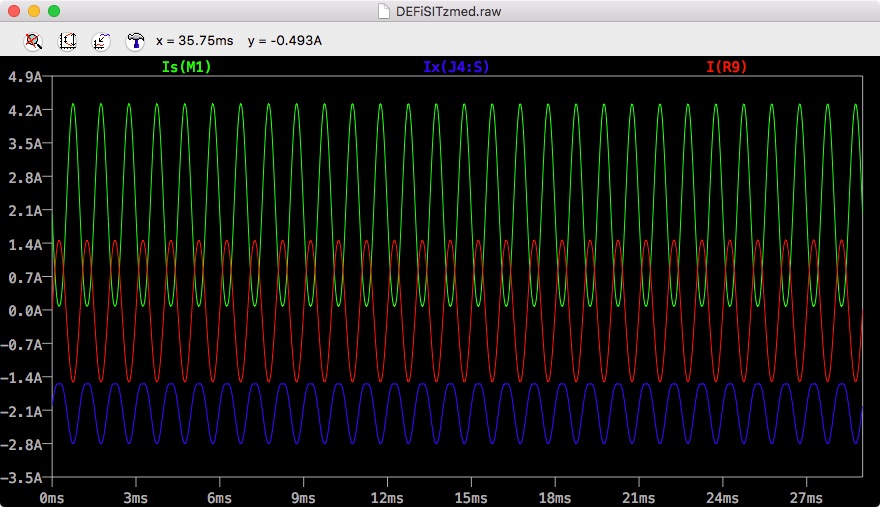

What I do not understand here.....
In my simulation the P channel shows the distortion and the SIT curve is "good"
Also my SIT vurve is the big one and the P channel curve the smaller one,
All vice versa...
No me was vice versa!
and I am just fighting with this effect in Spice. When I go higher with the current to 2A things get better.
Like this at 18W/8Ohm and 2A bias.

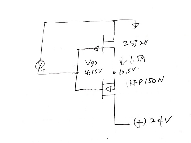

I took some time to wire these and tried. 2SJ28 and IRFP150N giving the voltage below, Vgs 4.19V @1.5A 24V.
But I do not know what the heaven these mean... It looks usable to me, with capacitors before and after the circuit.
Maybe I will wire another channel and see how it sounds.
