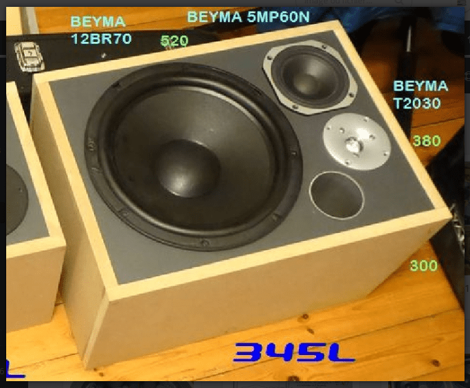

I'm not sure to understand clearly what do you mean by "Euphoric Midrange" (sorry, I'm French ! ) but personally, I tend to prefer larger midrange units - say 7" or 8" diameter - because I find them more able due to their size to reproduce deepness, notably for the male voices, more like a good wide-band speaker do.
Below, on my 375L DIY monitors, the Midrange is a 8" paper-cone BEYMA 8M60N, flanked with a CP21/F in Treble and 12B100R in Bass. Cut-offs are 400Hz and 5kHz, and it sounds mighty fine...
Conversely, the BEYMA 5" polypropylene-cone 5MP60N offers quite poor results in my 345L DIY monitor prototype, in association with a BEYMA T2030 for Treble and 12BR70 for Bass. I tried to vary the Fc, the Xover, but the tone stayed still unsatisfactory...

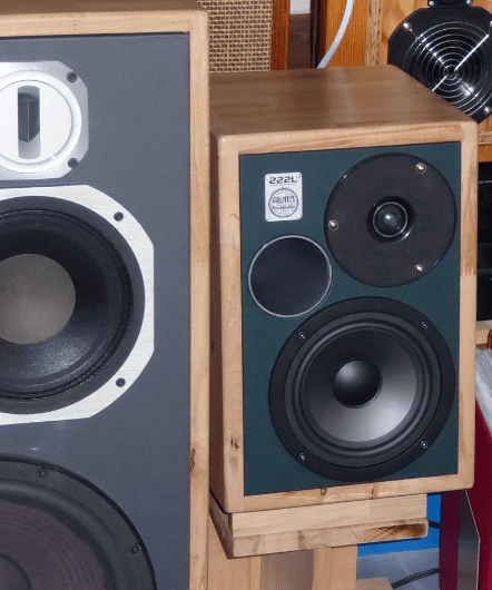

Like you, I'm not fond of polypropylene, but I had nonetheless a good surprise with the MONACOR SPH-170 7" polypropylene-cone mid-bass unit, associated with a MONACOR DT-280 28mm silk dome, with a Fc at 4.5kHz, as used on my 222L DIY monitor...
Yes : polypropylene cones are probably more neutral but also less lively (less Euphoric ? ) than paper cones. This is probably the reason why paper remains the most used material for wide-band speakers...
