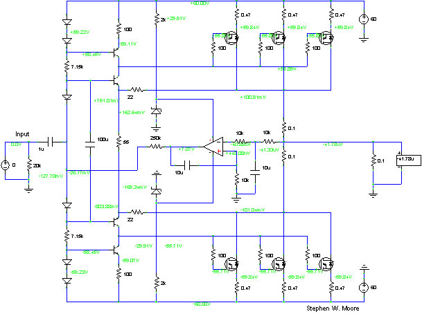

Now with DC servo loop.
The 10uF/10k resistors around the op-amp make a 12dB filter below 1.6Hz. This keeps the DC servo from affecting the audible range. The 250k resistor buffers the op-amp output from the input signal. Those are 30V zeners (bypass and filter caps not shown, although the op-amp has good PSRR) and the op-amp is a high-voltage type (60V plus allowable rail-to-rail).
This is looking good enough to build. Now I need to dig my bipolar +/- PSU out of my junk box. I haven't used it for a while, due to these pesky single-ended Zen designs!

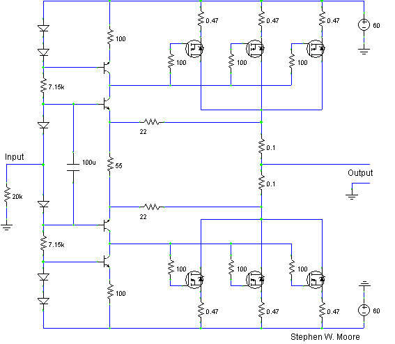

Updated schematics
original moskido schematics with added transistor drivers posted in the first post is not thermally stable. Attached schematics should be ok, but as far I know no one have built it yet.
I have some questions about the new schematics.
How do you adjust bias?
Is the output stage still in unity-gain, or is there additional gain? If there is additional gain can it be changed to unity-gain via adjusting feedback resistors?
Thanks.
