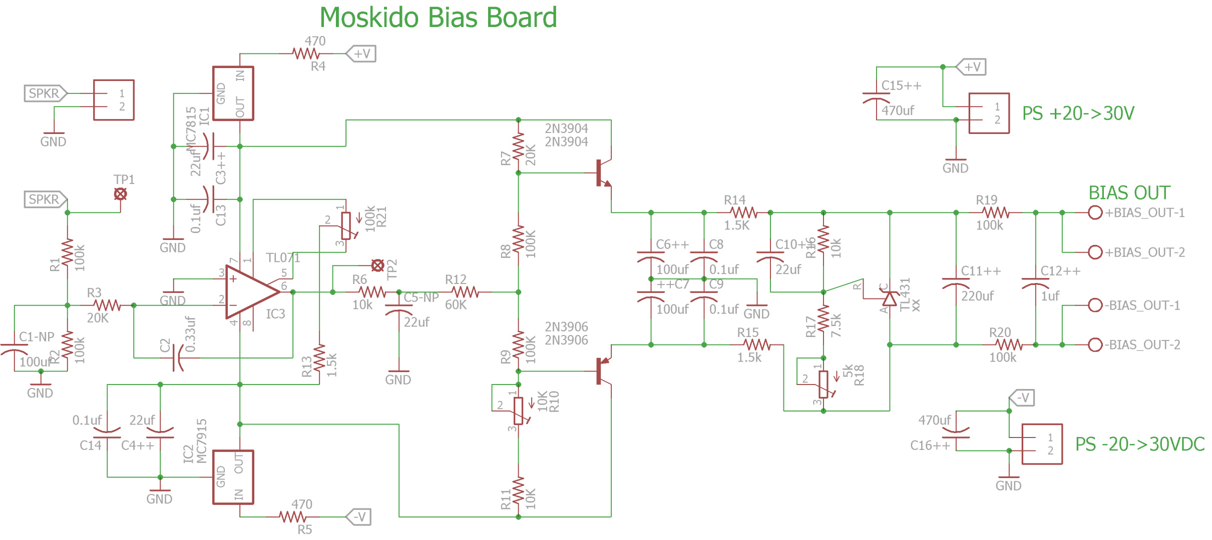

Bias Board Ready

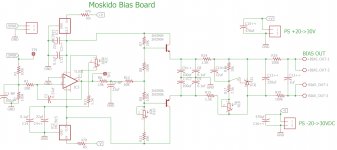

Bias board DC offset correction speed is now good. Component value selection is done. See final Bias schematic below. BOM list being reviewed. Even though I used SMD resistors, the Bias board can be constructed from 100% through-the-hole components.
I used 0.47uf Obligato Gold caps as recommended by Bob Prangnell along with 100K resistors coming from the bias Vreg. Great combination of components with a calculated roll-off frequency of about 3Hz.
The position of a few components on the Bias PCB were moved slightly to obtain better spacing between components. PCB design is done and ready for ordering. I can provide a pair of boards made by OshPark for $45/pair plus shipping. I can also email the Eagle files to anyone interested, however I did create at least one of my own PCB devices.
The sq of my Moskido amps is now slightly better than before I redesigned the Bias circuit. The music appears to flow a bit more freely - and this is before the break-in is complete. The main difference between my Bias circuit and the one on the Mad Scientist Audio web site is that the offset adjustment and servo correction of DC-offset is in the power supply regulation before the TL431 Vreg. This puts less circuitry between the Bias Vreg device and the Mosfet inputs.

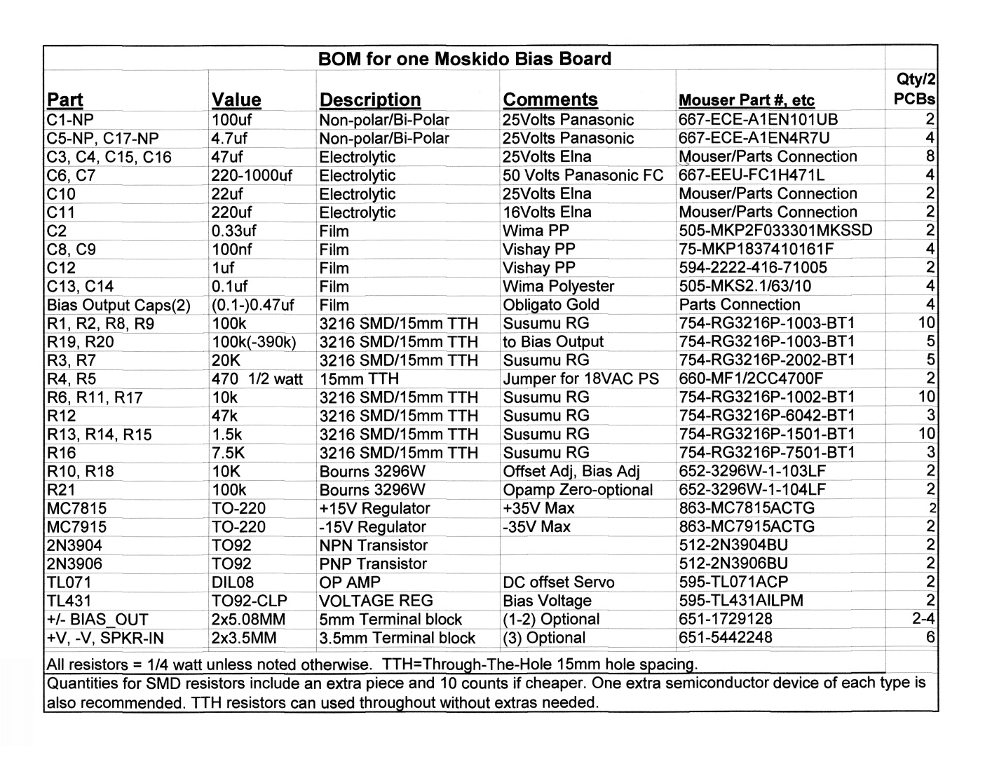

Bias PCB BOM and Intructions
Attached are the BOM and instructions for assembling, testing, and adjusting the Bias board in a MOSKIDO amp

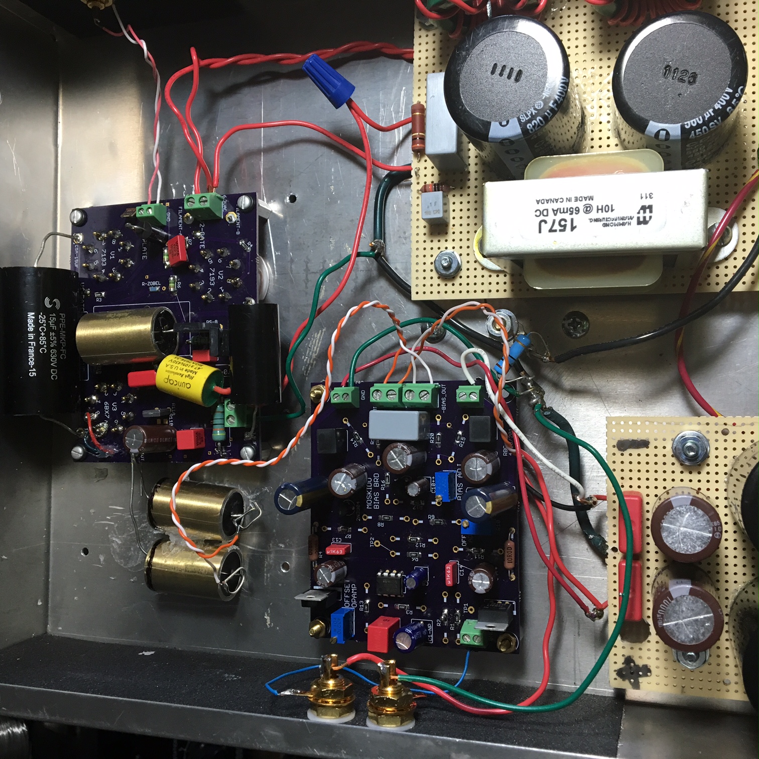

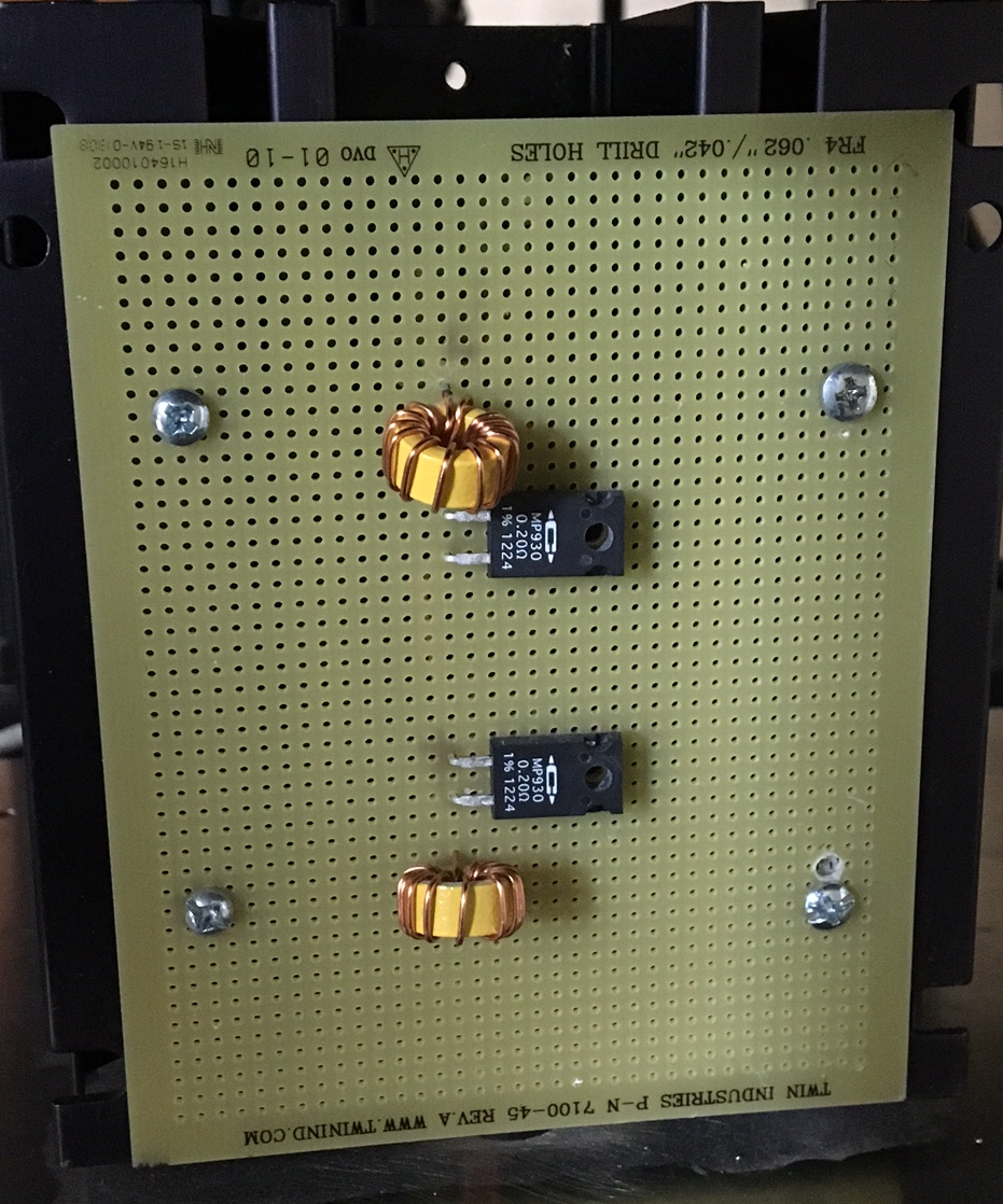

Because kacernator had experienced a lack of detail in his MOSKIDO amp I want to point out other factors that could affect musical detail:
1. I use the recommended 0.47uf coupling caps. Smaller values could weaken the control over the MOSFET gates.
2. OSCILLATION can cause less detail and the hardening of the sound. Oscillation can be detected by measuring the DC voltage drop across the MOSFET gate resistor. If there is no oscillation the voltage will read 0.1mv or less. If there is oscillation the reading can be several mv or more. I put 1uH coil inductors in series with both MOSFET source load resistors which may have helped, but do not seem to have negatively impacted the sq - see picture.
3. Better quality parts matter. Putting all Dale RNxx or PRP caps throughout will result in a pleasantly veiled sound. I use TX2575, Caddock, Takman, and Susumu RG resistors. I also use the Obligato Gold resistor in the push-pull circuit feed to the lower half of the 6BX7 tube.
