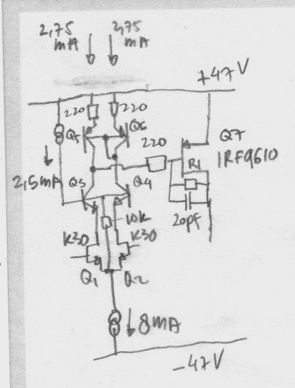

I have a strange problem. I use mosfet (IRF9610) for VAS. The schematic is like below.
The differential is Jfet, K30GR. Each is biased about 2.75mA. The differential is cascoded about 25V by Q3-Q4.
The load is current mirror of Q5-Q6.
This differential is driving VAS mosfet Q7=IRF9610 without source degeneration. Q7 has 220ohm base stopper and 20pF miller cap to advoid local oscilation.
The sound of this is not normal (bad). Later I read in here MikeB wrote that if the configuration is like this (differential has current mirror load on top, and driving mosfet VAS), the gain is infinite at DC, since at DC mosfet don't draw any current, while current mirror is high impedance output (collector-collector).
The sound is like have very much intermodulation.
Later I tried to load the VAS drain with R to ground, not much help.
A help comes when I put R1 (// with miller cap). The value is 220k. The sound is getting better (but not like what I expected).
1. What is happening here?
2. Is Mosfet suitable for VAS? Mosfet has big capacitance, while it always have +/-voltage swing (internal cap varies badly) in the VAS position, VDS varies badly without cascoding. I've seen some commercial amps with mosfet VAS without cascoding, how can they do that?
3. If it is suitable, is it bad if the differential has current mirror load for driving mosfet VAS? Do I need a buffer before mosfet VAS gate or something else?

Hi, Mr. Pass,
The IRF9610 that I use in VAS (common source) appears to be from IRF. You have mentioned about the "flaw" of P mosfets from IRF in several posts, and also in mos.pdf. Charles Hansen also found out about this.
Is the strange sound I hear from the configuration in post #8, could it be because I use Pmosfet from IRF in common source configuration?
Maybe it is not the schematic that is wrong (driving mosfet VAS from input differential pair+current mirror load)?
Like always, it's very late for me to understand what NP wrote :D
He already wrote this long-long time ago, I found out the importance just recently.

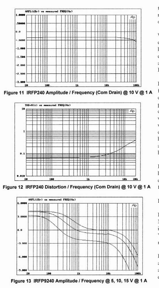

In fig 11 there is a graph of amplitude/frequency for of IRF240. It is quite flat.
In fig 13 there is the same graph for IRF9240 (P channel) from IRF device. This graph is not good, I think, not linear, even in the audio spectrum.
If we compare fig 11 and 13, there must be something wrong with IRF P channel that could not be fixed from outside (elsewhere in the cct).
The question is : how audible is the "imperfection" this IRF P channel? Is it audible (especially in VAS position = common source), or it is not audible (only appears on measurement equipment)?
Charles Hansen also wrote about this IRF P channel :
Hello -
That's exactly the opposite experience to what I've had. Our first power amp (the Ayre V-3) was 100% vertical MOSFETs, including the discrete zero feedback power supply regulators. When we were selecting the devices to use in that design we found a funny thing with all of the International Rectifier P-channel devices we tested.
If you put them on a curve tracer, the forward trace and the return trace did not overlay at all. After running several experiments we found that their transconductance would shift in the first few milliseconds after Vgs was changed. This shift was not small, but on the order of 10% to 20%. You will note that the time constant of this effect put the misbehavior right in the middle of the audio band.
This was behavior was found on every single IR P-channel device we tested, using at least 5 samples each of 5 different part numbers. No other manufacturer's devices exhibited this behavior, including Siliconix, Motorola (now On Semi), Harris (later Infineon and now Fairchild), and at least one other I can't recall now.
The original tests were performed around 10 years ago, in 1992 and 1993. I revisited this issue about 5 years later thinking that IR might have corrected their parts, but there was no difference.
I spoke with the application engineers at IR about this and they refused to help, saying that the parts were designed for switching and not linear applications. However, an apps engineer from a competing manufacturer knew exactly what I was talking about and even knew the mechanism that caused the problem in the IR parts.
As long as we were using vertical MOSFETs, we refused to use the P-channel parts from IR. (Their N-channel parts seemed to be fine, although we only used these in the case of an emergency since they had been so unhelpful on this issue.)
Hope this helps,
Charles Hansen
Ayre Acoustics, Inc.
