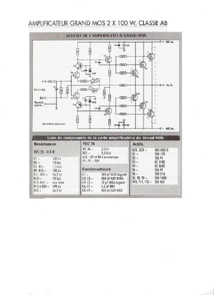

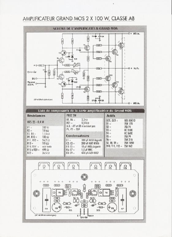

I have no problem with the amplifier circuit , it work outstanding with Exicon type of mosfet . Compare to Renesan Heaven and Earth . I tested in the ProFet amp both lateral.
I purchased these mosfets because Lineup wrote they are lateral so I tought I can use them as a replacement in my next project .
I'm working on the Grand Mos amplifier . I have all the parts even original Hitachi 2SK1058 /2SJ162 . But because I read from these mosfet are so good and they are lateral I purchase them .

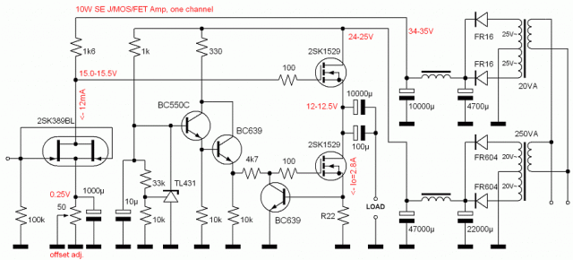

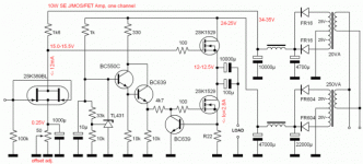

Hi Lineup
What about these 10W SE amplifier you posted at the forum design by Widowmaker . I could use some 2SK1529 in that amp .
Do you have the lay out for the PC board , that is the orig schematic or some parts was replaced ?
If I spent so much money because I read those are lateral mosfet (I purchased 11 pair)at least I could use them some how .
Please let me know
mathelaszlo2@yahoo.ca
Greetings
