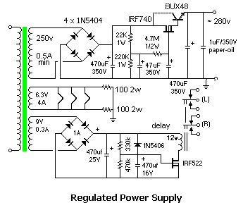

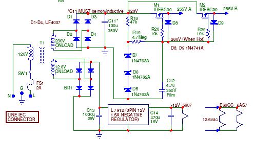

To make a long story short. Electricity companies in Brazil are allowed to float their voltage supply within a +/- 10%, but it's not unusual that it will float even more. For this reason I decided to go to regulated PS for B+ (and for heaters). For the preamp I'm using a ECL82 + zener (sorry Frank) regulator. For the power I wanted to use the schematic below, disponible at the site http://members.tripod.com/richard984/6as7_pp.htm. 255V is what I need for my amp and a "a long time constant on the B+ regulation fets" comes in handy. The designed PS delivers something between 250mA and 300mA (for both channels), while mine will have to deliver around 100mA (each monoblock).
The questions: is it possible to change the IRFBG30 (1000V / 3.1A 5R 125W) for a IRFBE30 ( 800V / 4.1A / 125W)? I’m no expert at mosfet’s, but it seems that the IRFBE30 would be sufficient (voltage and current wise).
Richard says that the cap (C11 in the schematic) in front of the regulators must be a non inductive one so the output resistance of the PS keeps low. I was thinking about using 60muF of motor start caps...are those non inductive?

The regulator with the mosfet is the same style ,that Tehcnics call virtual batery operation.
As the gate of the Mosfet draws no current it is possible to use a very high value of resistor for polarisation...4,7 M .... and because of that ,to have a very good rejection of supply noise.

Yesterday I concluded the regulated PS using the IRFBE30. Richard Sears, who designed it, says it has a "long time constant on the B+ regulation fets". Well, it really have. After 30 minutes drawing about 50mA of the B+ it had arrived at 130VDC of the 255VDC.
How could I decrease this time? Or shall there be something else going wrong?

What COULD happen is that the cap has a slight leakage current. Also, the zeners normally take more than a mA before coming to their advertised voltage. it may well be that at the very small current available from the 4.7 meg they take all that current before coming up to voltage. Any of those two tings (and probably a few others) could explain the long charging time. Try with 470k instaed of 4.7meg. If that works, you know the causes. And with 470k you still have massive noise and ripple attenuation.

I solved the problem...measured voltage after the 4M7 resistor and that was raising to low due to... 44muF of capacitance. Changed this for 3 muF film capacitors and now the circuit is working fine.
