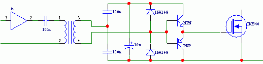

here is one transformer coupled driver that restores DC level, so drive level is independent of duty cycle. It does not like sudden changes of duty cycle, which is true of all transformer coupled gate drivers (excluding drivers using pulse transformers that differentiate control signal). Because of emiter follower output it works even when primary is driven by 6 paralleled AC04 inverters.
Best regards,
Jaka Racman

yep, pulse x-formers can be tricky. But you could use one, then you
wont need to get a driver with level shift. However a single supply
driver will need ac coupling cap on the primary just like Jaka showed.
With 400k switching the core can be quite small, but make sure
that the volt-second product stays within limits.
Also be carefull when using IC drivers at those frequencies together
with large die FETs. I know they tend to get pretty warm at even
50k.
That is not only due to the load but also internal crossconduction
in the output satage of the IC.
/ Mattias
