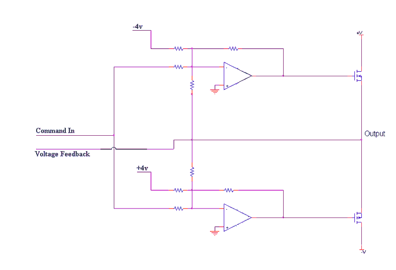

Suppose a MOSFET output stage uses an IRFP240 and IRFP9240 for the output devices in class AB setup. There is approx. 4 volts needed from gate to source to bias the devices. In addtion to that you need your command signal to command different levels of current through the FET. Since, the gate voltage needed to get current through the FET is referenced to the Source of the device (Vgs), really your AC command signal to the power stage must be referenced to the OUTPUT of the the P-channel/N-channel output pair, not to ground
So, My question is, what is the easiest way of referencing a signal to the output of the amp and not Ground? Is it possible to use a Power OP amp such as the LM3886 for easy gate drive? I have attached a simplfied schematic of a possible gate drive with the LM3886. I have left out stability components for clarity. This circuit uses two power op-amps; one for each gate. The op-amps are in a basic summing confuration. The command signal is summed with a gate bias offset voltage (its the opposite polarity because the summer circuit will invert). THe output voltage is summed back in with the bias voltage and the command. THis way the gate voltage will always be above the output voltage by the bias voltage plus the command signal. The Voltage feedback from the output could also then be fed back into an LTP or other input circuit for the global feedback.
Is this circuit too absurd? My background is in embedded software and this is my first attempt at a power amp. This seemed to make sense to me. Some of the descrete circuits I saw seemed very complex. If anyone has a good website on linear FET drive please give me a link.
My second question. Even though most people claim that the IRFP240 and IRFP9240 are a matched pair, this to me seems like a stretch of the truth. I notice that they both have different values for transconductance(4.2siemens and 6.9 siemens). In a class AB configuration wont the mis-matched Transconductances cause an assymetrical output?? I know negative feedback can compensate for this but is there a simple way to get rid of this problem before global negative feedback is applied?

If you reference the drive signal(s) to the output node, you'll be operating the IRFP240/9240 as a transconductance stage rather than as a follower. You could do it, but that's different from what's generally described in DIY articles using these MOSFETs.
The usual way to operate the output stage as a follower is to reference the drive signal to ground, rather than to the output. This means that the drive signal has to swing as least as much voltage as the expected output signal, and usually several volts more than that.
Also, when using IR type MOSFETs, the +/-4V bias is most often derived from an adjustable temperature compensated bias voltage source (e.g. another IR type MOSFET) tied across the gates of the output pair.

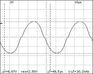

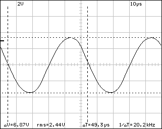

The irf240/9240 are not identical just as u stated,the transconductance is different as well as the input capacitance. I've used them in out stages without loop NFB and had to use two P-devices(irf9240) and one N-device(irf240) which basically gave me two complementary devices(treat two irf9240s as one 240). I don't use drive stages, and the bias at the gainstage is 14mA, and the amp is flat to about 50kHz.

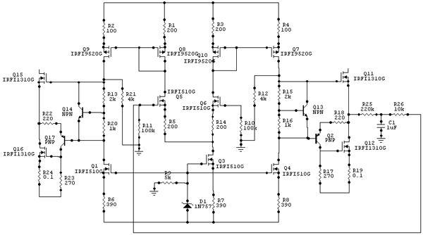

Because of the differences in N-devices and P-devices, I've designed output stages which only uses N-devices, and with two irf240s I get flat responses to about 150kHz, and about 50watts of power(without loop NFB). I use this in a balanced setup, or bridge if u prefer, and get about 150watts with four N-devices total.

btw: I have scope pics of the output stage using one each n and p-device, and using one n-device and two p-devices, which shows the difference it makes. How can i post them here?

the stages are biased low, both at only a few mA, and no loop NFB is used. The load is an 8ohm pwr resistor. The pic of the stage using one each devices looks simply like it's biased too low, and we see the x-over distortion, which actually is the case, but the 'two P- one N-device' stage is biased just as low, and tho it too has high distortion, it surely demonstrates the difference it makes when the N- and P-devices are more equal in transconductance. Both stages sound very well when the bias is set above 100mA even without loop NFB.
Nick,
I'd be interested in details of your 50W N-MOS bridge setup if you care to share them. If you have a lot to say, and think if would be of general interest, you can always start a new thread on the topic. ;)
okey
Here's a ruff version, meaning some values are modded slightly. The feedback network R25,R26, and C1 are for DC offset only, signal wise the amp is zero-loop NFB. The DC NFB network is also at other output(both), but I only have the demo version of this circuit CAD so ran out of available parts allowed.
R16 and R20 are pots, so bias is eaier to adjust.
The input stage has about 10volts higher rails than output. I've also done it with bipolars in the CCS and mirrors, haven't decided which I prefer yet.
The gain as shown is about 30dB into 8ohms.
Sounds great with 100mA bias.
I'll probably include this with PCB layout on my website soon.
Regards, Nick

Nick, thanks for posting the schematic. About your output stage, it looks like the upper MOSFET(s) might be set up to act like a partial CCS at low output currents, then transition to (quasi) complementary behavior at higher levels. Is that how it works out in practice? I've modeled some circuits that work that way, but never actually built any. In any case, I definitely think you should add this one to your web site when you get the time.
