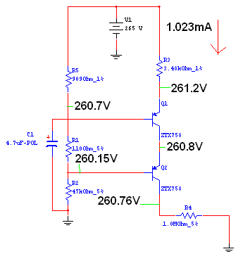

Ok, i have made a cascode using bipolars to source ideally 1.1mA as a 12AX7 load.
It will be working into about 1Mohm.
It simulated ok i have attached the picture with the measurements on.
I have thought of a problem though, the Mcintosh amp was designed to put about 170V onto the tubes' plate, with this cascode i seem to get 260V across my 1M load?
Will this work (i am still studying electronics and havn't done this before)?

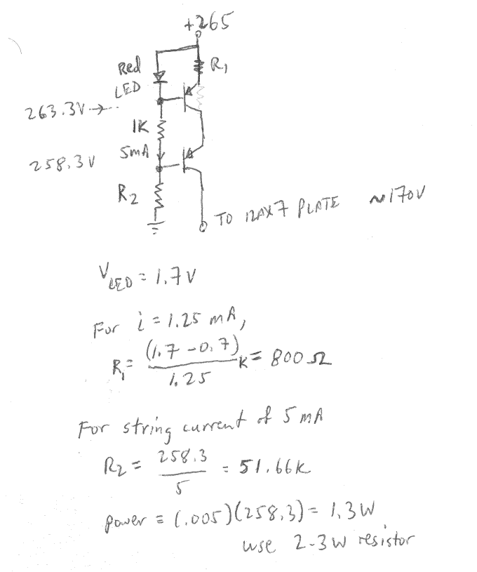

Here's a sketch for a 1.25mA ccs suitable for your preamp. If you want to drop it to 1mA, change R1 to 1K. The reference string is set to pass 5mA through the LED voltage reference, which lowers its noise and impedance. You might want to bypass the LED with a cap- 470uF at 16V will be more than adequate.
The reference string can feed more than one ccs- if you're doing two, for example, all you need is a second pair of transistors and another R1. R2 should have a 2W rating; higher is better and wirewound will work fine. R2's value is not critical- a 47K will be just fine, as will a 51K.
Depending on your power supply, you might have to diddle the value of any series resistors to account for the extra 5mA of current burned up in the reference string. On the bright side, the LED gives a nice visual confirmation that the power supply is working. And if your supply drops under the additional 5mA, that will still be OK as long as the supply is 15 volts or more higher than the tube's plate voltage.
The transistor closest to the B+ rail does not need a high voltage rating- get a small signal PNP with a high hfe and ft. It's not critical. The transistor connected to the 12AX7 plate needs to have at least a 300V rating. If its power dissipation is about 1W or higher, it will be fine without a heatsink. As before, the particular type is not critical- use what's easy to find.

The 470uF cap just goes in parallel with the LED reference, not the whole string. It will not degrade your supply or PSRR or anything else. All it will do is make sure that the dynamic impedance of the LED is nice and low.
No need to fool around with the bias string or any other complications- the ccs will work beautifully as-is. It does look too simple, but believe me, it will do the job. The 1M resistor in the next stage will be the limit to how high the load impedance can go (it's effectively in parallel with the ccs at AC).

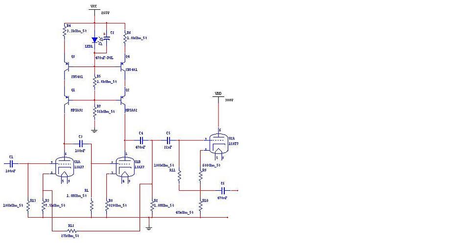

Here is my circuit:

OK, it looks like the open loop gain is about 10,000, which will be an interesting exercise to try to stabilize. If I had to guess, you've got some motorboating or oscillation going on. Just for giggles, drop the coupling cap (looks like C3) by a factor of ten. The value is a bit small for me to read, but if it's 100nF, substitute a 10nF.
Second thing to do is to add some lead compensation. For experiment, stick 100pF across the feedback resistor (R12?). If you've got high frequency oscillation from the high feedback factor (like 60+dB!), that may calm it down a bit.
