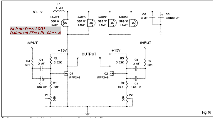

Hammond ... hmm, yeah
When looking for good Chokes for SolidState power amplifiers
we could turn to Tube Valve stuff. They know these things.
But is far from impossible to build your own good COILS
for Inductive loaded Class A amp output stages.
For example Nelson Pass is good with inductor construction.
His ZEN Lite uses a lamp light BULB as load for Class A.
Light bulbs are somewhat inductive ...
Zen Variations - Part 1: Zen-lightenment by Nelson Pass
(c) 2001, Nelson Pass
http://www.passdiy.com/pdf/zenlite.pdf
Attachment shows a more advanced variant:
Balanced Zen Lite with four 300 Watt Light Bulbs

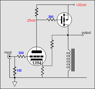

There is the ZV7 with choke loading.
Tyimo
Sorry, but is it not a good example, because He used the bulbs as resistive loads.His ZEN Lite uses a lamp light BULB as load for Class A.
Tyimo

Hi Tyimo.
Yes, you are right.
I wrote in my post ... light bulbs are somewhat inductive.
Nelson Pass in his article ( the Zen Lite PDF )
discusses several ways, loads for Class A single end outputs:
... like constant current source, resistor etc.
This is valid reading if you are considering alternative ways of doing SE Class A.

For a single mosfet SE amp, as the original Zen from www.Passdiy.com , the magic number for the inductor is around 80mH.
