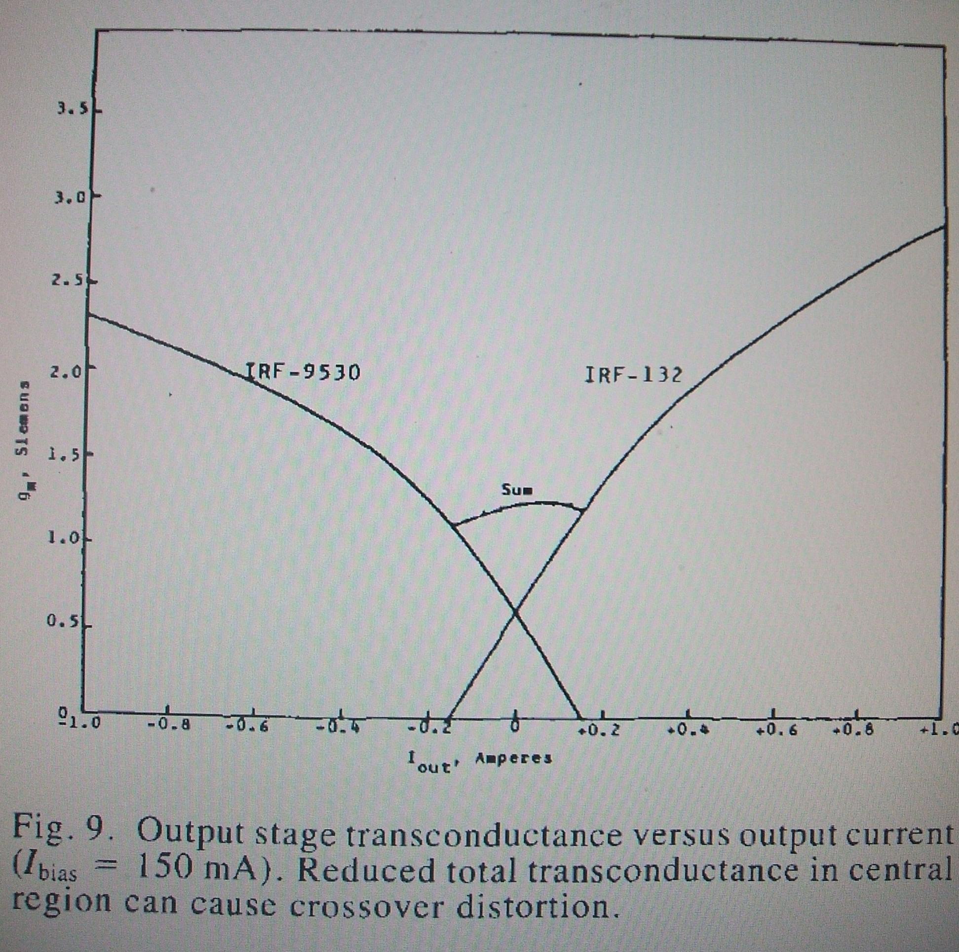

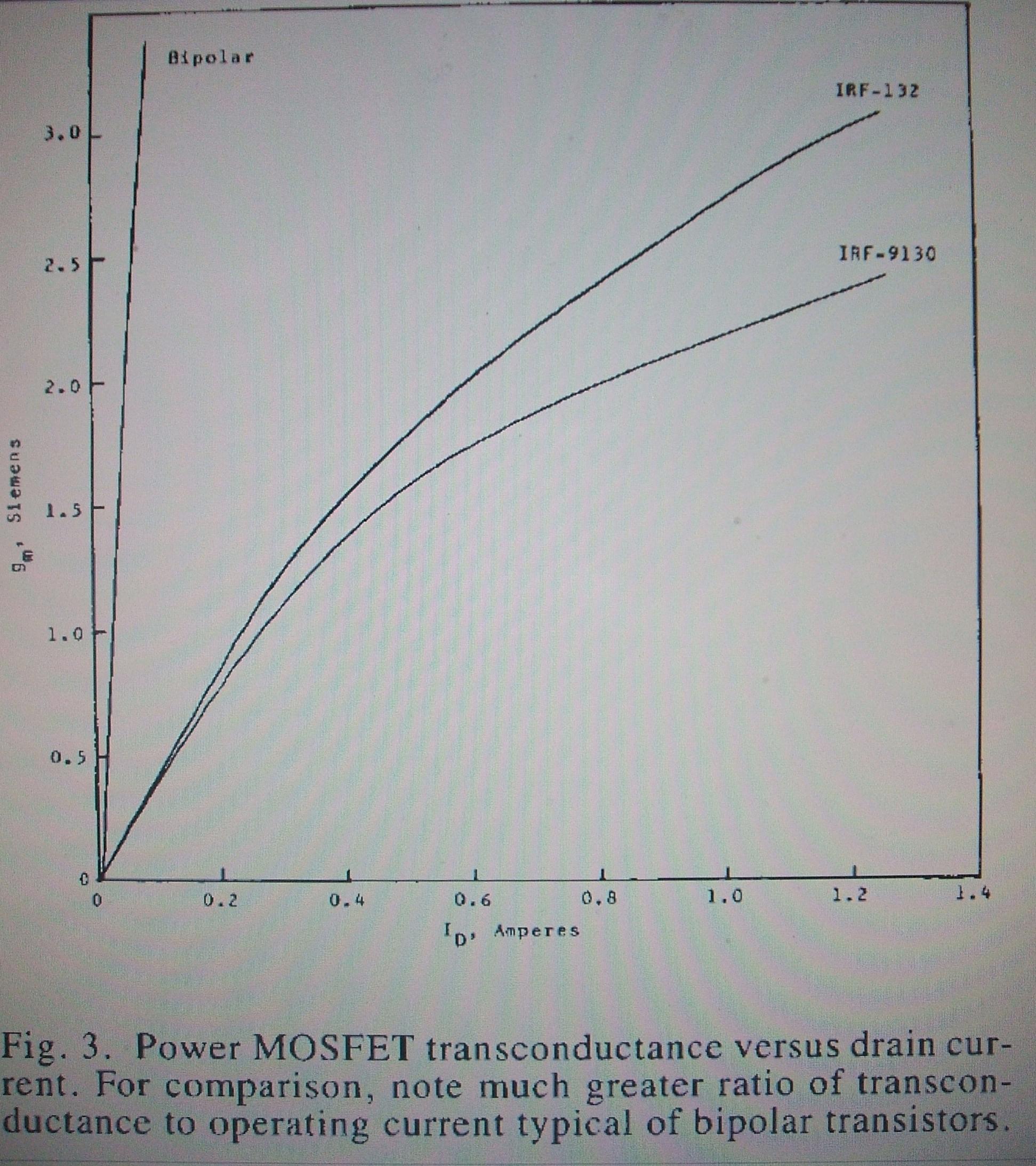

Logically speaking, for every distortion created and fed back, the input stage must create an anti-distortion signal to the output, which is then amplified by the VAS and drivers. Crossover distortion creates very high frequency components because of the steep slope of the output signal related to it. It is well worth the effort to keep this distortion as small as possible at the output stage. (This also means with vertical fets a bias of couple hundred mA to prevent the load line from venturing into the 'transconductance drop zone' as I call it, the area close to cutoff where Gm drops significantly wrt Id. see below) The high frequency garbage related to crossover is well above the BW limit of the global loop and are not canceled. The BW is limited by propagation delay and phase margin of the global loop, delay between the FB signal and the input reference. Using local loops can create a more linear system presented to the global loop requiring less compensation and increasing the overall frequency that the amp can amplify and still be unconditionally stable.
1st graph shows Gm vs Id(c) comparison of FET to BJT. Notice the constant steep slope of the line for BJT. 2nd is class AB and crossover area of Gm vs Id. As you can see, biasing FETs as if they are BJT's with 25mA or so will leave a 'hole' in transconductance through the current crossover operating region resulting in crossover distortion.
[graph ref. Mr Cordell's EC mosfet paper.]

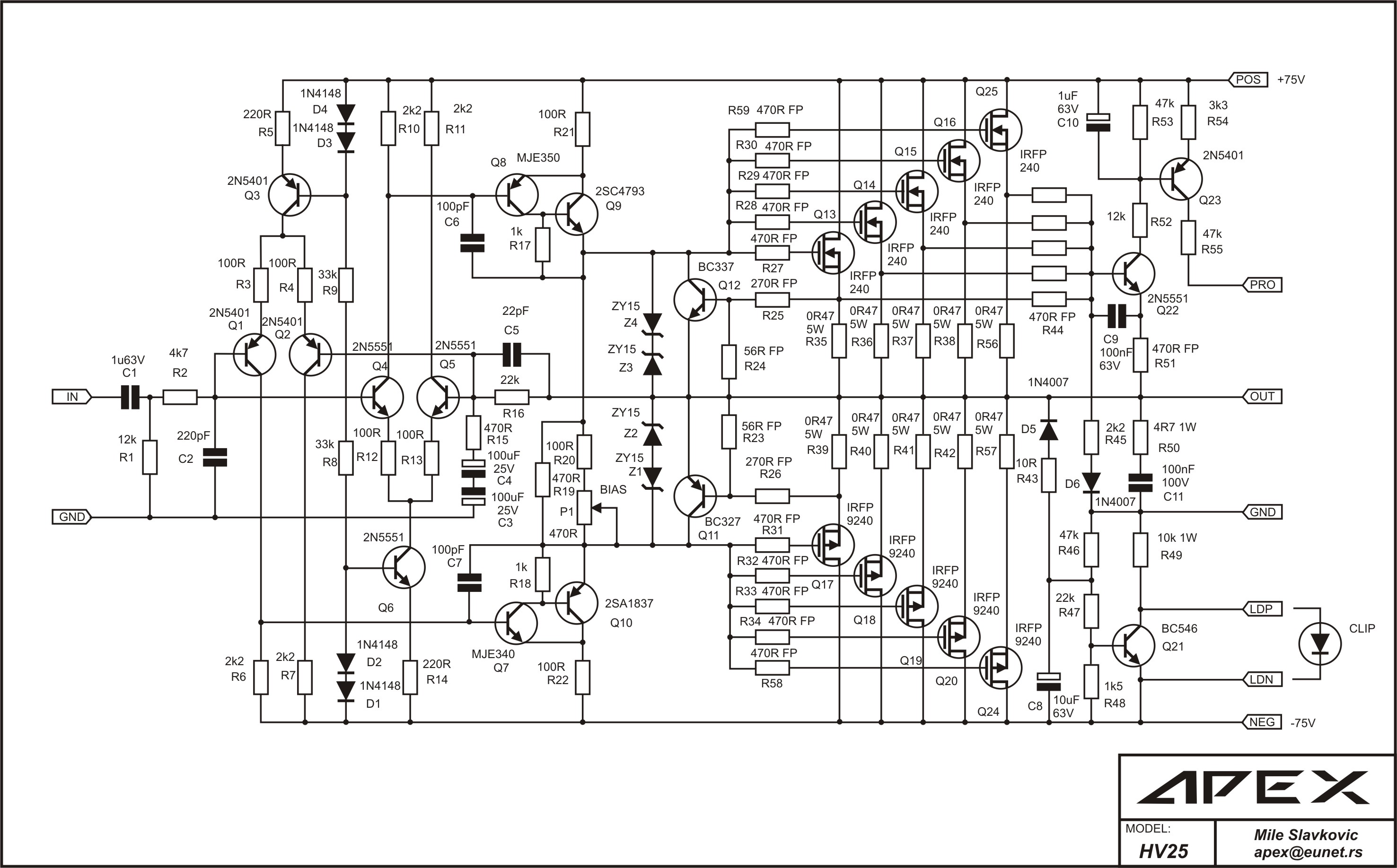

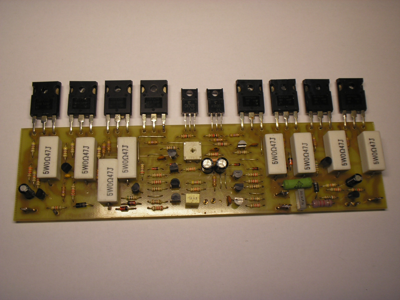

Q9 and Q10 run with 30mA, bias of the output tranzistor 200mA set by P1, and bias stay stabil. Maybie must corect after few minutes but that will be small corection.
I must repeat, outputs not run with 25mA or 30mA, it's biased with 100mA (200mA with large heatsinks) per mosfet. VAS transistors current is 30mA and it's must be on main heatsink with outputs.
