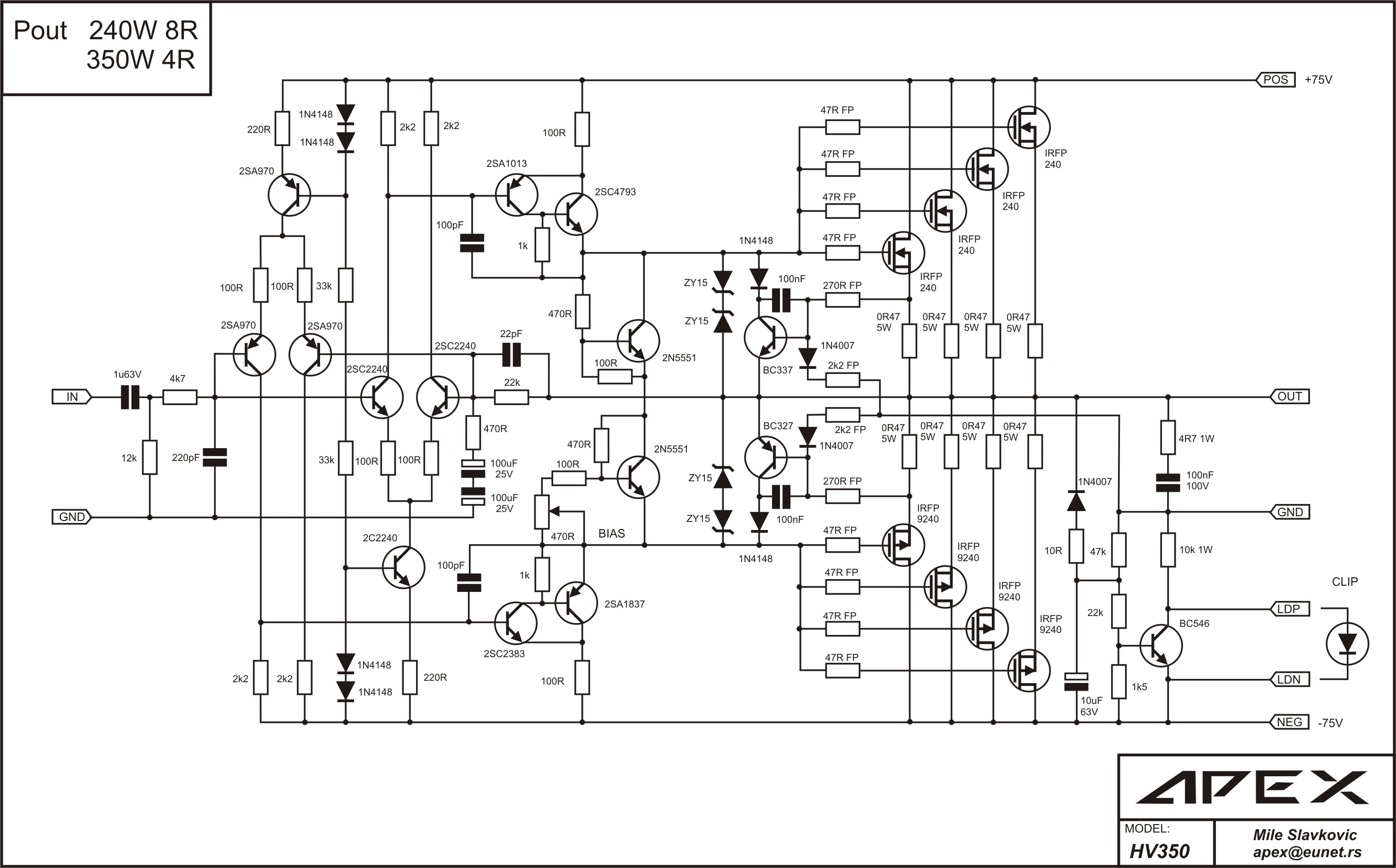

MOSFET Amplifier IRFP240/IRFP9240

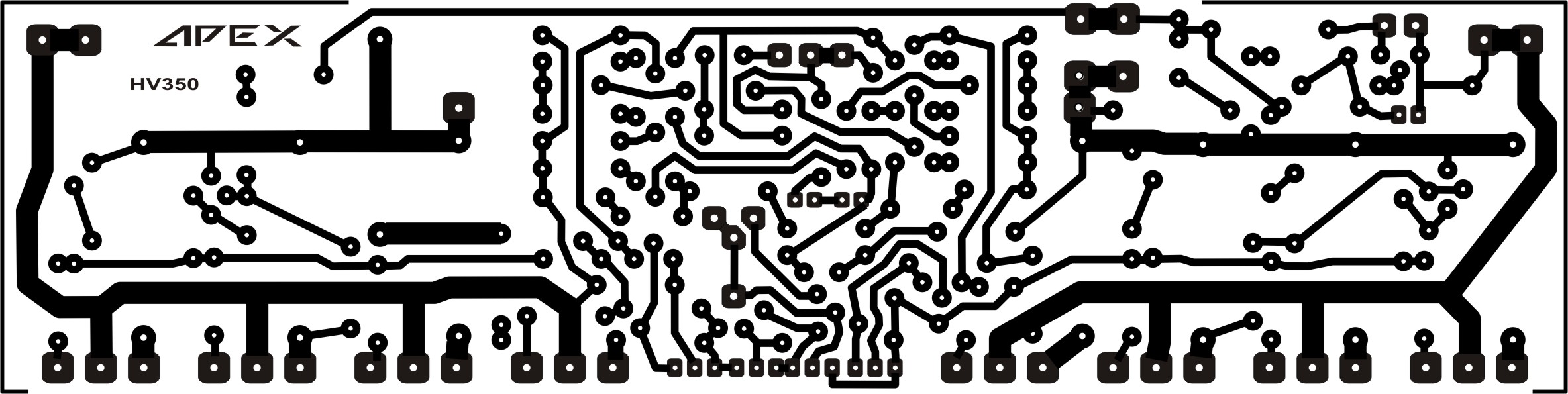

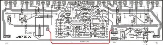

Hv350
HV350 Pcb size: 200x50mm
