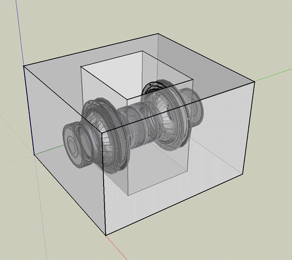

Need a new coffee table? Slap a nice wooden (or glass) spaced top on this and some legs...

Interesting double isobarik. I like it.
Is this just a concept sketch, or can you provide the dimensions and identify the drivers?
Doug
Push-push-pushpull isobarik.
It is just a concept.
There are some assembly challenges. I haven't actually figured that out. For optimum driver coupling the central tunnel would need to be a removable object. Or you could slice it down the middle (verticaly) into 2 C-sections and then bolt those together. Either way you'd have to have the bottom removable.
And getting cables to it could be a challenge if actually a coffee table in the middle of the room (drilling a hole thru from the basement would limit placement).
Originally concieved for some vintage Foster 12" woofers that i have 20+ instances of. Net volume would need to be on the order of 1.5-2.5ft^3. For these woofers the box would be aperiodic.
