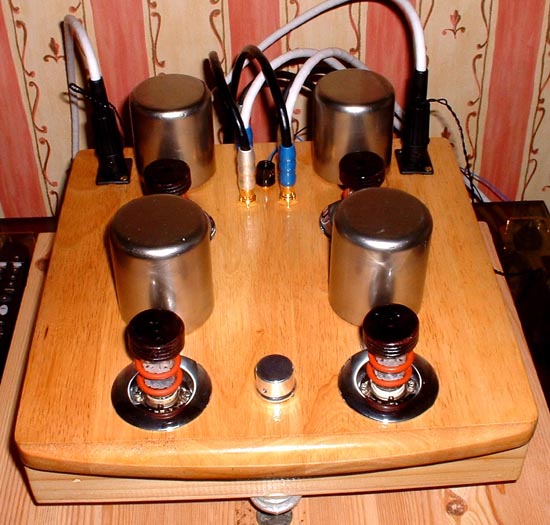

Ooooooohh, mom's gonna have a fit when she finds out you used her new cutting board to make your preamp.
Yeah but not as big a fit as if KYW's girlfriend uses the preamp as a cutting board
Koinichiwa,
The board is not from Mom but from Woolworth. It's a "Chesse & Bisquit" Board, not a cutting board. The little ceramic tile that was sitting in the middle to place chesse upon makes a good little damping weight on top of my DVD Player (waste not want not).
And if I ever really get of Vinyl I can use the thing to serve cheese & bisquites...
All this wood actually is C37 lacquered and was applied because of the C37 principles....
SayonaraDieter Ennemosers C37 Theory and C37 lackquer
Steve Eddy said:Ooooooohh, mom's gonna have a fit when she finds out you used her new cutting board to make your preamp.
Kuei Yang Wang said:All this wood actually is C37 lacquered and was applied because of the C37 principles....
And powered by an over-unity generator too I suppose?
Add one of those cheapo wooden cutlery draws for a base, some more C37, and there's no reason not to have a nice (low cost) housing!
KYW, you're a man after my own heart!

Nick,
Cutery bases, good idea. I used simple wooden pieces from Homebase that had the right size and where part of some shelf mounting kit. The cost was something like 3 damp Squid. The metal rings on Valve bases BTW are Downlighters for these 12V Dicroic Lamps from the local electrical wholeseller in Edmonton.
BTW, the cost of the Housing pales when you consider the S&B MC Stepups, S&B LCR RIAA EQ's, loads of Chokes and so on. Even "with a little help from my friends" (like Stephen Robinson who sold me all the Ansar Cap's for 100 Squid, Jonathan Billington who wound me the transformers and RIAA for a "nice price", Jon Finlayson who allowed me the use of his Woodworkshop to machine the top board and who cut the Mitres for the Base plus the peopel at Criclewood Electronics, Maplin and RS) the total cost of this Phonostage is quite frightening.
Paying retail for everything would be more so....
Sayonara

All XLR's are Plastic, with hard silverplating over brass. I wish I could have XLR's in wood and with solid silver contact.
