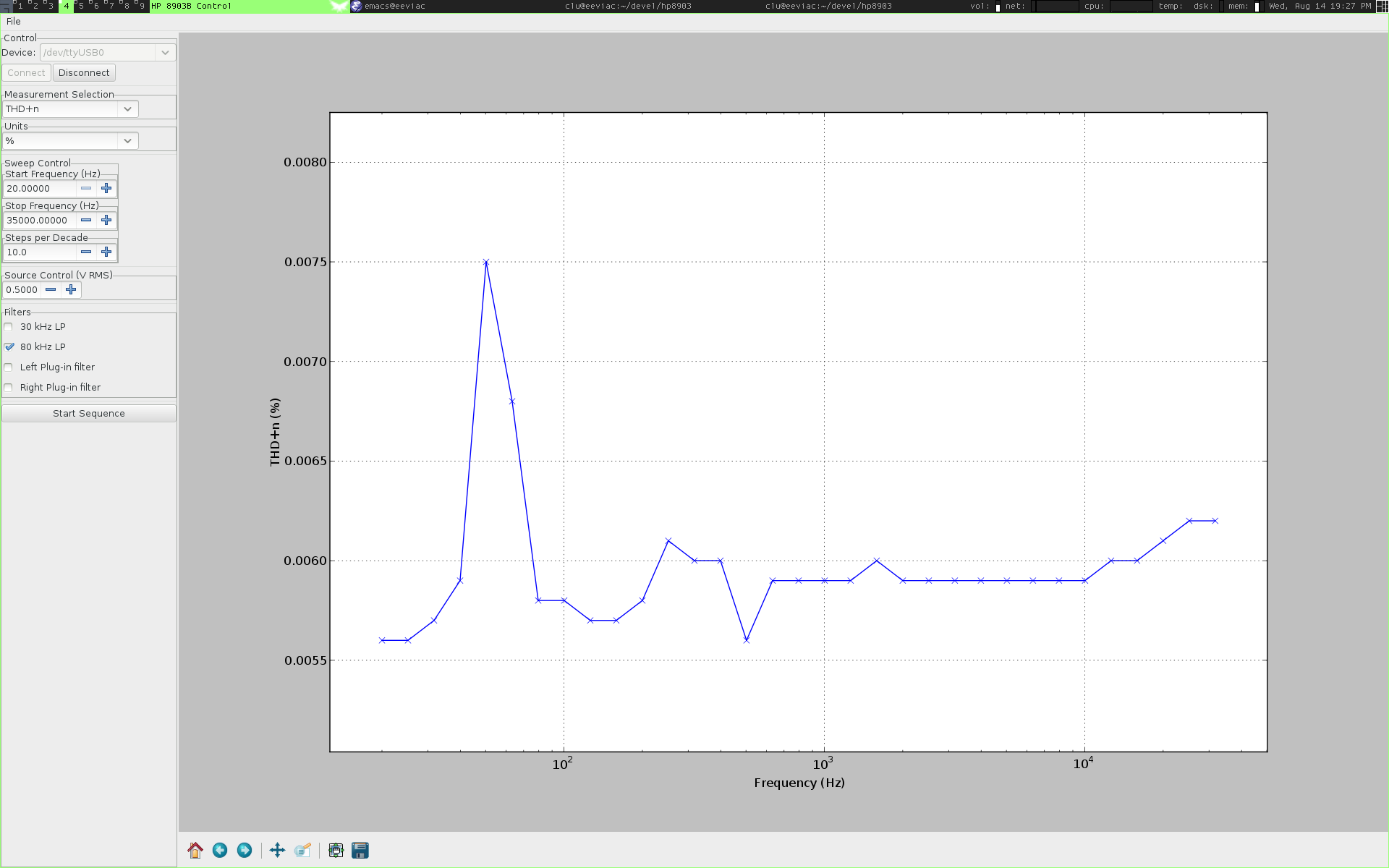

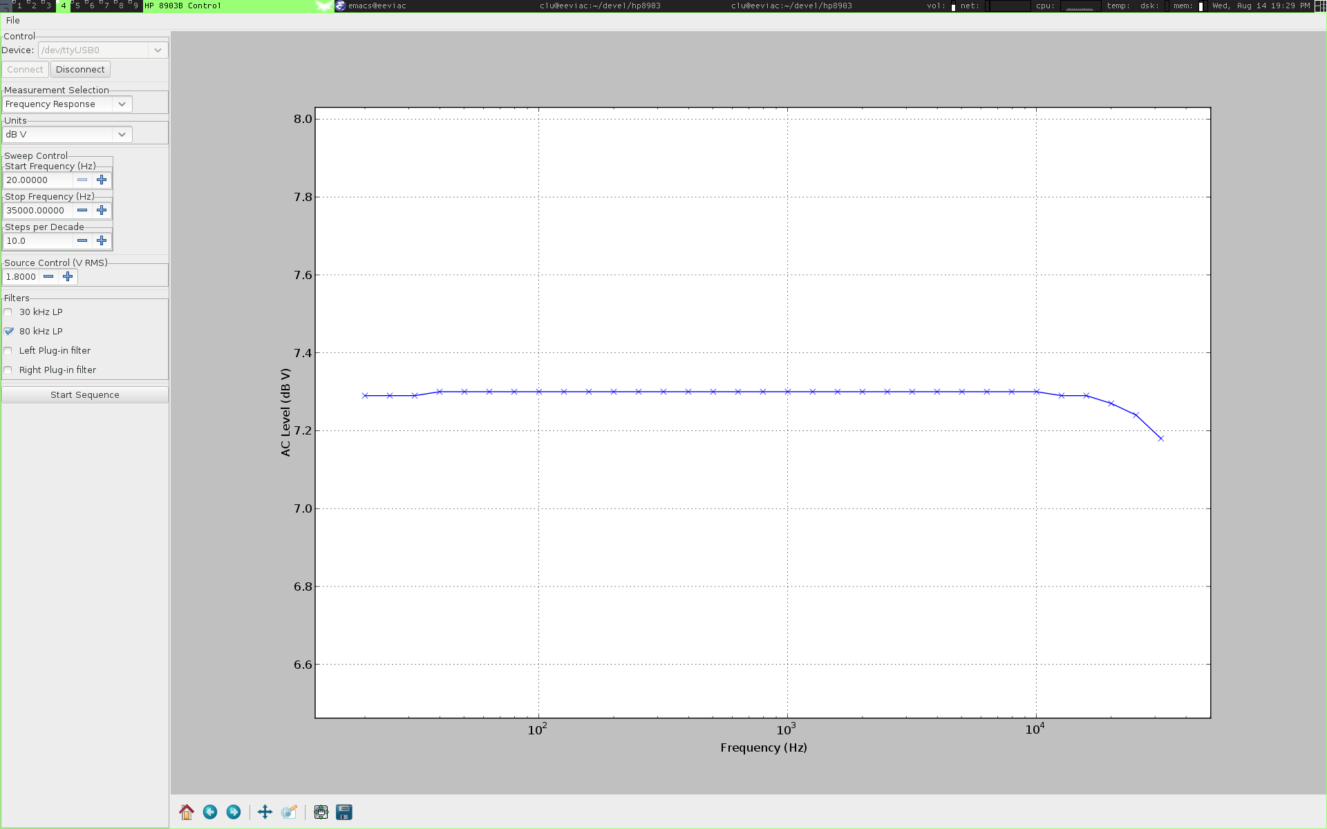

Had a chance to take some screenshots too -- Don't have an amp on the bench at the moment so they are boring shots of the HP 8903 output connected to input. But at least it shows the GUI (which still needs some work).
