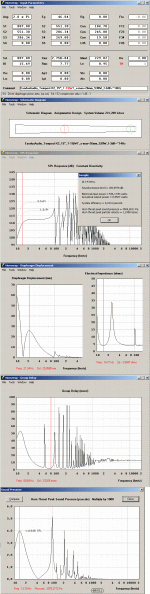

But, consider the Alpha 15 in a regular box instead of just in OB. Get the best possible alignment in a box simulator and then use EQ to get the rest of the way there. Then, it just becomes a matter of feeding the box enough power to hit the displacement-limited SPL (that is, if the drivers can handle it - which they probably can). I'll play around with some curves tonight.
Unfortunately, EQ won't increase displacement limited output, all you can do is knock down the peaks where the driver makes lots of output.Don't worry about it.
In the case of the Alpha 15, you are stuck with only around 100 dB in the 40 Hz range in a BR at Xmax, and that whimpy motor won't push a TH.
Sure, but that's the crux of the argument. Bass is limited by displacement only, all else equal.Unfortunately, EQ won't increase displacement limited output
As for not being able to push a TH, well, I've haven't looked at that. I recall being able to get decent results from a Beta-12A-2 sim, though.
