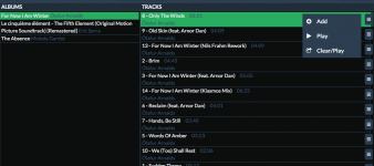

I've just installed TR2 on my RPi Zero with pHat DAC.
Everything works without issues except 3 things (see attached screen):
1. the tracks are in the wrong order (these don't seem to be sorted by the track nr in the metadata)
2. How do I add more tracks at one to the play list? In the TR1 version I could select add/replace all. Now, these options are gone.
3. I'm not sure if you had a chance to look at the bug in the artist list (the last 2 names are under the "Browse" button).
p.s. if you're thinking about the local languages support (as saw somewhere) - I can help with Polish, which is my native language.
update: item nr 1 seems to resolve by itself - refreshed the list after some time and the tracks were in the right order.
Thanks!
Marek

Hi Marek,
(1) I've been clicking through my giant test collection and I'm not able to repro the odd track order that you are seeing. I see the different numbering types below, all sorted ascending:
1/20, 2/20... or 1, 2... or 01, 02...
I'm thinking the weird sort is due to something in the track# tag in the files.
(2) Click on the cover art and u will get a menu with Add, Play and Clear/Play. These apply to whole Album or if u click on Genre or Artist then applies to that part of the collection.
(3) Artist list issue is bug. I'll investigate.
Tim

That one resolved by itself after some time (in mean time I've been rebuilding my library - so possibly that was the rootcause.
Ha! That's clever! Indeed, it works as you say. Thanks! :)
Tim
Thanks again! :)
Marek
