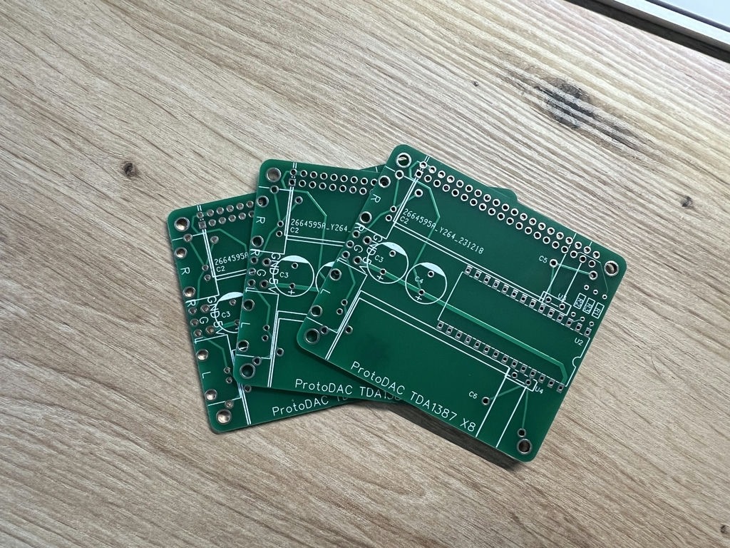

Hi all,
i have some pcbs from moode mudio ProtoDAC left (I think it is RevB).
If you are interested please send me a message, sorry no UK (too much customs formalities / shipping costs)
