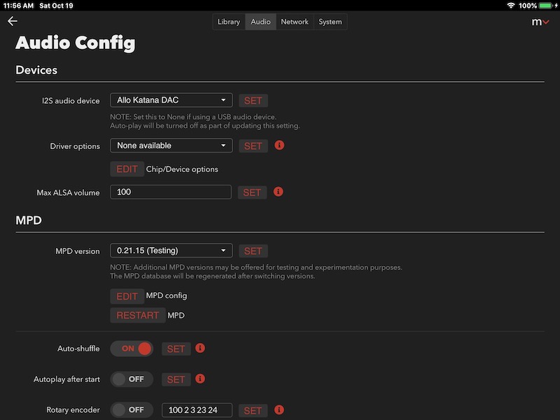

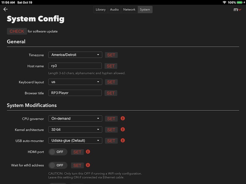

For my SIG + Katana (SQ output board, no Isolator board) I use a configuration like below. it's mostly just the default moOde OOB settings except that I typically run the latest 0.21.y series of MPD to be able to take advantage of all the bug fixes and improvements.
Also if you are using an ESS based DAC that exposes it's on-chip hardware volume controller to ALSA then you can set MPD volume control to "Hardware" and according to ESS you get a volume controller thats almost as good as the very best Analog volume controllers. http://www.esstech.com/files/3014/4095/4308/digital-vs-analog-volume-control.pdf
- MPD volume control = Hardware
- Other DSP features = Off
- Default options for the ESS chip: (1) Oversampling filter = Apodising Fast Roll-off filter, (2) De-emphasis = Bypass, (3) Dop = on
- CPU governor = On-demand
- Kernel architecture = 32-bit
- HDMI port = Off
- Wait for eth0 address = Off
- WiFi adapter is a Comfast CF-912AC dual-band

Thanks Tim,
I forgot to mention that I would like to go for an USB-DAC like the upcoming Revolution DAC from Allo and I would like to let Audirvana do all DSD converting or upsampling.
So the signal path through Moode should be as pure as possible.
Does this change some settings you mentioned?
Thanks again.
Matt

If u are using moOde just as a UPnP renderer and i assume controlling volume with Audirvana or some downstream volume control device then you would want to set MPD volume to "Disabled (0dB)".

With a wired ethernet connection to the SIG the setting would be:
Wait for eth0 address: ON
Correct?
