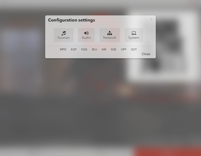

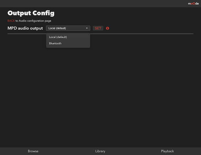

Here are a few more moOde 4 pics showing the Theme section in Customize, new Bluetooth audio capabilities and some miscellaneous screen shots
-Tim
WOW!
Does this mean what it looks like: BT speaker (Moode as BT sender) supported?
Hi @JST1963,
It could be a nice feature and if i get more requests for something like this then I can add to the TODO list.
-Tim
Yes please, I would find this feature useful.
