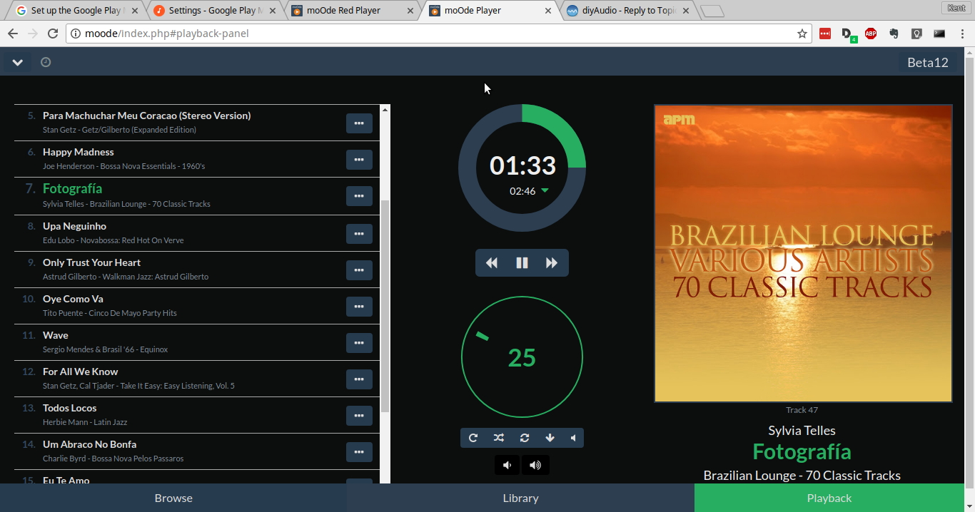

I just got Google Play Music running on a virgin build of moOde.
It took me about 15 minutes to create a Google Play Music subscription, install the google play music interface, enable the moOde UPnP renderer, and pull up a playlist from GPM using BubbleUPnP on my Android tablet. Most of the time was spent in that second step (it's that protracted python build of lxml, required by Mechanical Soup; it should just install the python lxml package instead, as I discovered earlier).
In BubbleUPnP, I have chosen "Moode UPNP" as the renderer and "Moode UPNP mediaserver" as the library. In the BubbleUPnP library panel I'm now offered Gmusic and Tidal folders.
I'm listening to a GPM latin jazz playlist as I type this. The entire playlist displays in the moOde Playback panel (see attached image). The only quirk I saw was a delay in loading the album art.
In the parlance of the Internet, it all "just works" for me. (moOde r40b12, RPi3B, ethernet connection, usb headphones for a quick-n-dirty test).

Umm, that's not exactly what's going on.
I should have specified the options I chose when running the image builder script
Code:
** Option 1-5: use a proxy server for Internet access (y/n)? n
** Option 2-5: use a WiFi connection instead of Ethernet (y/n)? n
** Option 3-5: configure /var/www as squashfs (y/n)? n
** Option 4-5: install latest Linux Kernel (y/n)? y
** Option 5-5: Airplay, Ashuffle, LocalUI, Scrobbler, Squeezelite and UPnP/DLNA
** Install additional components (y/n)? y
** Ready for automated image build
** Proceed (y/n)?
The output from Koda59's clever use of ssh to execute a remote cat command is
Code:
// STEP 2 - Expand the root partition to 3GB
// STEP 3A - Install core packages
// STEP 3B - Install core packages
// STEP 4 - Install enhanced networking
** Compile bluez-alsa
// STEP 5 - Install Rotary encoder driver
** Compile WiringPi
** Compile rotary encoder driver
// STEP 6 - Compile and install MPD
// STEP 7 - Create moOde runtime environment
// STEP 8 - Install moOde sources and configs
// STEP 9 - Alsaequal
** STEP 10 - Squashfs option not selected
// STEP 11 - Optionally, install latest Linux Kernel
// STEP 12 - Launch and configure moOde!
// STEP 13 - Final prep for image
// COMPONENT 1 - MiniDLNA
// COMPONENT 2 - Auto-shuffle
// COMPONENT 3 - MPD Audio Scrobbler
// COMPONENT 4 - Shairport-sync
// COMPONENT 5 - Squeezelite
// COMPONENT 6 - Upmpdcli
** Compile Libupnp jfd5
** Compile Libupnpp
** Compile Upmpdcli
** Compile Upexplorer
// COMPONENT 7 - Optionally install gmusicapi
// COMPONENT 8 - Local UI display
// COMPONENT 9 - Allo Piano 2.1 Firmware
// END
Note that "COMPONENT 7 - Optionally install gmusicapi".
If you drill down to the UPnP Config page at this point, you'll find you can enter account credentials for Tidal and Qobuz Music Services but for Google Play Music you'll get the informative message
The Google Music feature is enable but the API must be manually installed.
Run the command "sudo pip install gmusicapi" from an ssh session.
That's the install I was talking about. Once it's done, the UPnP Config page will allow the entry of Google Play Music credentials.
Yes, I mentioned Tidal was visible, but that's only because I'd mindlessly entered its credentials at the same time I entered the Google Play Music credentials.
