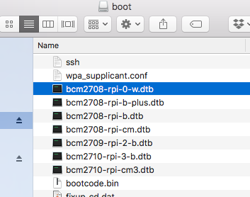

Appreciate the response. I am determined to get through this. As you confirmed the net.ifnames is at the beginning of the first line with a space in my build.
I am unable to make a wifi connection but I pressed on with ethernet and was able to move all the way to STEP 13(12). Have not been able to go forward.
Must be something wrong with my procedure for making the ssh file and wpa_supplicant. conf files is correct. With SD card in the card reader on my desktop is a drive called boot. I then opened Textedit to make the new file "ssh". The file is empty so I use TextEdit commands file, save on the sd card called "boot". I then confirm there is a file called "ssh". Here is a screen shot.
Appreciate your support.
