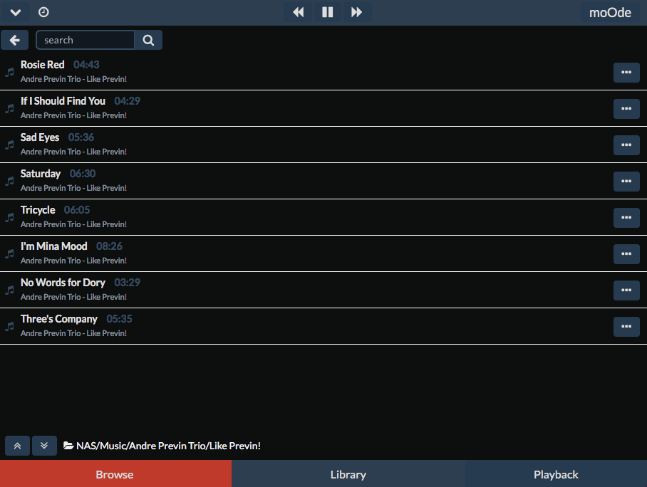

Hi Tim... just an idea
Is it possible have the same kind of visualisation in playlist's songs as in player's view?
The actual's one it's a bit confuse.. and it's no so important to know where is it resident the file stored... and the best more nice, with a little thumbnail of the cover
I.M.H.O. obviously...

Hi Marco,
Browse panel shows file names when there are no Album, Artist tags present in the files. When tags are present the Browse panel looks like the attached screen shot.
