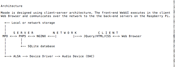

If u are curious Moode 2.x has many component parts. It consists of PHP, JQuery/Javascript, HTML, CSS and BASH source code, a set of configuration files and a SQL database that contains player settings and configuration.
There are 71 source code files, 7 SQL database tables and 10 configuration files. Source code includes 19 PHP, 29 Javascript, 4 BASH, 14 HTML, and 5 CSS. Many other support files exist but are not generally involved in feature coding or bug fixes.
Main Infrastructure Components
- Raspbian based OS
- MPD music server
- PHP5 scripting server
- NGINX Web server
- SQLite database engine
- Zend Media PHP-Reader
- Libav-tools audio codecs
- libSoX resampler
- USBmount storage auto-mounter
- Shairport-sync Airplay receiver
- DJmount miniDLNA server
- upmpdcli UPnP renderer for MPD
- upexplorer UPnP metadata provider
- Samba CIFS/SMB file sharing
- JQuery Javascript
- JQuery Knob
- JQuery Countdown
- JQuery Scroll
- Twitter Bootstrap
- Designmodo Flat UI
- Font Awesome
- WiringPi GPIO interface
- IQ_rot rotary encoder driver
- Knob.sh volume knob cli
The architecture is client/server. Diagram attached.
TC
