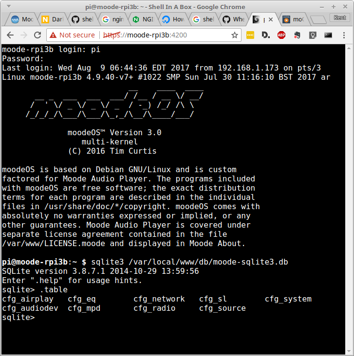

Hi, Mike.
You're a step ahead of me. I hadn't even thought about the possibility until you brought it up.
As for wetty, I was about to say I'm not in favor of a java solution, but skimming the wetty site it looks like it uses javascript. It goes on my list of possibilities.
I started looked for other solutions, though, and guess what? There's one already available in the debian repo called shellinabox. It installed on my moOde Player with a simple sudo apt-get install shellinabox. To the client browser, it is a service displayed as a VT100 emulator, implemented as an AJAX web application.
The attached screen capture from my PC shows the result of my first attempt running it as a separate webserver listening to its default port 4200 and paying no attention to ssl issues. Like webconsole, it requires no modification to my browser (other than it be javascript and css enabled). Unlike webconsole, it is a true terminal.
This looks pretty good already. It seems to me there are two configurations possible for moOde Player
  1. as is, accessing it through its own port
  2. as a menu item in moOde Player, accessing it as a proxied server behind the existing nginx server.
I personally favor the first choice. I think it's too fiddly to make it a normal user function, but that's just me. In any case, it's up to Tim what, if anything, should be done with it.
I was able to access this using Google Chrome and Mozilla Firefox browsers. Don't have a Windows machine within reach to try Microsoft IE/Edge nor a MacOS/iOS machine to try Safari.
As a final test, I tried accessing it from my Android phone and Android tablet using Chrome and Firefox. The terminal comes up but I had trouble logging in because the damn auto-correct function was gratuitously capitalizing and otherwise diddling with my username and password entries. Drilling down through the Android settings to turn off this helpful behavior is a real PITA.
Kent

Hi Kent,
Can you tail -f the mpd log using shellinabox, or run nano editor?
-Tim
