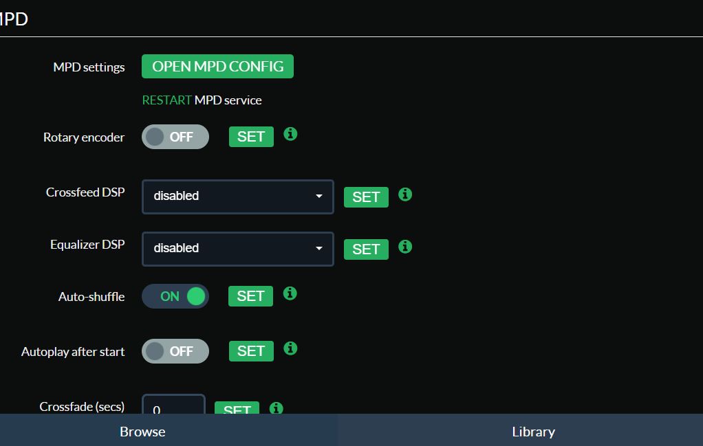

Use it every day, just works and always has, for me, whether it music from a nas or a local USB source.
Set the option in setting>audio, then...
Set the option and the shuffle option in the playback screen.
To test, create a single-song playlist with the option ticked and play. When the song finishes, a new one should be added and cued to play, ad infinitum.

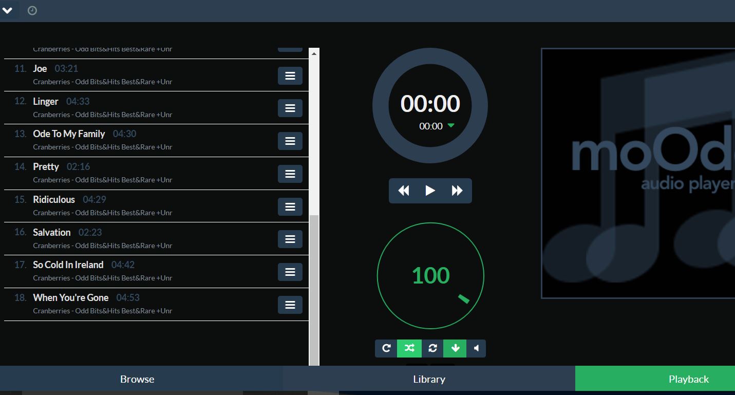

Did exacly the same, even with the grandberries if this may help , but nothing of an automation there.

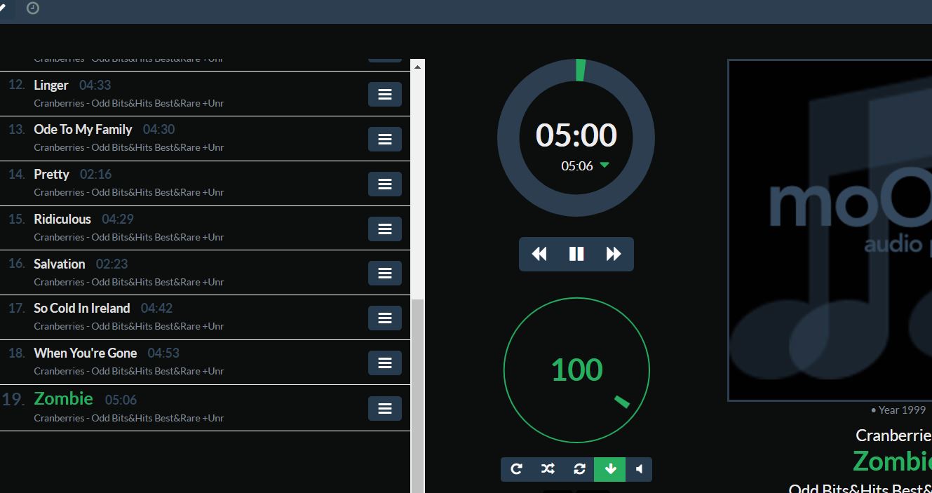

Don't press consume mode, just press the random play button and consume mode btn should light up.
If a track is not automatically added to the Playlist then the problem is external to the Auto-shuffle feature. I use it all the time and never any issues.
After pressing the Random play btn the Auto-shuffle process should appear in the output of PS.

When u press the Random Play button the Consume Mode button should automatically light up. Should be no need to also press Consume Mode.
-Tim
Thanks.
I leave consume on, then select random depending on whether I want consume active or not.
I didn't realise shuffle would turn it on automatically
