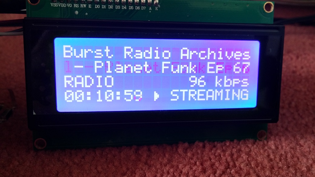

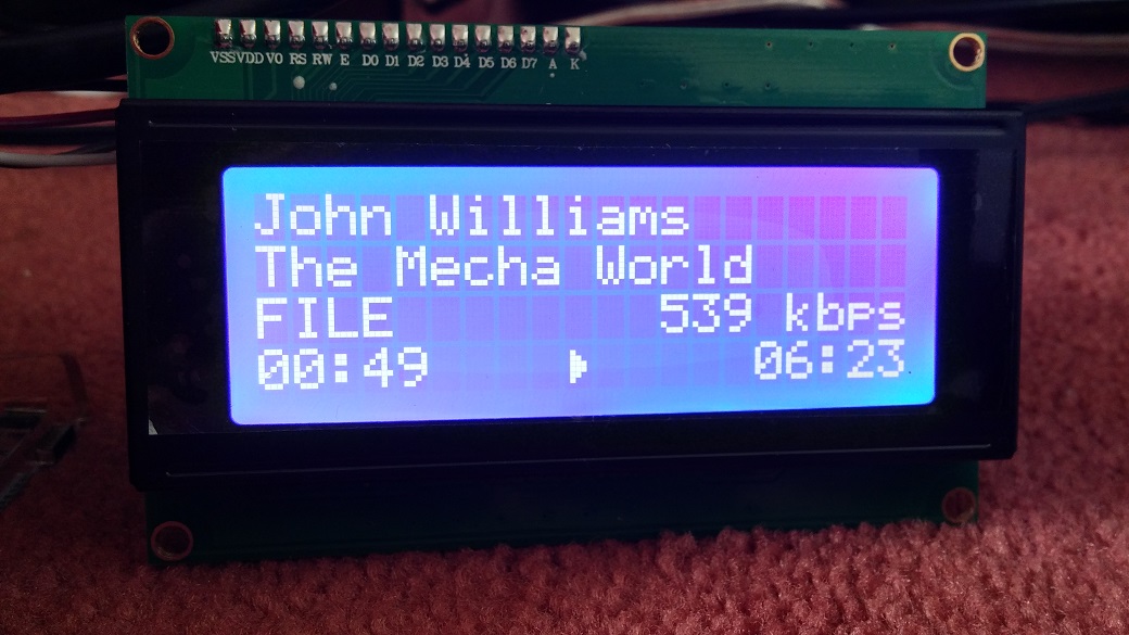

I am trying to add a 20x4 LCD and so many threads and places say it is so easy and scripts can be downloaded from everywhere.
That's the problem, so many options and none seem to give all the instructions needed.
I followed the instructions at Using An I2C Enabled LCD Screen With The Raspberry Pi
And other than my one is designed to operate on 5v with no extra interface board and has a different address
I2C_ADDR = 0x3f # I2C device address
LCD_WIDTH = 20 # Maximum characters per line
It works.
I have tried downloading various python packages including that moment add on (for the time from what I can find), but only files for a non I2C oled.
Does a list of instructions (in one place) exist telling you how to get the display to work including the path to put for "LCD update engine"
Thanking all you experts in advance for any help.
One, maybe two last questions, is it best to use a display that needs many connections or a I2C one?
Can there data clash with data going to the DAC module?

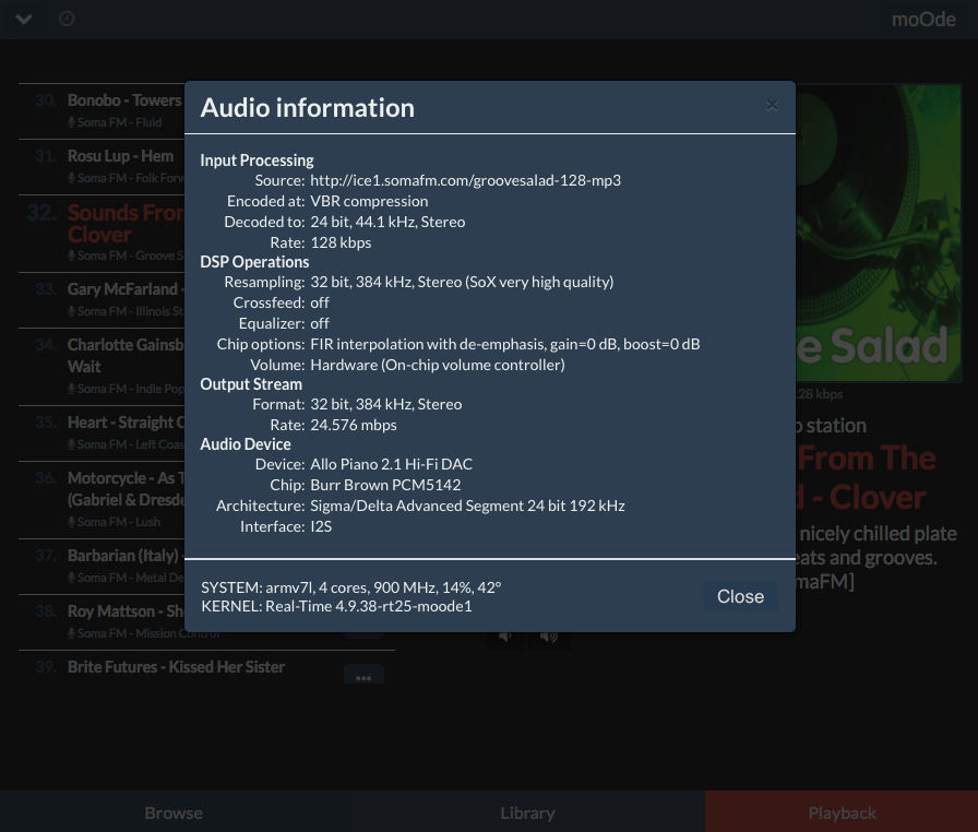

Hi, just a brief update on moOde 3.8.
The excellent 4.9.38 LL and RT Advanced Audio kernels from Soundcheck are integrated and working great. These kernels include some nice new capabilities:
- 384 kHz output for Piano 2.1 Dual-Mono and Dual-Stereo modes.
- USB audio driver for M2Tech hiFace DAC's
Full MPD Hardware volume control for Piano 2.1 Dual modes whereby the two internal HW volume controllers act as one.
