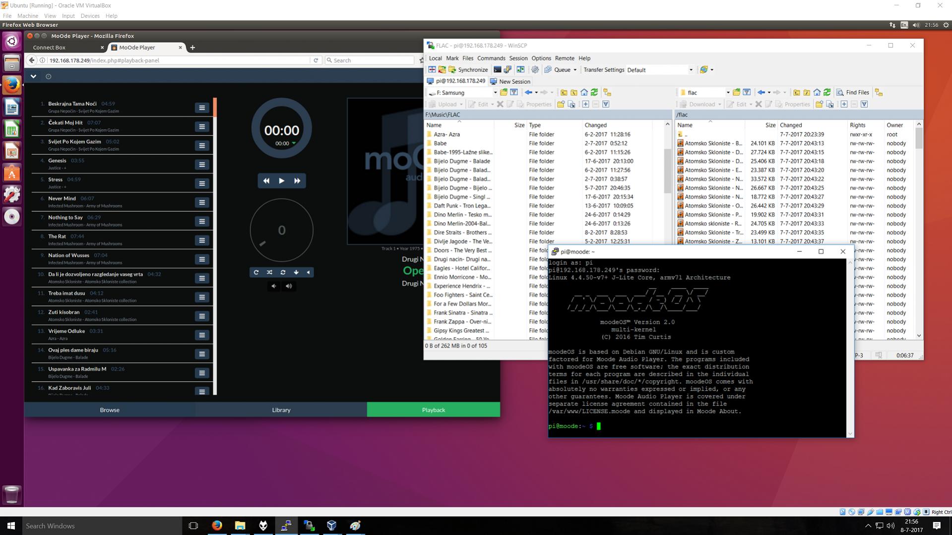

Is it possible to copy audio files to the sdcard? Im using an usb stick atm and would like to play music directly from the sdcard. The sdcard currently holds the moode image.
I'm trying to install ubuntu on my system. I did expand the sd card but I get no drive letter, so I'm stuck there... And also no way on earth with windows to transfer to ext4 and its time to try a linux system.
@dabore84
If you have your music on some other computer, then Tim's suggestion to use the SAMBA share capability is probably the path of least resistance. From that computer, follow Tim's steps for its operating system to mount the MoOde Player share, and copy files to it.
I infer from your reference to windows that you're running some version of Windows on your regular computer. If you download the third-party WinSCP program, you can drag-n-drop files from the Windows host to your MoOde Player. There may be some fiddling with permissions to get them into the right directory (I'm away from my MoOde Player so can't check at the moment). Rafa mentions "you can ssh into moode..." but of course Windows does not offer ssh natively. There is limited ssh capability in WinSCP but full capability in the third-party program PuTTY.exe (which plays well with WinSCP). These programs run in Windows XP/7/8/10.
If you already have music on your usb stick, you can ssh into your MoOde Player and, from the command line, use the Linux cp command to copy the music files from the usb stick to your sdcard.
As for installing Ubuntu, now you're getting serious! I personally run dual-boot systems which have Windows 10 and Linux Mint 18 installed side-by-side in separate partitions (I have my reasons; let's not start a flame war about Windows, please, this is the MoOde forum). Obviously, Ubuntu would work as well.
I have also run Windows 7 and 10 systems with various Linux distros installed as virtual systems within Oracle VirtualBox (like I said, I have my reasons). Just like a native Linux install, any of these virtual Linux systems allows direct manipulation of the two partitions on the MoOde Player sdcard, including file copying, once the VirtualBox Guest Extensions are installed.
I disagree that there is "no way on earth with windows to transfer to ext4". There is the Ext2fsd project which provides such capability on Windows XP/7/8 according to their homepage banner. Reading their blog entries, Windows 10 is apparently supported too. Rafa mentions BASH on Ubuntu on Windows. To the best of my knowledge, this is available only for Windows 10 and even then USB drives can be accessed only in Build 16176 or higher. I just installed the new Windows 10 Creators Update. It turns out to incorporate Build 15046 and can't access USB drives via BASH on Ubuntu on Windows. It does provide ssh and scp just like a native Linux system.

A picture says a thousand words. Looks like something from the movie Inception . Thank you all!
