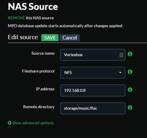

Hello Tim. I have been following this thread for a long time and finally with some spare time on my hands set up a Pi 2 I had sitting here. I was running a mini Intel Atom pc with Windows 10 and foobar. This connected to a USB DAC from DIYINHK
This has been working well, but I was curious about MoodeAudio.
I am pleased I tried it. I know bits are supposed to be bits... but the Moode front end is a pleasing upgrade in sound quality. I'm very happy.
I'm using Vortexbox as a ripper / server on my network and after a little experimentation it was easy to connect to it. My config for reference is in the attached picture.
