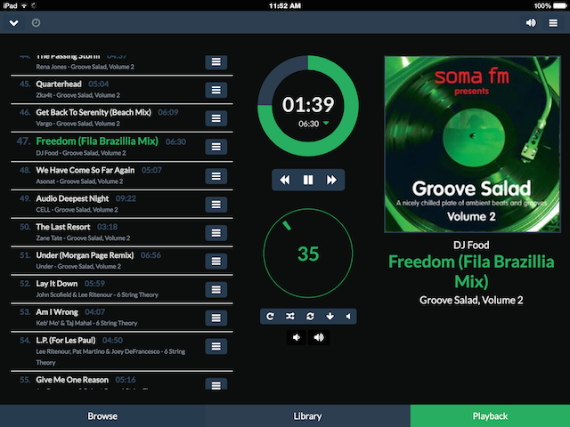

Just another question: what is this "volume knob cli support for USB DAC's" about?
Thanks for the nice compliment and feedback on cover art!
The Volume Knob Command Line Interface (CLI) is a small shell script for controlling volume that is located at "/var/www/knob.sh". It can be used by external IR or Rotary Encoder software to update volume and the Moode knob.
If the audio device has hardware volume controller and MPD volume control is set to "Hardware" then knob.sh will change volume of the audio device and also update the Moode knob
Example:
ssh root@moode (pwd = moode)
/var/www/knob.sh 35
/var/www/knob.sh 0
etc.
