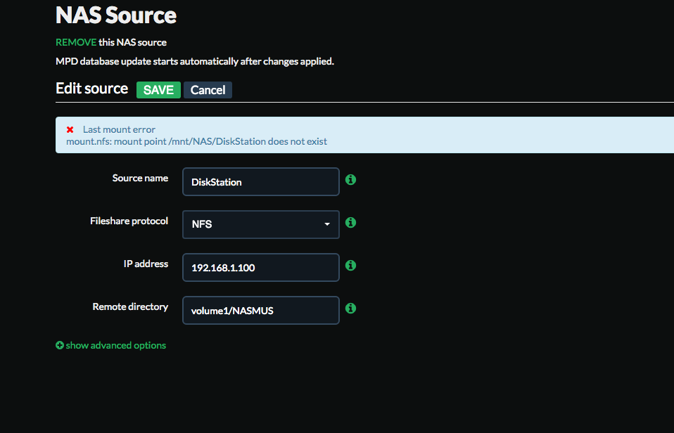

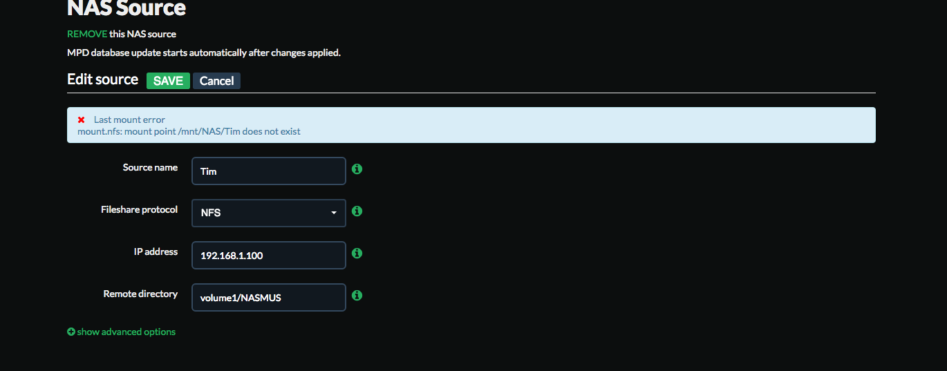

After changing squash to no mapping and the IP address from 192.168.1.100 a green check mark appeared on the Sources screen. However, when I clicked on the next screen there was an error message. Does the error message indicate the source name is the issue or is it indicating the NFS setup of the NAS is more likely the culprit?
U need to enter the IP address of NAS and not http://.....
-Tim

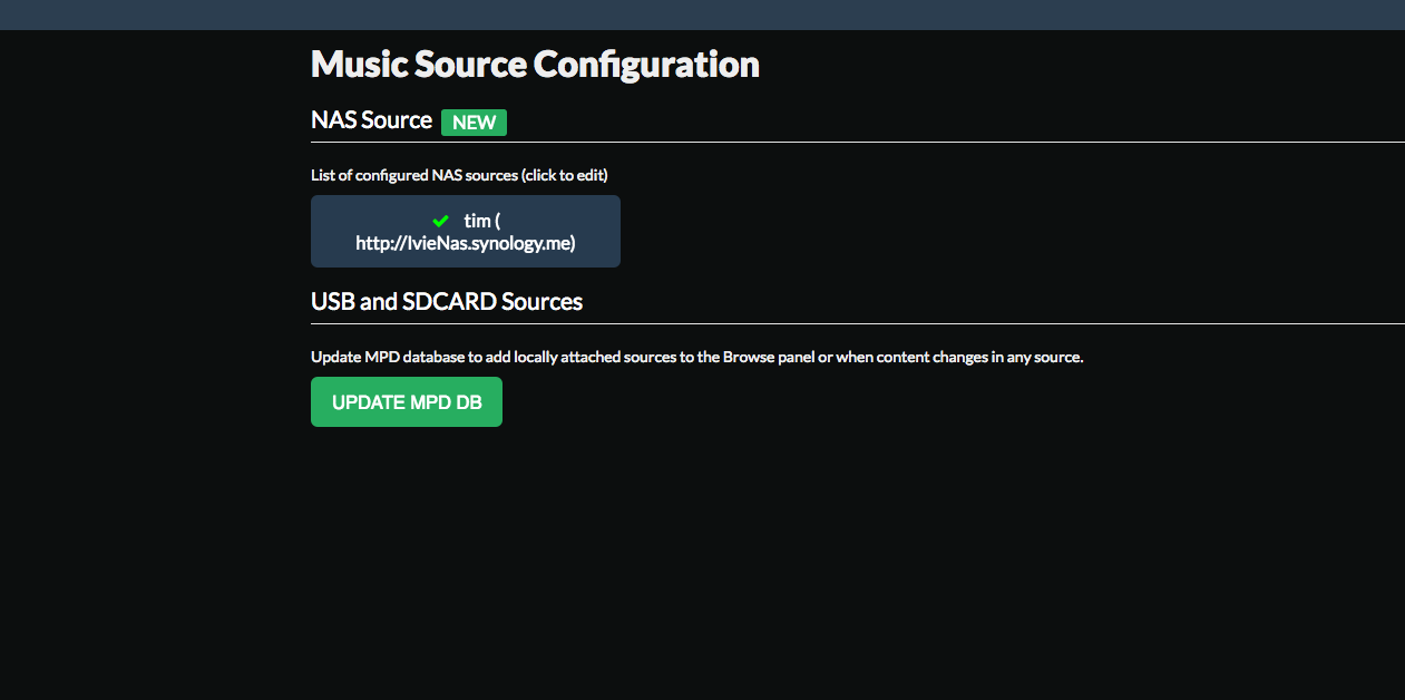

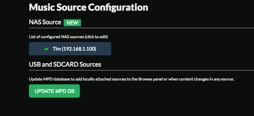

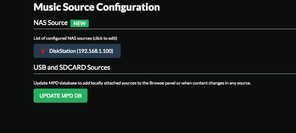

Understand IP address is to be used but after countless attempts, I decided to go outside the box. I have switched to the IP address does not seem to make a difference in the ability to get to my music library. What is really interesting is the when I change the source name to DiskStation a red X appears when change is applied. However when I change the source name to Tim the green check mark appears but still can not connect to the music library.
I have reached out to Synology a couple of times each time they refer to video tutorial to setup NFS but decline to answer questions about third party software. Not really sure why this is so challenging!!
Have u successfully connected to NAS using NFS protocol and viewed music folders from some other client?
-Tim

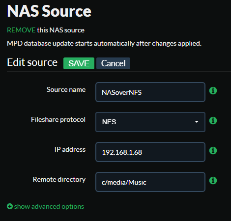

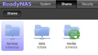

Hi onionhead,
Almost certainly the problem relates to configuring the remote directory source. How certain are you of the address of the remote NFS directory? I had to look it up via the web interface for my Netgear RaedyNAS Duo v2 to be certain: see first screenshot. The thing that totally caught me out at first was the need to add "c/" before media/Music: see second screenshot.
You need to be certain of the NFS directory name.
Actually, after the testing I just reported, I think I was too quick to blame the NAS configuration in and of itself [1] but it's going to take some more work, or some insight from Tim, or both to figure out what's going on. Now that you mention it, I should have repeated my test cases using a directly connected USB drive.
At the time of my first reply, I was thinking this might be a permissions/ACL issue, but that doesn't square with the results of my test case sequence 3/4/5 nor with the differences I observed between WMA and MP3 files. As well, during this testing, I was always able to access the same WMA files on the NAS from another host running, say, VLC player and see the embedded album art as the files play, so involvement of Moode/MPD seems indicated. What I also didn't do was bring up MPD on a regular Linux host and see if it exhibits the same behavior.
Isn't this fun !?!
Kent
[1] My late wife used to complain that I sound like I know what I'm talking about even when I didn't. This may have annoyed her but it was considered an asset by my upper management, especially when it came time to pitch research projects to prospective sponsors!
Many thanks for all of your extensive experimentation on my behalf. I did try to set up an additional SMB/CIFS share on a Linux laptop but could not configure it correctly to get it to work at all. Had it worked, I might have been able to determine if the problem lay with the SMB/CIFS share on my NAS.
In spite of having to give up on that approach, I did discover that accessing the WMA files via the NFS share on my NAS works just fine, so I will give up on using the SMB/CIFS share.
