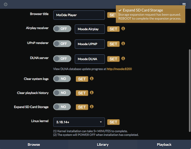

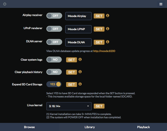

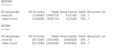

The feature coding is complete for SD Card expansion :) A local folder named SDCARD will be part of MPD folder set. This will enable big SD Cards to be used for storing music! A test release will be available next week for those that would like to try it out.
Screen shots attached.
