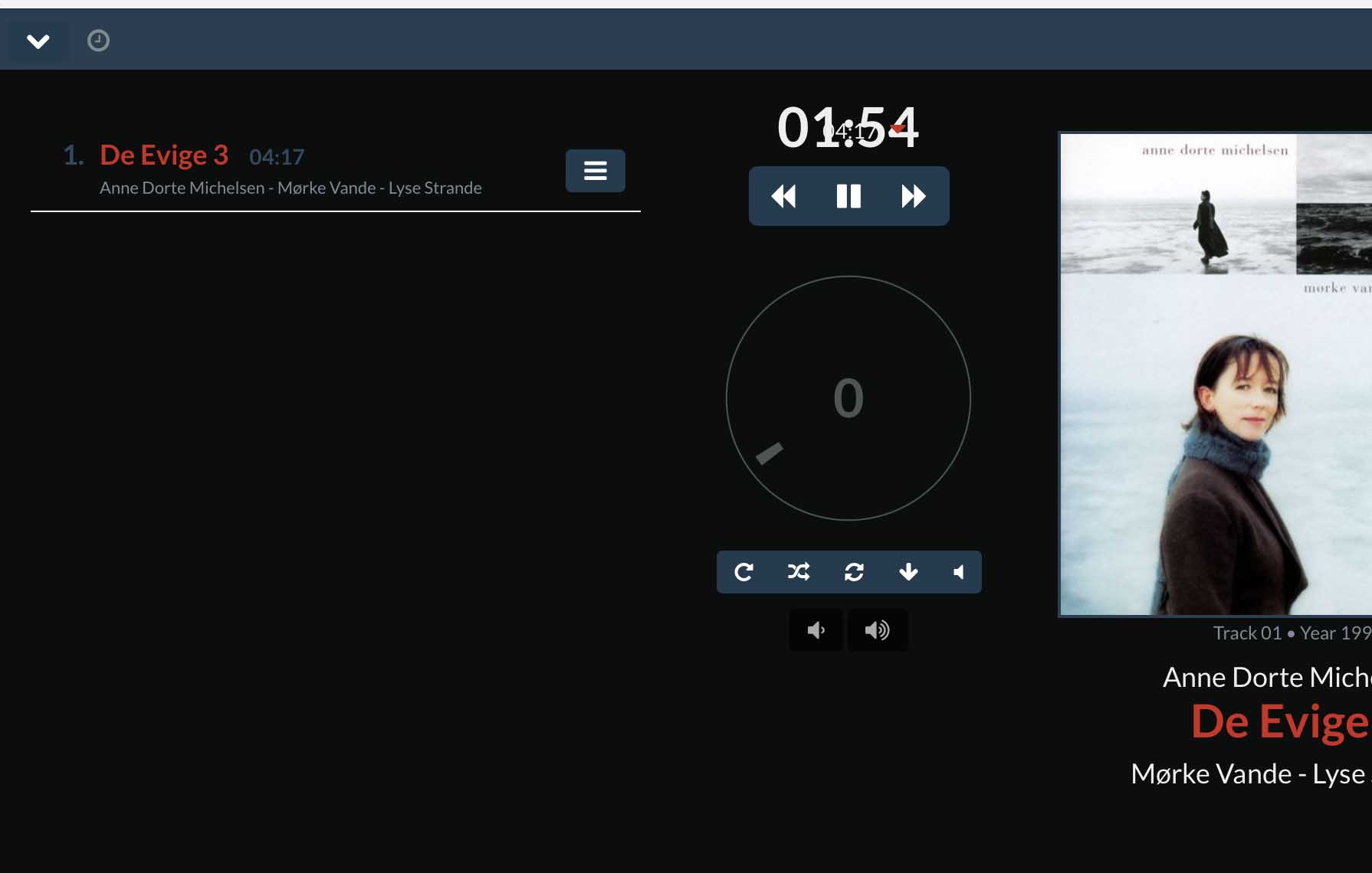

As follow up to my upgrade to ver. 2.5 it has been a headache. I have used almost a day on it and almost decided going back to 2.3 which has worked flawlessly half a year. Generally the system has been in-responsive lots of time when trying to change configuration and I have had several reboots and forced shut down, before the system is working as normal (haven´t testet much yet). I have even checked all my flac-files for corruption.
I have been fearing for at long time, that adding all the features you want and people request, one day will end up in something nobody is able to see all the consequences of - hope I'm wrong :)
Now I have got the feature of just choose play - which is great, but I have also got funktion in the browser, that looking in af folder for a particular number and going back, sets me to the top of my folderlist - That's a little bad, because it take som time to go back to at folder in the bottom of my list - 2.3 didn't do that. Hint - have you seen how the adressbook is set up on an adroid phone ..
Also the graphic overlay that was in 2.3 is in 2.5 - it's not a big deal, and I can live with that - see pricture from ver. 2.5 in Chrome on IOS 9.x
Hi Jorgen,
The symptoms you describe including unable to resolve host name and non responsive UI suggest a network configuration issue or corrupt sd card, both issues external to Moode software.
The reports I receive indicate Moode 2.5 has been a very successful release for users :) My dev environment has six Pi's, 3 Pi-1B and 3 Pi-2B connected via Eth and Wifi. I use OS X ElCap, IOS, Safari and no issues. I also test w/Chrome and IE on Windows, no issues.
To troubleshoot:
(1) run a ping test from Pi to Router or to some other host on the network and then examine the ping statistics for evidence of network issues including excessively long round trip times, packet loss, etc.
(2) determine why host name unable to be resolved to ip address
Tim
