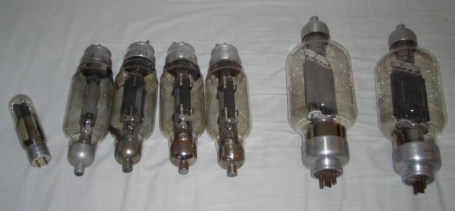

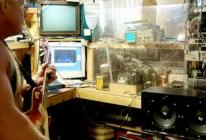

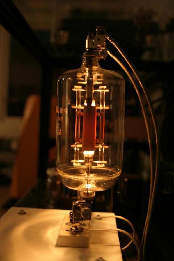

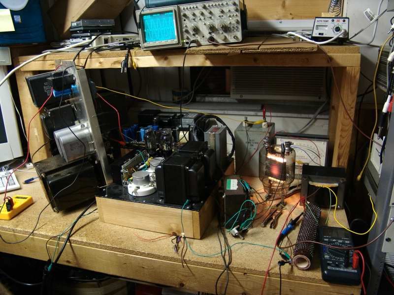

I have posted this before, but you asked for it.....
I built this as an experiment. It existed for about a week or so before I tore it down since it took up the whole work bench, used all the available line (mains) power (blowing the breaker twice) and could cause death, fire or explosion at any moment.
It put out about 200 watts using an 833A running on 1500 volts idling at 275 mA.
The 833A SE Amp Prototype

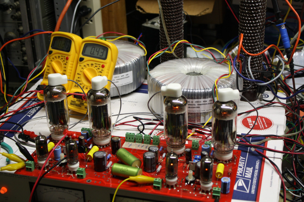

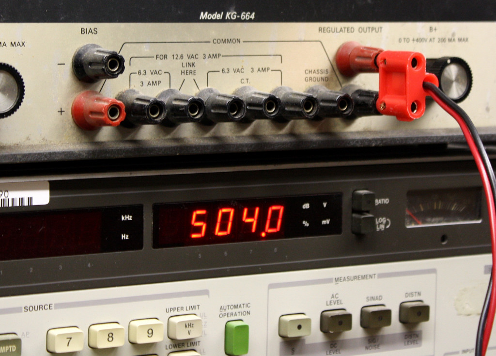

Forum member Pete Millett (pmillett) created a mild mannered push pull amp that made 18 WPC. I performed the Tubelab treatment on it and extracted 250 WPC or 504 watts cleanly and 525 watts at clipping with both channels paralleled. See posts 425 and 438 in this thread:

Are those 6lQ6 tubes in the output ...?

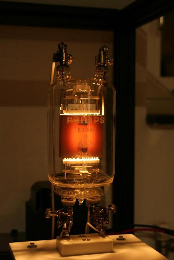

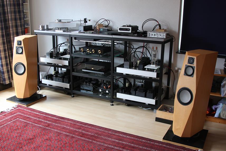

Philips TB 3/1000 amplifier

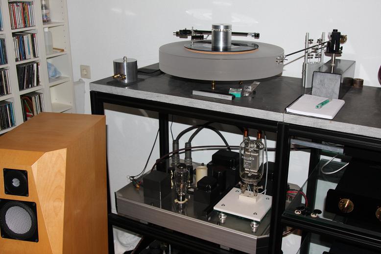

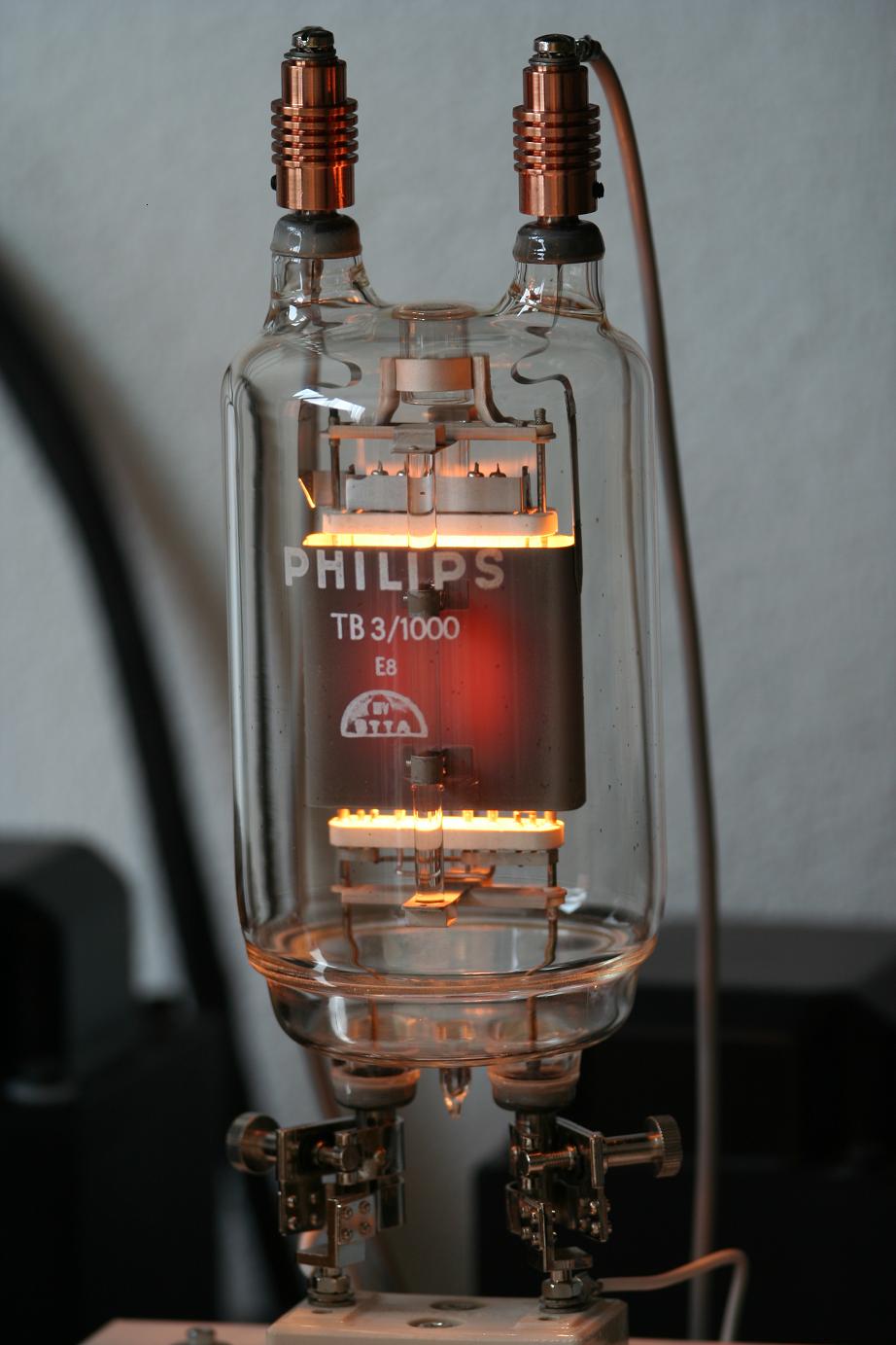

Good afternoon DIYaudio-forum,
also already posted in a thread on this forum ( http://www.diyaudio.com/forums/tubes-valves/111971-tb3-1000-alive-european-833a.html ) is my amplifier.
It started as a 833A-amplifier (2 monoblocks with dedicated external powersupplies) but when i scored a stash of Philips TB 3/1000's i quickly changed to that triode instead.
Currently they run at 110 VDC / 240 mA. But what are numbers; it is the sound that is important !
Looking forward to see this interesting list grow....
Reinout
The tubes in that picture are 35LR6's because I got 45 of them NIB at the Dayton hamfest for $4 each. 6LQ6 are far out of my price range for experiments like this.
Petes board seems to work well with any horizontal sweep tube that fits the socket, and even some that don't, with some creative rewiring. I have run dozens of tubes through the board but the 6LQ6 / 6JE6C isn't one of them due to the cost and relative scarcity.
I settled on a 6HJ5 build that made 125 WPC and posted it back into the original thread. Several builders have duplicated it with good results.

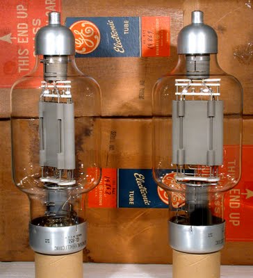

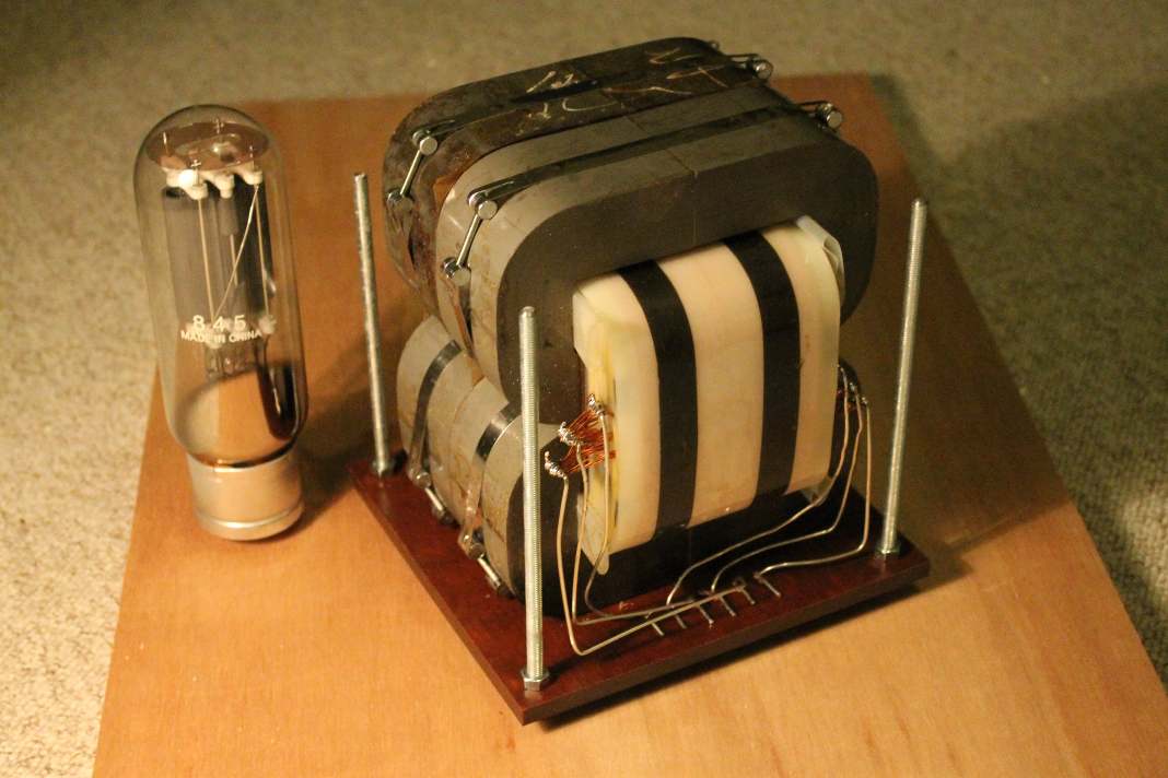

I just finished this one (18.5 kg before potting) for an 851....
The tube next to the transformer is an 845, to give an idea of dimension.
I am happy that the customer listens in mono
Left in the picture is a 211; at the right an 851.
Can you provide some info about the amp that will use it?
No can't; don't know what circuit the customer has in mind.

My biggest design were only 125Wrms per channel so nowhere close to qualifying..
aaarrgghhh, i noted a horrible mistake in my message (#9). Of course these triodes are not working on 110 VDC / 240 mA but on 1100 VDC / 240 mA !
Regards, Reinout
Send me a PM if you would like me to correct your typo in post #9.. (or let me know here as you prefer)
Anyone qualified to play with the power levels talked about here understood since 110 volts and 240 mA can't even warm up a 6L6GC! Big tubes like big volts. Big power requires a few big tubes or a lot of small ones.
125 WPC is where I feel safe with the red board. I am not planning to post the details for anything bigger since there are some traces close enough to each other that might emit smoke at higher power.
I think I've seen that picture before but never noticed that subtle stylish flair in the application of the ViceGrips.
