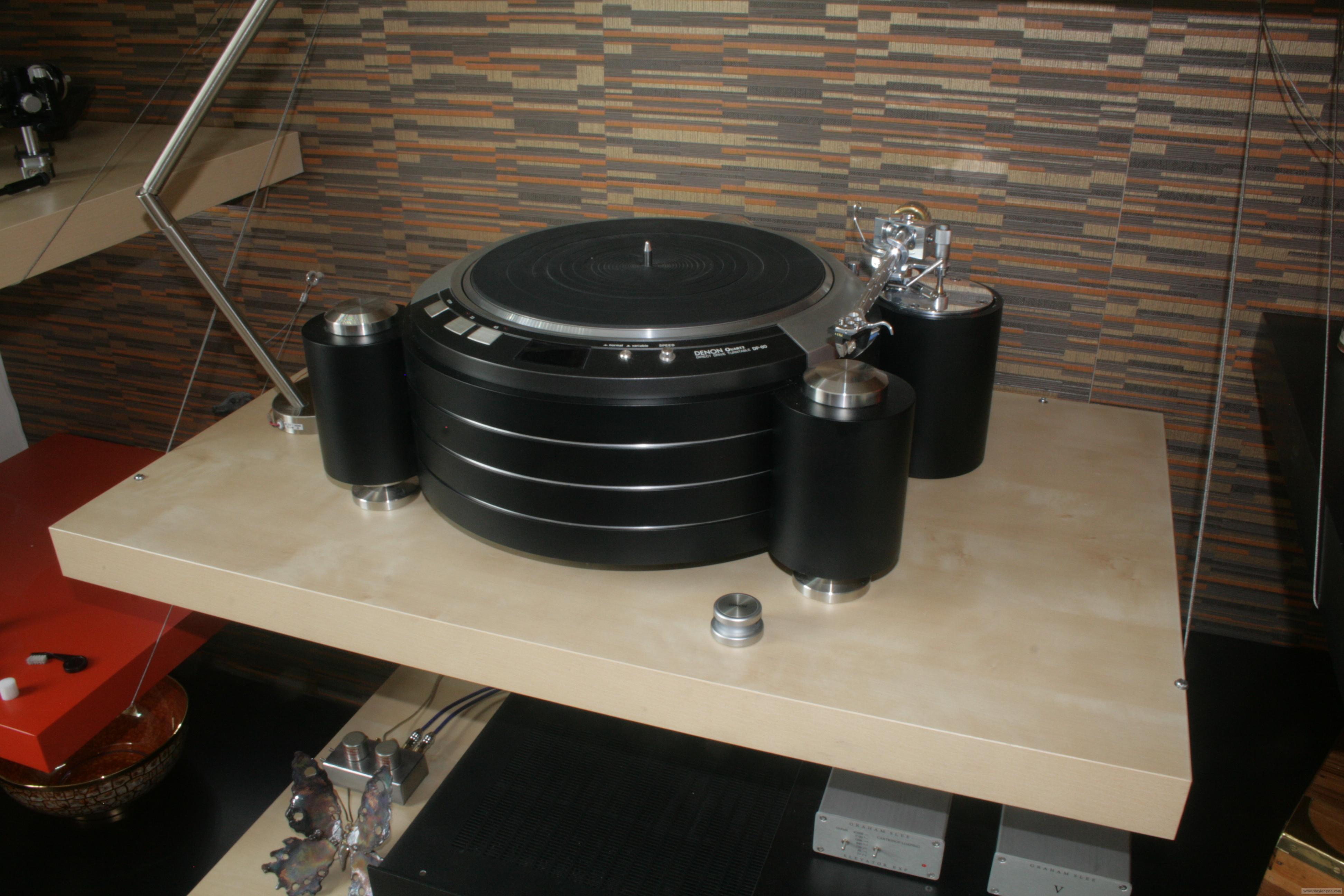

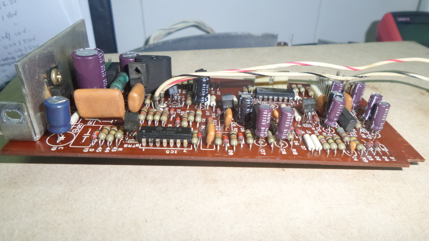

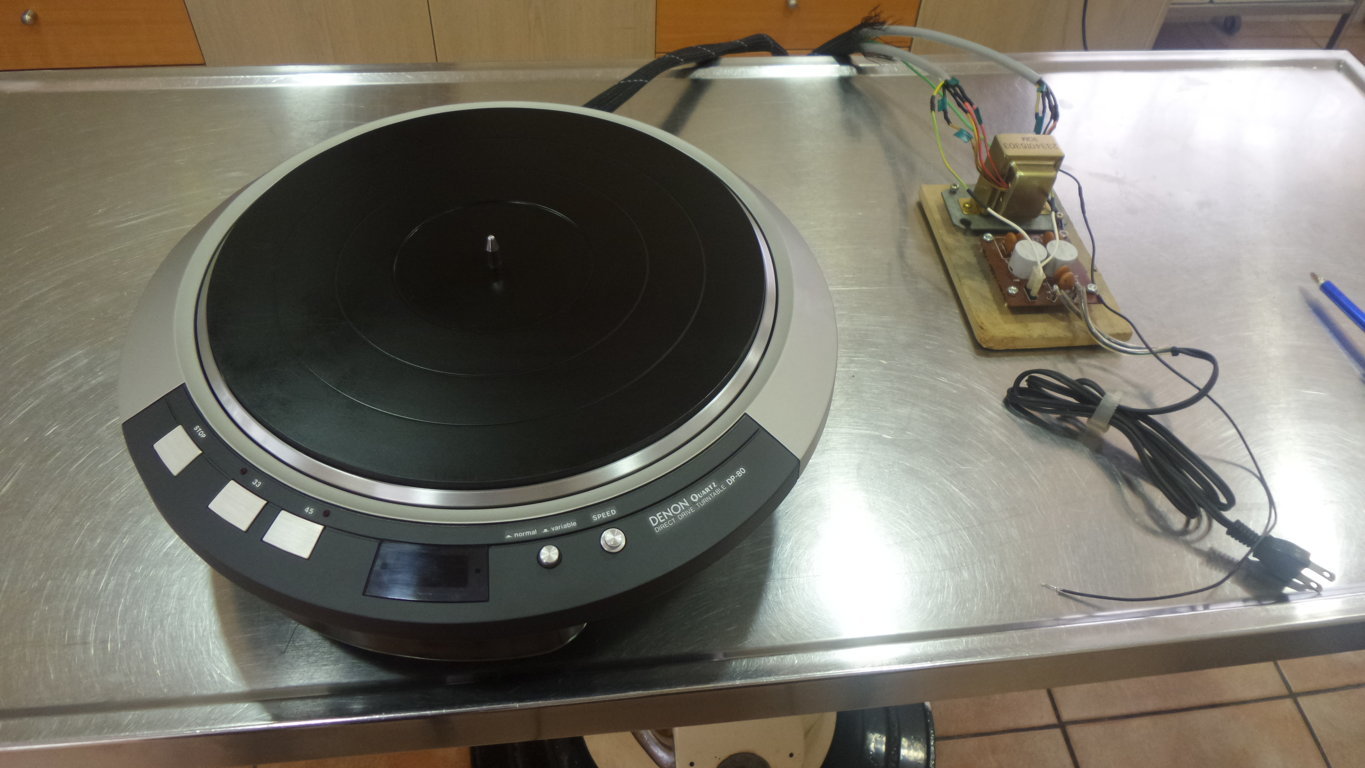

Plus a couple more...

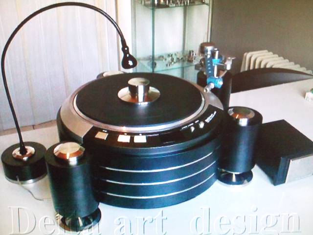

One is a close up of the PS box and the other is with a stylish lamp ,matched to the turntable colors ...
I have to thank of course the "Delta art & design" team for transforming
my designs into CNC executable files and for their contribution into metal selection,raw metals preparation and cutting and help into making this
(and other crazy designs of me) come to reality...
Fabulous project, and a real inspiration! I have two Victor TT-101's and a SP10 sitting here, waiting for my lazy bum to get startet on some plinths... hopefully this autumn!
I have been toying around with the sandwich concept myself, as a way to cope with vibrations etc.. Alu, Corian, rubber, stainless steel.... all of it is being considered (and researched) as we speak. As I am no great fan of free-standing armboards I will have to find a way of incorporating a flexible and adjustable system that can take 9" - 12" arms of different types and makes, without any (possible) vibrations from the motor entering the arm base. Luckily the summer never happened this year, so there is no risk of overheating the brain cell!
Thanks for the good words!
The possibilities with the mix and match of different chassis materials
and dampening/absorbing solutions are endless.
I prefer to use different metals with strategically placed dampening materials.
I think suspension is uselles if you are over 35-40 Kilos.
As for the free standing armboard...i totally agree.
You can follow a solution like the one i used or ...
you can incorporate a round free standing block inside a cutout in
the -presumably- rectangular chassis.
There is a way to be able to use the same block for 9 and 12 inch armboards
by making this cylinder around 10 cm in diameter and drilling just one offcenter armboard hole in it.
By rotating the round block the offcenter hole either comes near the spindle
(9" tonearm) or pulls away (12" tonearm).
This is a very neat solution to your problem.
The block itself could be all one mass,different metals or make it hollow (bowl like) use a separate -scew on- top layer for attaching the tonearms and experiment with different fillings,eg lead shot,liquid silicone,sand etc etc.
The most damping i have achieved (completely DEAD) is sand saturated with motor oil or lead shot with motor oil...
But most damping doesn't always produce the best or more "likeable" sound...

It's a great basis for a top turntable George.I wish you all the luck!
I have just acquired from Japan a Pioneer PL-L1 whose parallel tracking arm
i consider a masterpiece but the platter itself i consider of a lesser quality.
I am thinking of mating one of my DP-80s with that arm in a custom heavy construction and put it side by side to my LT-5V based turntable.
Two diy parallel trackers, one vertical, one horizontal...what more to ask?

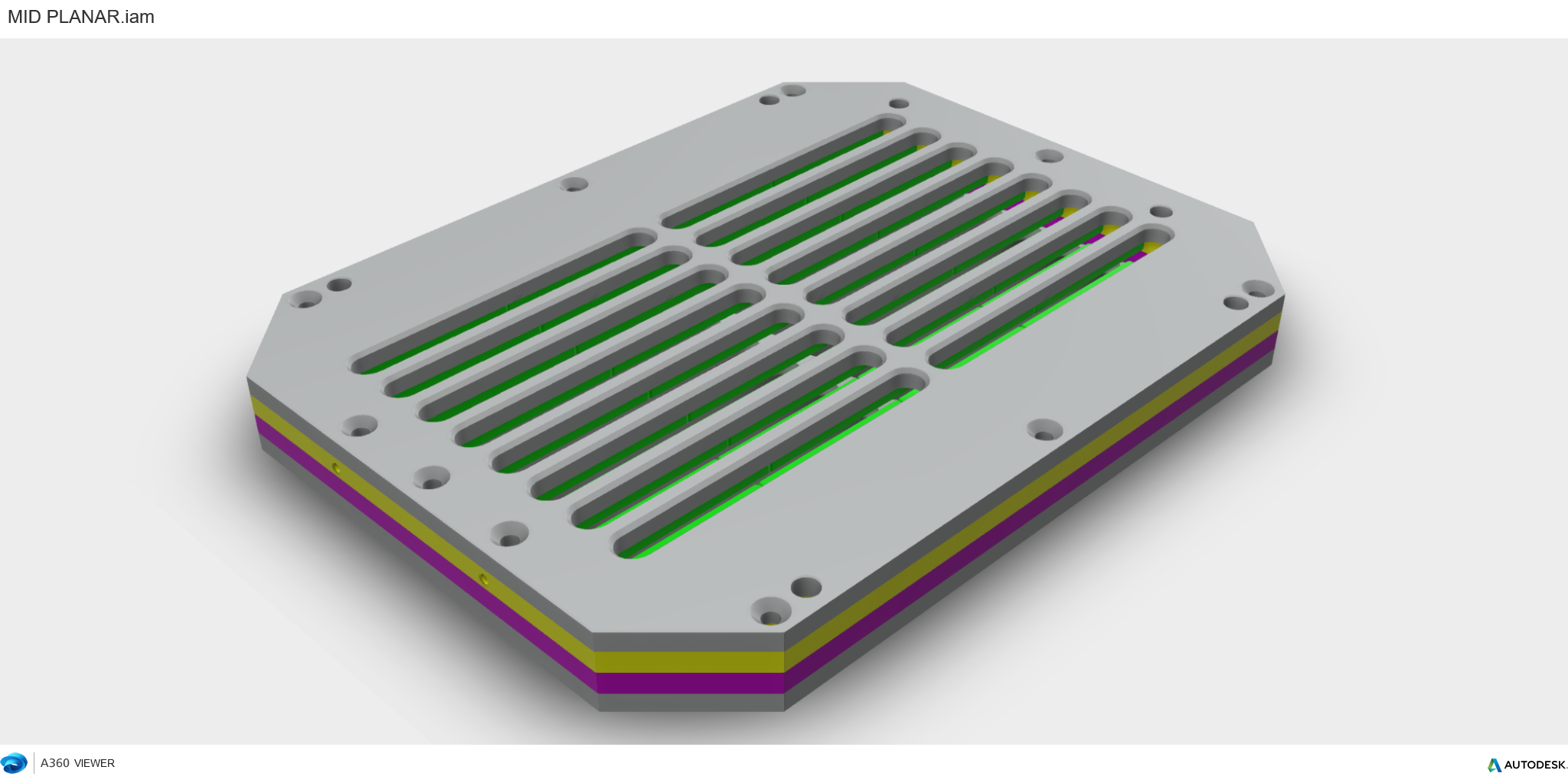

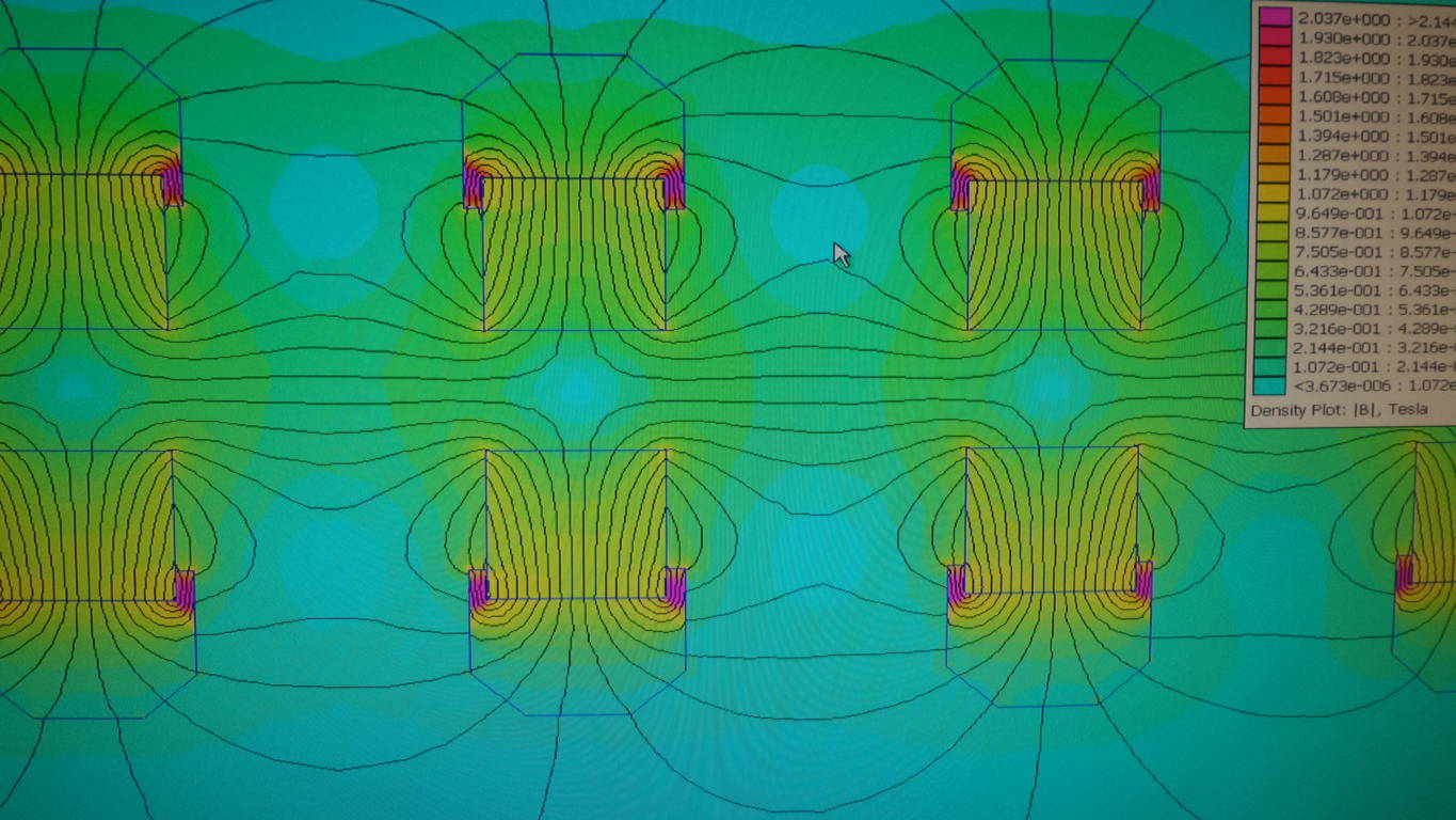

As for what my new plans are ... these days i am in the process of producing a medium size, very high quality, high-efficiency planar driver able to play from 250 Hz to 10Khz with a novel way to "tune" the foil. I am also in the process of making my own direct drive motors, one about the size of the DP-80 but slightly wider, one that is 1.5X and one that 2X that size (about the size of the DP-100 motor). The plan is to be able to make my completely own line of DD turntables (probably three models) with my own motors and electronics with progressively heavier construction and heavier platters with magnetic levitation...see example of entry model.

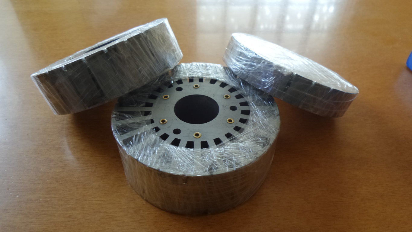

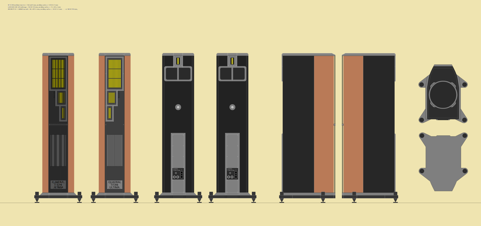

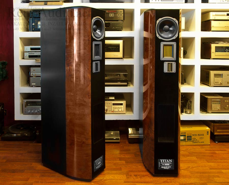

Regarding the speaker: the front facing woofer will be replaced by a larger planar element -so large that the mid/tweeter combo will have to be lowered about 10 cm- leaving the active top mounted -transmission line loaded- 30cm woofer to act as a subwoofer from 150 Hz downwards. The order for the new larger foils has been made and i am waiting for them maybe within the week.
The ribbon tweeter will be re-located in the back to enhance the "ambiance" of the recordings and its place will be taken by another larger unit custom made for me by a friend who works in the business. Also, other work will be done...reinforcing the woodwork, on the crossover and the general aesthetics. Hoping to make it have planar sound in all but the subwoofer and look like this:

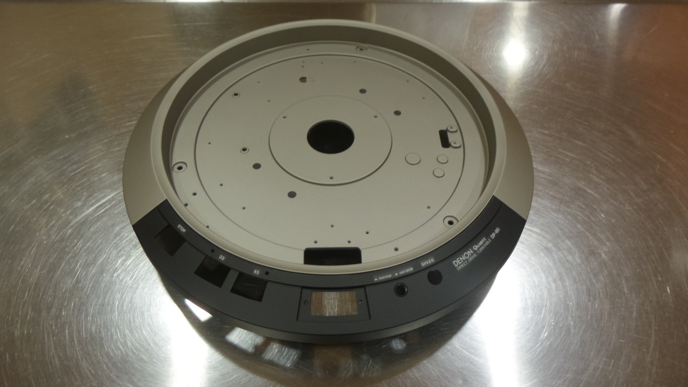

I Have the project of buiding a table, but neither my knowledge, nor my ressources allow me to lokk forward such an elaborate project. I just plan for a more conventional plinth.

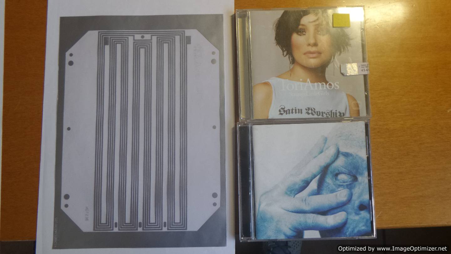

I read in the very first lines that you got the DP-80 with a cutout schematic. Would you be kind enough to post it under the format which is most convenient for you? That would be a great help for many people.
Thanks in advance.
