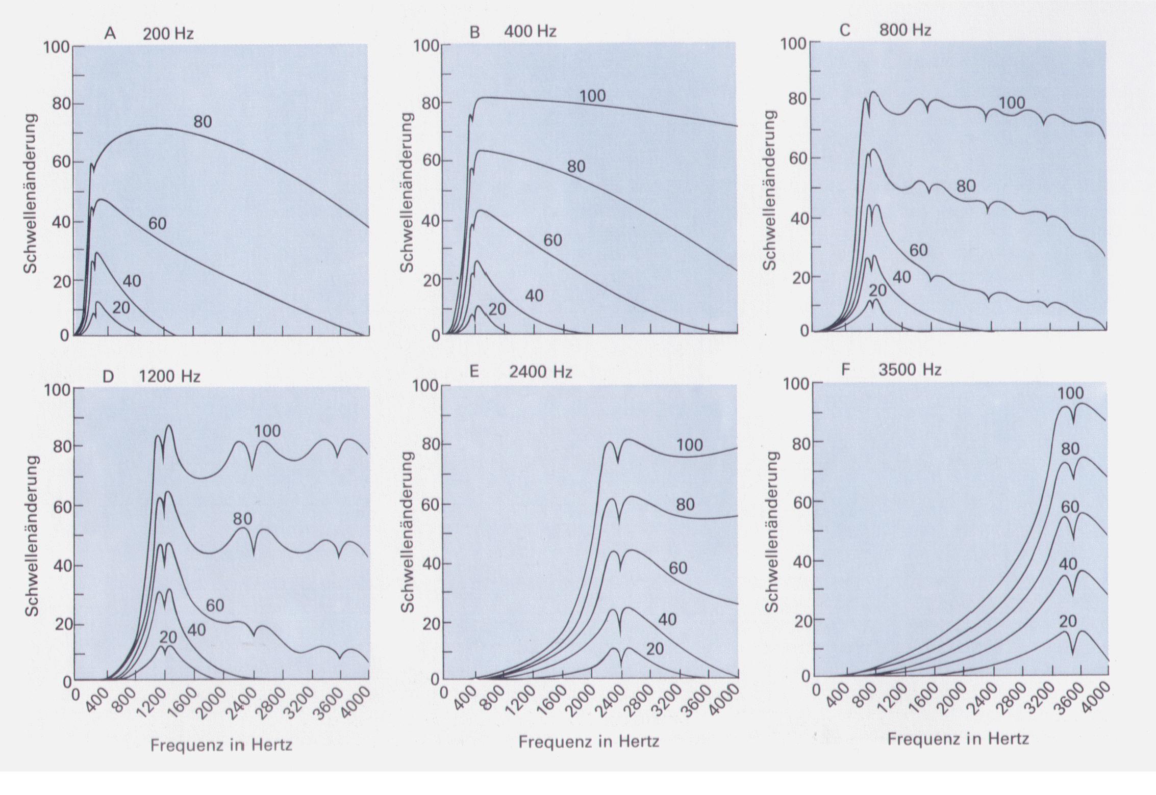

These masking patterns are for simultaneous masking,
which is not the only auditory masking effect low frequency
maskers can have on the perception of higher frequencies,
because there is also a pre- and a postmasking.
Picture shows maskers down to 200 Hz, that was the lowest
i could find so far.
Source: http://www.medialab.fh-osnabrueck.de/~kamo/intern/06ws/av/pdf/21_av5_audcomp2.pdf
That paper is on audio coding, where masking effects are exploited
consequently in data reduction formats like mp3 ...
At first glance it seems to me that low frequency content resulting from
long decay in a room is well suited for masking higher frequency content
if loud enough.

Oliver, the best "data" I have has 8 data points. I have theory with some support, not close to thorough.
Dan
Dan,
well german wikipedia e.g. offers an approximation formula
for simultaneus masking, where Sl is the lower slope of the
masking curve and Sr is the upper slope.
Gross approximation of masking slopes:
Maskierungseffekt ? Wikipedia
The lower slope is assumed independent from frequency
(on bark scale) in that formula, while the upper slope is
frequency dependent.
I do not know how close that approximation is for maskers
in the lowest say 3-4 octaves of the hearing spectrum.
But nevertheless auditory masking seems a rather well
studied effect. Very close approximation of masking curves
seems to be a kind of science of its own e.g.
http://www.acoustics.bseeber.de/tun/da.pdf
(e.g. Picture 2.5 in Chapter 2.6)
But for our purposes of discussion here, it seems not
necessary IMO to approximate masking curves very closely.
