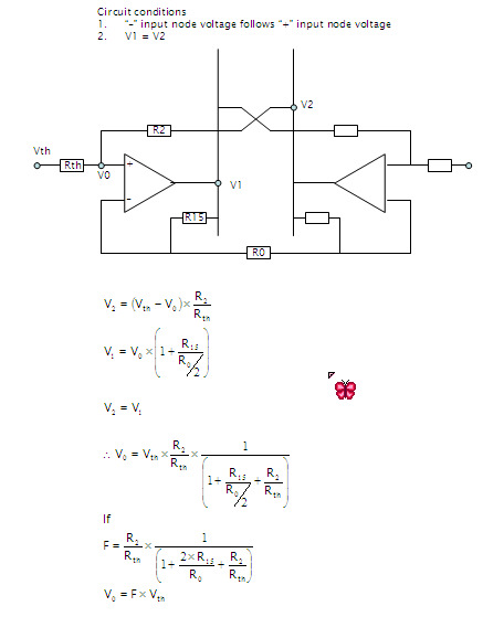

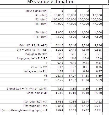

Hi Jh6you,
Do you think by increasing the resistor value of R12 and R13 and decreasing R15 will increase the overall gain? If I'm not mistaken the gain will be 2(2R12/R15) = 2(2*7.5k/1000) = 30 = 29.5dB. If I'm wrong pls show me how you arrive at the gain of 15dB?
Hmm...
I think I should change the output trans to MJ15003,4.
Thanks,
Ipanema
Hmm...
Thanks,
Ipanema
Hi Ipanema,
You must be right.
Attached my gain estimation made time ago.
The calculation did only with one side input.
Therefore, I need to double the gain, considering bothe side input, i.e. to be 30dB.
Regards
If any of you see error in calc, please comment it. Thanks.
You must be right.
Regards

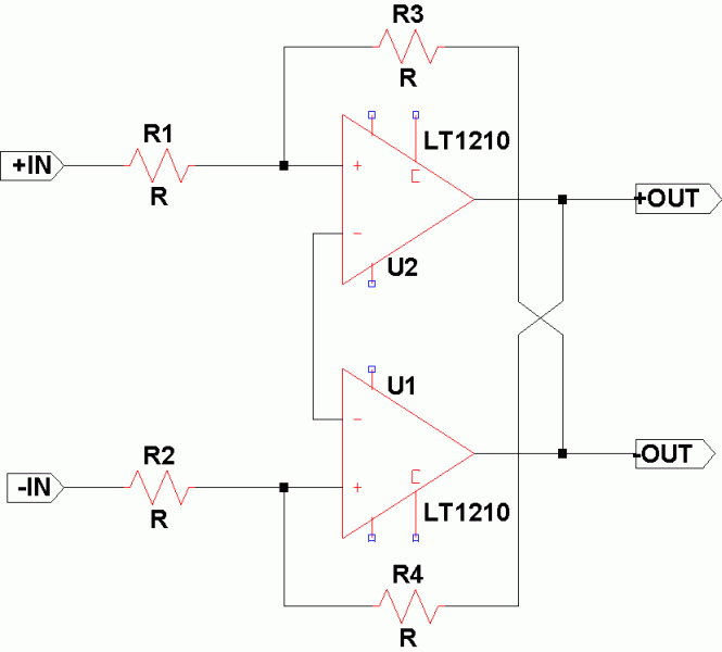

Re: What about these Chips?
Forgot to attach.... well, nothing new, just added the LT1210 designation...

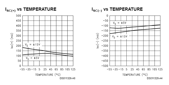

Hi Jh6you,
Thanks for some insight into the calculation. It seems that the output limitation is set by LM6181. From the datasheet, the guranteed Isc is only at 75mA, hence I think 90mA might be a little over the edge.
Since, the base of power transistor is not driven by opamp output but by the supply modulation, I might assume that low hFE will not pose any loading problem to the opamp. Hence, I can increase the output bias as long as my heatsink and output transistor can take it. Pls advise, how high hFE can be beneficial in this circuit? I have connect the output transistor as TIP142 and TIP147 yesterday (min hFE=1000 at 5A). Hope to test it today.
Theoretically, for balance output, the output power is given as P=4Vp^2/2R = 4*9^2/2*2 = 81 watts for 2 ohms load.
For my case, 8 ohms load, P=(4*9^2)/2*8 = 20.25 watts. Thats the maximum I will get with LM6181. Ic=1.125A. Will the power increase with darlington transistor?
Ipanema
Ipanema
Hi Ipanema
The attached sketch shows Isc curves (maximum load current) of LM6181. With 15V rail voltages, typical Isc = 130mA and limit = 100mA. The data sheet also says that typical high output drive is +/- 10V into 100 ohms. By the way, if the guaranteed figure is only 75mA, I think we again need higher hFE for low impedance load.
I agree that the base of power transistor is driven by the supply modulation. But, eventually, the supply ac current modulation is proportional to the op-amp output ac current, IMHO.
I agree with the 80W calculation for 2 ohm load and the 20 watts for 8 ohm, with respect to voltage swing. As you might already know, for the 80W for the 2 ohm load, we need peak current of Ic=9A. We understand that, if the transistor is ready for the 9A of Ic, the amp is ready for the 80W for the 2 ohm load.
I do not think that application of Darlington will incease more than 20W for the 8ohm load.
I wish your successful test with TIP142/7.
Did you do PCB-construction or p2p for your MSS?
I used p2p. I could post some pictures if you like to see.
How do you like the sound?
I am fully enjoying mine, with 10ohm/0.47uF/10ohm zobel.
I could not start building GCSS last weekend. As I informed earlier, I built three new MSS. By the way, I found a minor problem with one of them. Therefore, I spent whole week end for trouble shooting. The problem was that I soldered one point badly. Now all work okay.
Regards
Regards

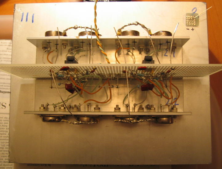

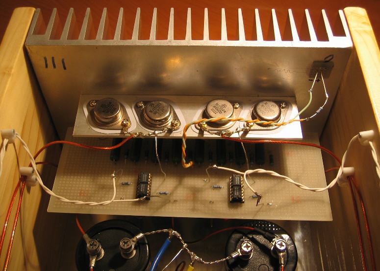

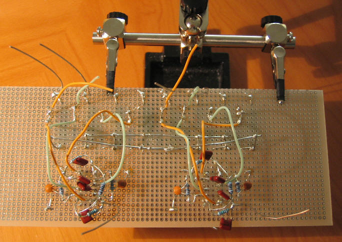

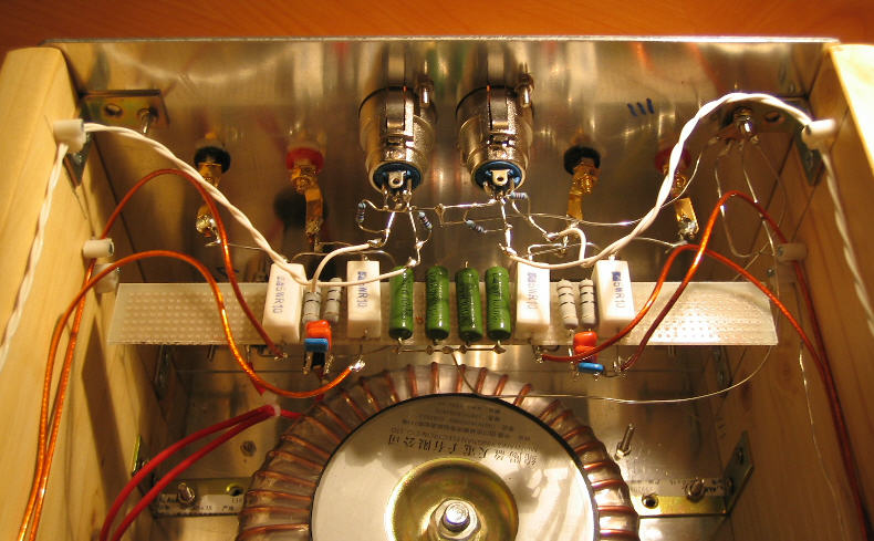

Hi Ipanema
I think R5/6 will do two roles: one for dc-return and another for stable offset. I applied these as Nelson Pass recommended. He could explain better than I do. (Where is he these days?)
With the zobel, the sound is slightly different. You could test it on your taste.
My latest MSS are also built with the breadboard and by p2p. Four pictures are as follows. The look of my soldering is bad. I however do not care the look. I just use much solder to secure the soldering points and to reduce resistance at connections.
Regards
Regards
