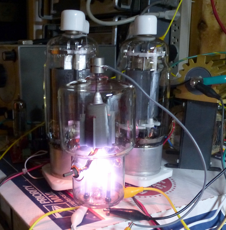

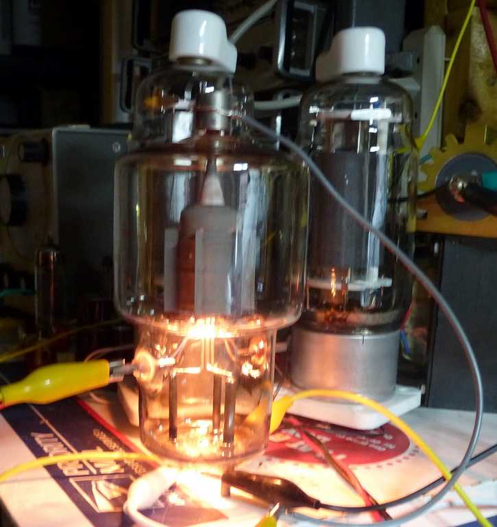

Todays tube sorting adventure yielded several interesting specimens to play with. Did I hook up some of the 6V6's.....OK, 6L6's...no??? OK, how about the biggest tubes in the box....YEAH, thats the ticket. Actually I just hooked them up to a power supply to see if they were any good. Well, I have good news, and bad news. The good news, one tube biases up properly, and the grid does actaully control the plate current. The bad news, the other tube is gassy and will draw current even with a cold filament.
Can you tell which is which?

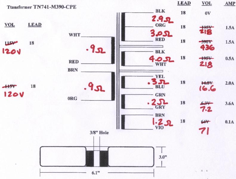

I received two of the power toroid transformers I mentioned in post #109 of this thread. Attached is a pic of the actual measured no load voltages as well as the resistance of the windings for those that wish to model power supplies.
This thing runs on the high side, but it was rated for 115 volt input and I measured at 120 volt input with paralleled primaries.
I also put a 3.2 amp resistive load on the 16.6 volt winding. Even though it is only rated for 2 amp, it only dropped to 16 volts under this load. Four parallel 13GB5's will need a series dropping resistor.
Finally, it is potted in the middle but I wish it wasn't so windings could be added or removed; however, it looks like removal of this potting may not be too difficult.

I have one of them but I haven't measured it yet. Did you find any extra "goodies" in the box with the transformers?
Finally, it is potted in the middle but I wish it wasn't so windings could be added or removed.
I am thinking it will be easier just to add an extra transformer for heater power.

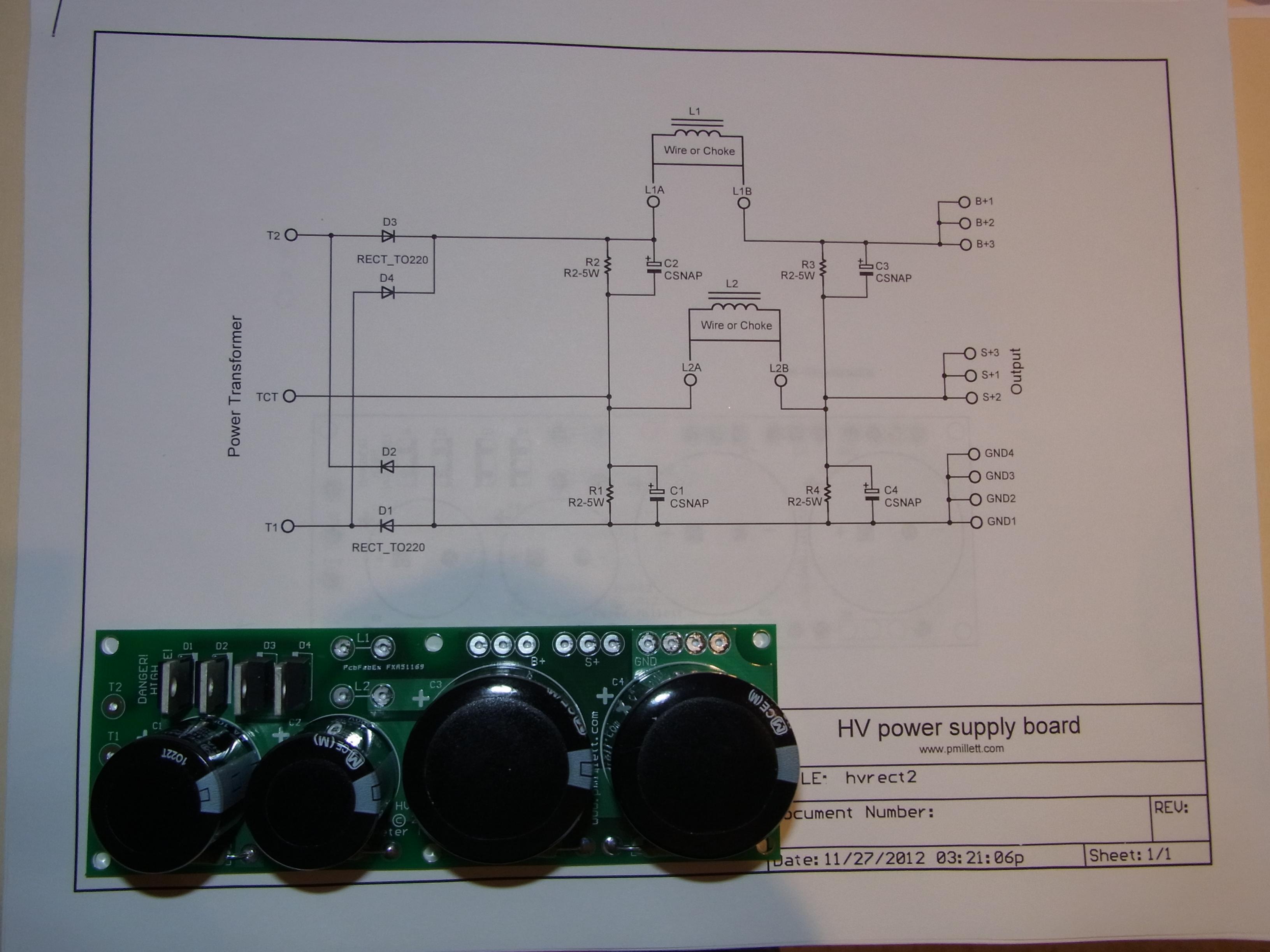

I've designed a power supply PCB to hold the rectifiers and capacitors. I'll post some more info on that when I get it built in a few days.
