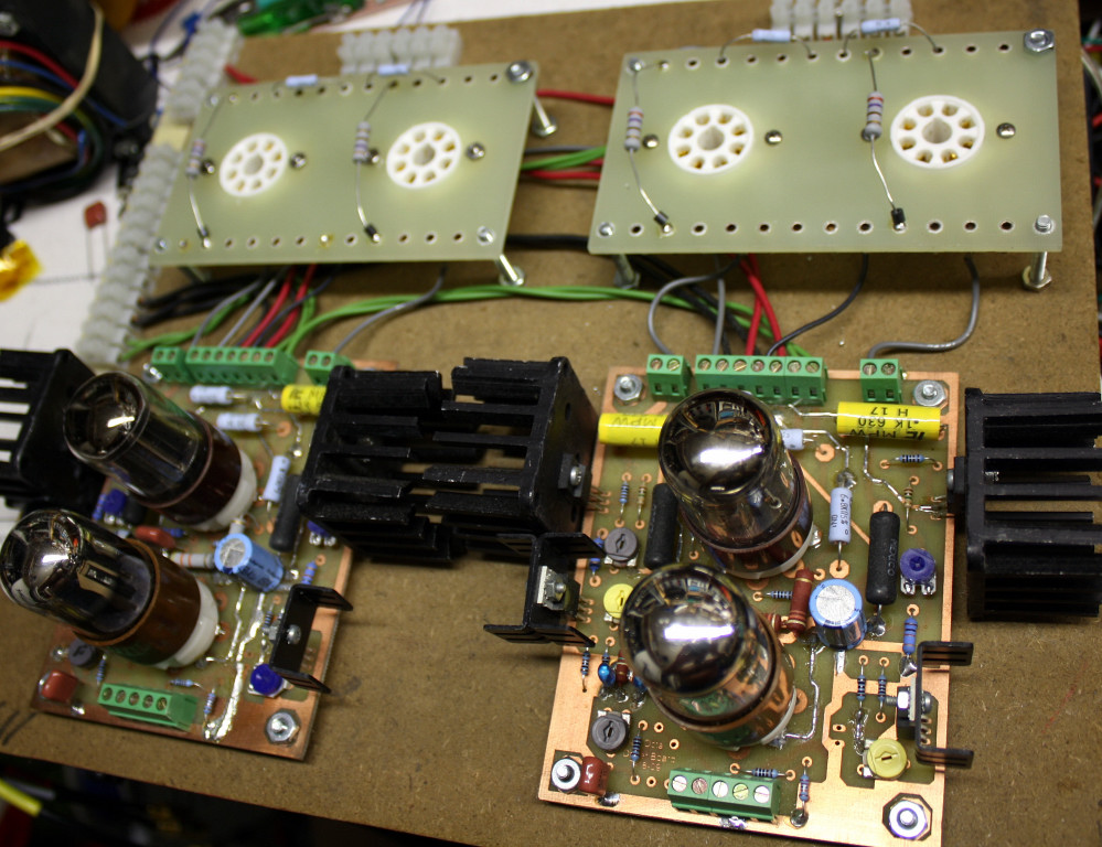

The driver board shown in the breadboard in the first picture above was developed in this thread. The schematic is in post #460.
http://www.diyaudio.com/forums/tubes-valves/133034-6l6gc-ab2-amp.html?highlight=6l6gc+ab2
The breadboard is essentially this schematic except for the power supplies. Chris and I did a collaborative effort on the driver design with me building these boards and his being PTP wired. I used bench supplies so I could experiment with a wide variety of tubes. The power supplies shown are his design and specific to 6L6 type tubes, although others will work.
The driver board shown in the second picture uses the same schematic but uses 9 pin miniature tubes. In both cases the second tube is a 6SN7 or a 6CG7/6FQ7 which is a 9 pin 6SN7. The first stage can be one of several different tubes by changing the plate load resistors. The resistor values depend on the tube type, B+ voltage and how much drive voltage you need. The values shown on Chris's schematic are for 6SN7's or 6CG7's in both places and about 400 volts of B+. As shown it puts out enough drive to crank KT88's in triode into clipping with 450 volts of B+.
I have also designed several flavors of driver boards that use the same basic schematic except that a pentode LTP is used for the second stage. The pentode can be set up for higher gain and a larger voltage swing, which I need for some of my experiments. There are several versions of PCB's that all use a similar schematic. None have been built yet. A turret board was assembled to verify the concept about a year and a half ago. It has not seen power since then.
There are two that use 3 octal tubes, a 6SN7 and two 6SJ7 or 6AG7, and another that uses a 6SN7 and two 6K6 or 6V6.
There is one that uses a 12A*7 and two 6EJ7's. Another with two tubes that each contain a triode and a pentode.
There is a PCB for the 6AU6 - 6AQ5 version all pentode amp that I built several years ago....I found the prototype while throwing stuff out. I think it could make a good little amp or a mid sized driver driver.
There are a few more that I can't remember now, mostly based on tubes that I have lots of.

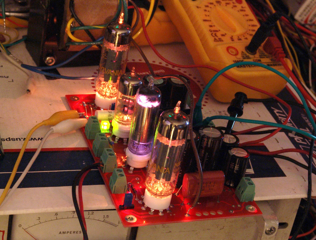

I left work today with a list of things I needed to do.........but there were two shiney red things in my mail box. I put them aside and decided to do some of the stuff on my list......well that lasted about 5 minutes.
I have been stuffing parts into the boards. They are only about 1/3 done, and I really have other stuff to do tomorrow, but I found a small mistake in the documentation.

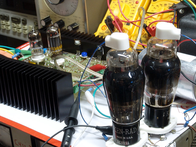

I stuffed most of the parts into a board. I didn't follow any parts list, I just sat down with a board and a printed schematic and made it up as I went along. What can you drive with this board??????

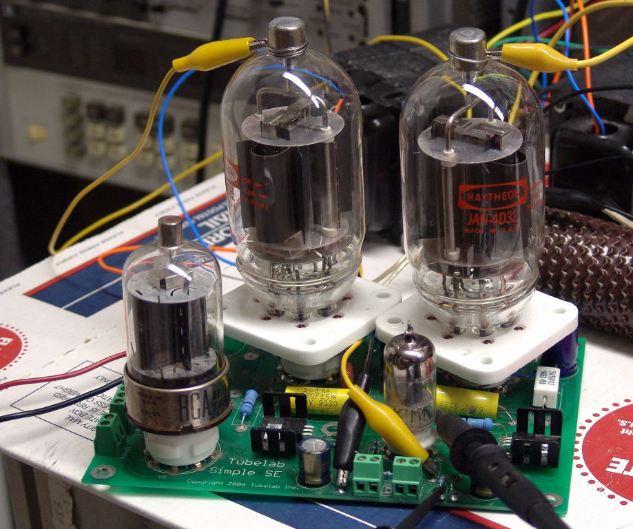

Well I decided to try something that Pete probably never dreamed of. I decided to drive........an output transformer. As I said above the coupling caps are the issue with drive power, so I wired an OPT right up to the plates of the pentodes, plugged in some healthy tubes, cranked the current up to the melting point of the 10M45 (R17 = 0 ohms), and cranked the signal generator up until the distortion meter read 5%. The results......7.5 watts with a 13K ohm load and 320 volts of B+. Yes, the little driver board can deliver 7+ watts, and this is limited by the CCS current. Plug in an LM317 and more watts will flow. The THD was 0.34% at 1 watt, maybe I'll hook some speakers to it.
As time permits I will hook this thing up to some big power tubes but next up is a bunch of little guys that I need to make a decision on soon.

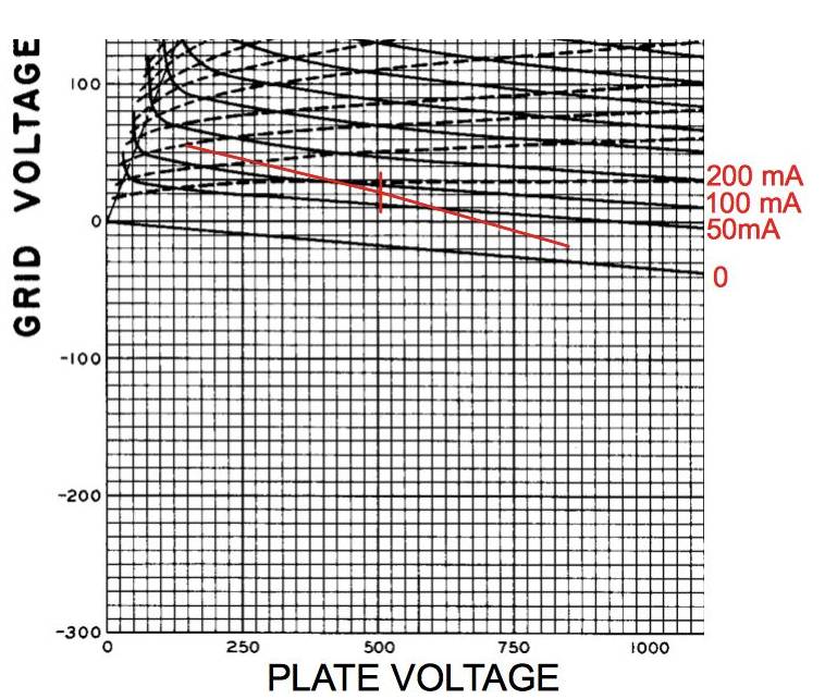

I've been looking at the 35tg myself and although efficiency is super low< it would be fun to try. A small SE should be easy to create. Looking at the constant plate current curves is a little disorienting but the load line construction process is the same. Here are the tradeoffs for a small SE:
Idle plate dissipation should be 40 watts or so to keep the plate in the dull orange range.
The 35tg gm is listed at 2850 but that's at 2000V. If it's even 2000, that gives a Schade plate resistance of something like 500 ohms with 100% feedback. A 5K OPT is a nice candidate as the end damping factor may be in the range of 5-6.
Looking at the low-swing end of the curves with 5K in mind suggests somewhere in the region of 150mA peak plate current, 150V min Vp, which needs about 75mA grid current (third dotted line up). That's 225 mA cathode current.
So I could use ~500V * 80mA as the quiescent point and swing +/- 70 mA into 5K, giving about 250VRMS for up to 12.5W output power. In reality it's about a 10 watt amp.
Class A push-pull could also be interesting and get a little more ambitious to the 25-30 watt range for 2 tubes.
Class AB push-pull with these is quite ambitious and usually ends up in the KV B+ space for an optimum design.
