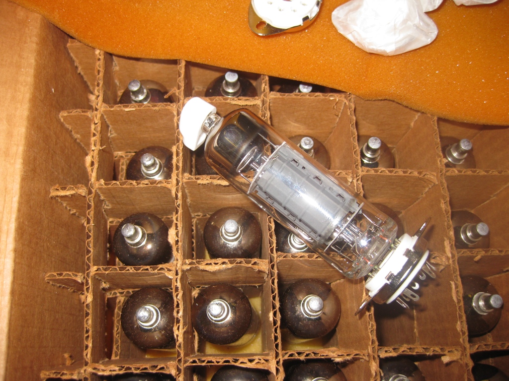

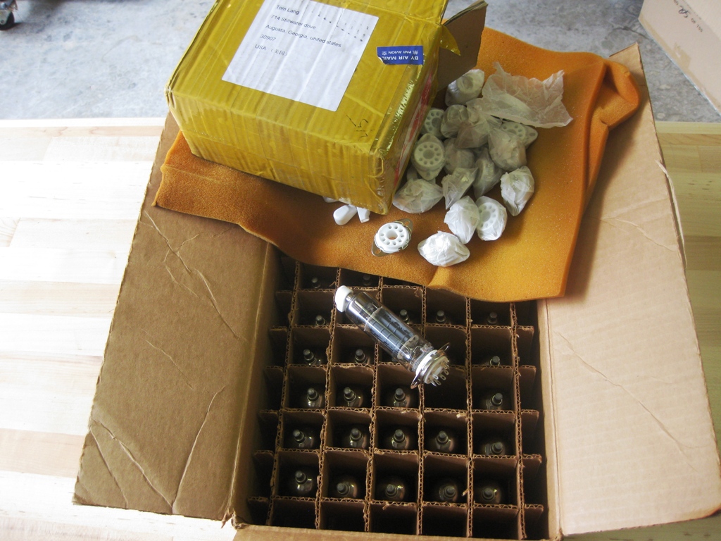

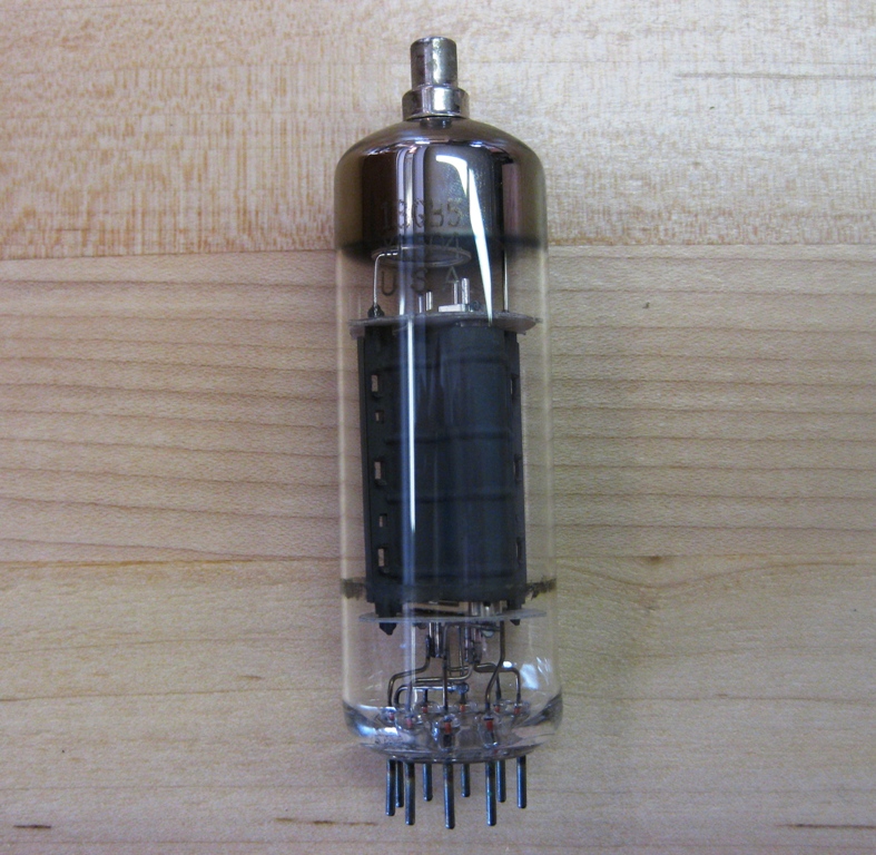

What about a PPPPPPPPPPPPPPPPPPPPPPPPPPPPPPPPPPPPPPPPPPPPPPPPPP 13GB5 amp? Here is a pic of 50 in this box, I have another 50 in another box from Rogalski's at 50 cents each in quantities of 100. Says "Made in USA", not sure if these are the "big power" 13GB5's or not.
The nine pin sockets were 35 cents each and the plate caps 30 cents each from Goodcomponent.com. Shipping almost doubled the cost but still a deal. The sockets are #GZC9-2-F and caps #MCV. Caps fit the top nipple but do not shroud the whole thing.

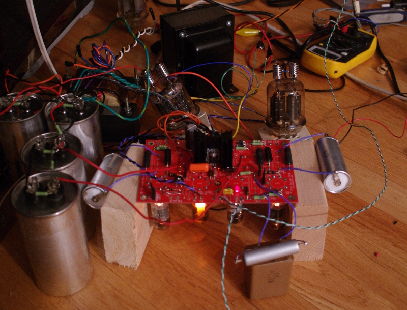

I got it powered up last night.. Voltages all checked out, got the driver board set up, plugged in the output tubes (3d21wb's, for now). I turned up the bias and they biased properly, (put them at 40 ma) but I had a loud buzz. I turned it off for a quick checkout.. Moved some heater wires, etc. Then turn it back on.. It gets very loud. I look at the meters on bias, and they are pulling about 100ma! I turn the bias all the way down and they are still pulling 40ma! (first power up, w/ the bias all the way down, they don't conduct at all).
So, this morning b4 work I checked the bias voltage, and it's still fine.. (-80v is the max, which is how it was originally).
Now I'm stumped.. What would cause that? My first guess is it's the tubes.. For one, they came out of a huge bin of random unboxed tubes.. And 2nd I've got no plate caps and only have wires wrapped around the anodes.. Would the screen burn up if the plate got disconnected? And could a burned screen cause problems like this?
I had issues with some of my used 3D21WB's. The 5 new ones that I got from ESRC seemed OK but I didn't run them for long. Some of the used ones exhibited bias creep and eventual runaway. Looking back now I believe it was a grid current issue but I don't have an amp set up to play with it right now.
I have a box full of the small plate 3D21B's, but I think they will go to the hamfest next month. I still have way too much stuff in my house.
It is possible, and likely if the screen is connected directly to a power supply. I usually put a resistor in series with the screen. I undersize it (1/2 or 1 watt) during testing but use a 2 watt part for a final design. The resistor will smoke if the plate goes open. The screen will glow white hot before it fries, so it is usually obvious.
Thanks George. One of the tubes was causing trouble.. Now it's all good :D :D :D :D :D
The horrible BUZZZ I had was a bad connection at the input ground.
Bias is still crazy.. As they burn in I have to keep turning it down.. a lot.. and the balance drifts all over the place.. One tube pulls about 1.5x the current for the first few minutes of operation, as it warms up. But.. that's all probably par for the course.. I'll let these burn in for a while.
