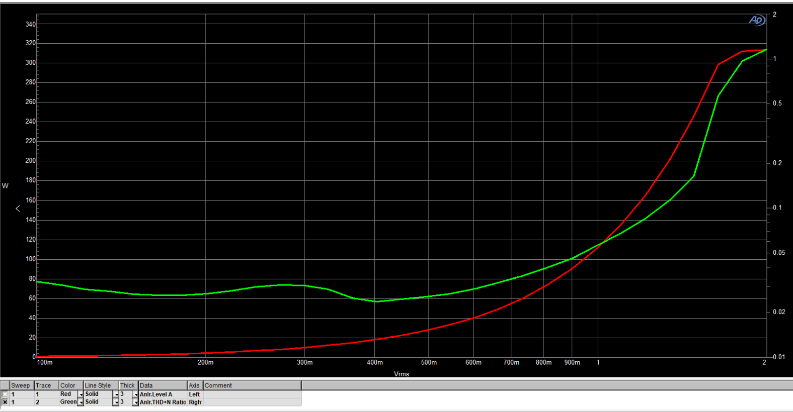

Please refer to below 100Hz test data-- Bridge output, 16ohm loadThank you for checking! Yes please share when you can. I’m using it like an instrumentation amplifier, so it will be useful to know.
Red = output power curve;
Green = THD+N curve

Thanks so much for measuring that. It seems to be about 0.5% THD at 260W into 16 Ohms. Is the x-axis the RMS input voltage, which would be about 1.4V (guessing because logarithmic axis is hard to read).
I think this is good enough for my purposes, and definitely an improvement on what I have.

If you refer to the 0.5% THD+N, the output power is close to 300W, at the input near with 1.7Vrms input
