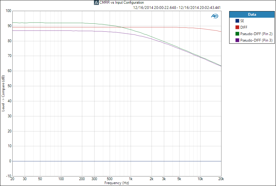

I am making the RCA version. According to the drawings, the safety earth and the zero volt line are at the same potential.
That's the idea, yes.
Would there be any harm/benefit in inserting the "ground loop breaker" found on Rod Elliott's pages between the chassis and the zero volt line instead of wiring the zero volt line directly to the chassis/safety earth?
Even in the RCA version of the amp, you're still getting good rejection of anything injected on the input lines. See the attached graph. With differential input, you get a CMRR following the red line. With RCA input on the Modulus/Parallel-86, you get the purple line. With any other single-ended amplifier design, you'll get the blue line (straight at 0 dB, no rejection at all). Ignore the green line.
With the MOD/PAR86, take the if it ain't broken, don't fix it approach. I see no need for ground breakers and I can't recommend them as they're against the electrical code in most places.
My prototype circuits typically involve a PCB mounted on a heat sink with the power supply and wiring in spread eagle formation on the lab bench. I've never had audible hum in the speakers. The highest mains hum component is at -120 dBV (MOD86). That's 1 µV. Most tube guys would be envious of <1 mV of mains hum. The MOD86 is 1000x better...

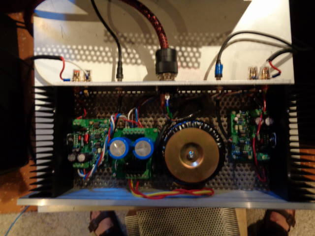

On better news:
The toroid and power supply started up.
It is at 29.5 VDC with no load. The project ships with R10 = 33K ohms while 47K is actually being recommended ( kind of on the edge ).
Should R10 be changed? What impact will this have on the device?
Thanks.

Thanks Tom. I have a 39K to try if it does not start up.

You can make the Pin 1 to Pin 3 short at the board. You will get slightly better CMRR performance if you make the Pin 1 to Pin 3 short at the RCA connector rather than at the board. Even better performance, yet if you make the connection at the source using a pseudo-differential interconnect cable. And best performance if you use differential signalling.

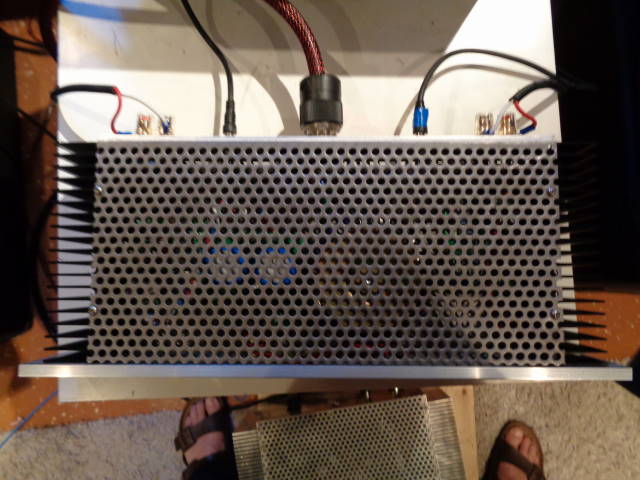

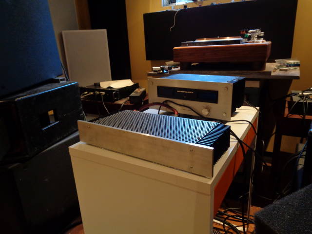

It sounds terrific, and it is only doing 100 -> 900 Hz. Much better than the previous amp that was in that spot -- Marantz 250M.
I'll have to build some more of these!
This on has no on/off switch and no indication of on/off. I leave my amps on all the time anyway.
