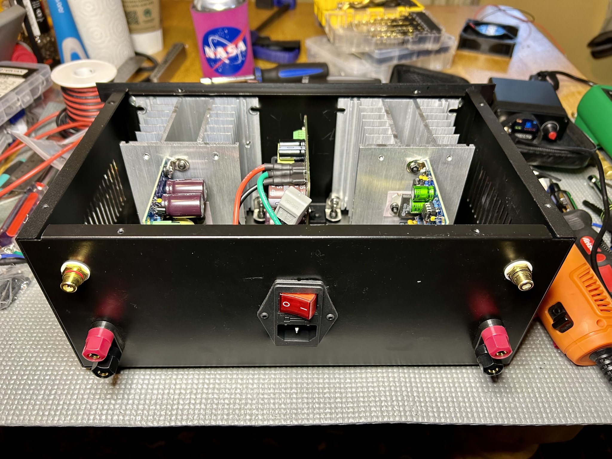

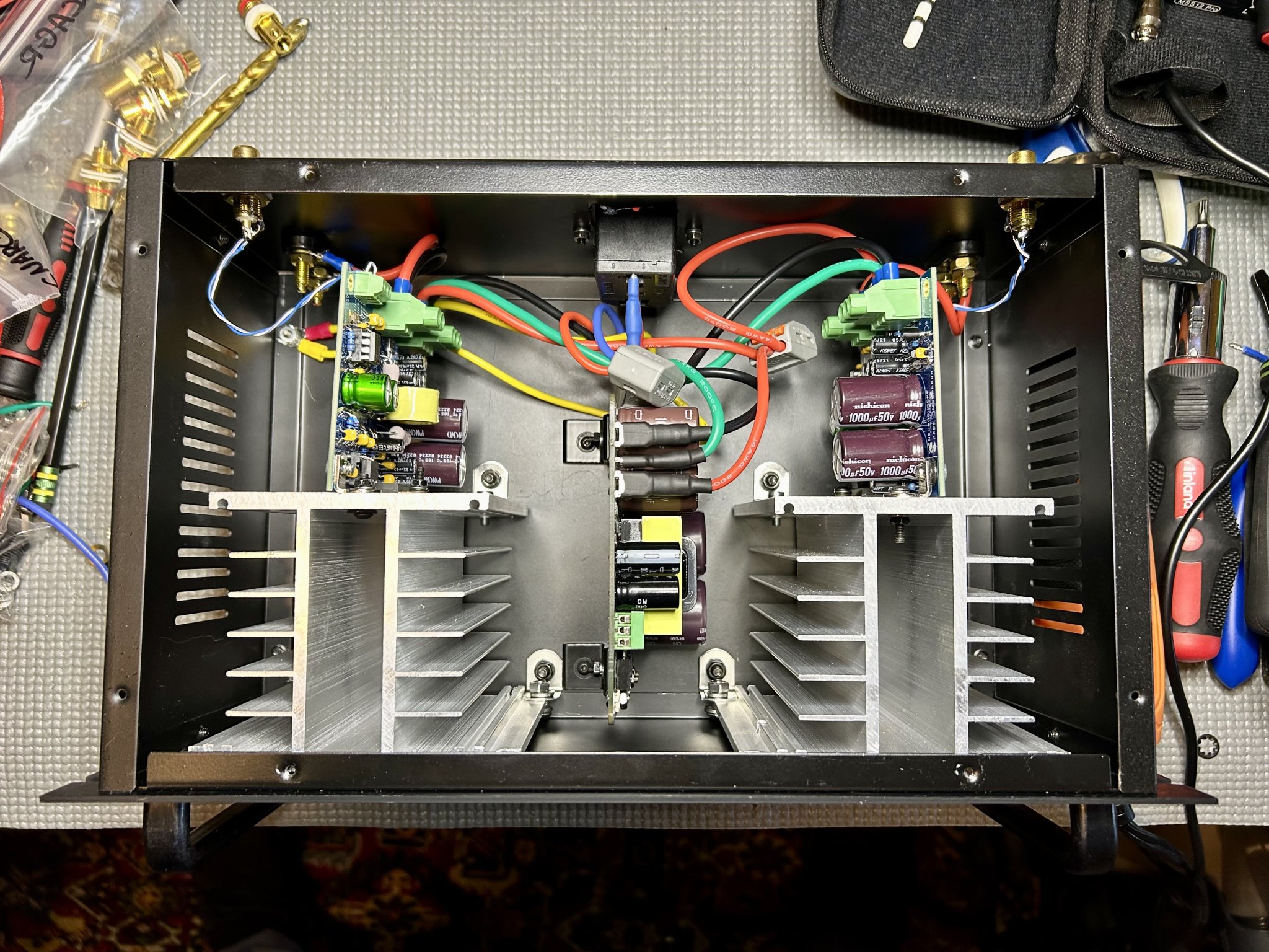

Big mess, big reward. Yes, it’s a bit crowded and I cheated with Wago-like Connectors, but it’s got a total silent background.

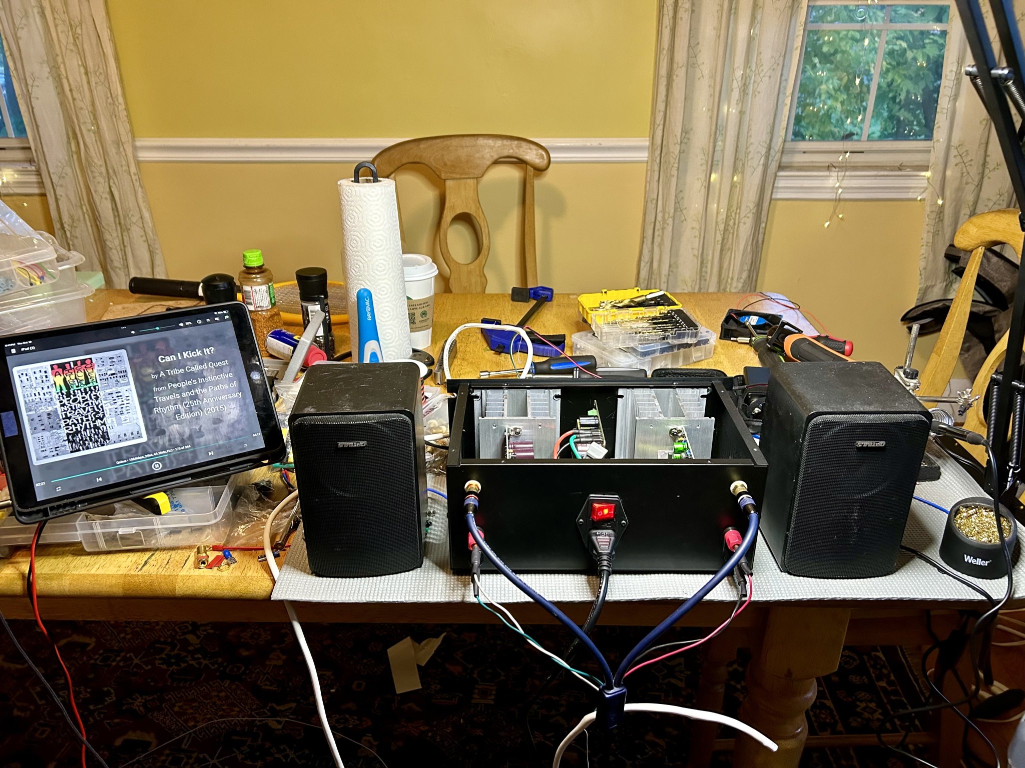

Playing very well through my test speakers. I don’t think this will last long before I put it in the main system.
Can I kick it? Yes, I can.
Thanks again, @tomchr, for a great audio product.

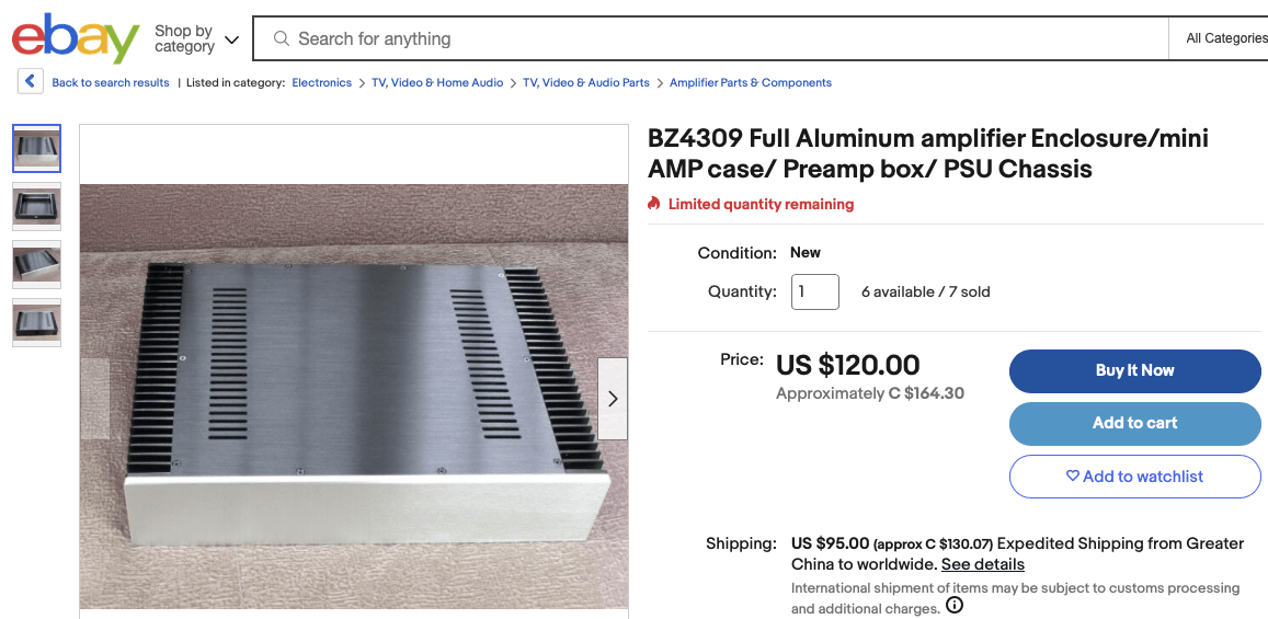

im having a rough time with a chassis when it comes to shipping. the BZ4309 pricing is either just a bit under modushop but it has no heat sinks ($78 shipping to hawaii). i saw someone repurpose a sony receiver case so im hoping i come across one of those as a thrift store

Thank you for your thank you. Sorry. I don't keep track of who said what to whom on which platform. That's why the dots didn't connect.i posted a thank you when you had it on youtube
Ah. I see the ePay vendors have started to use BZ4309 for anything 430x90 mm. Grr... That's OK. ModuShop offers a consistent product for the same price. But for completeness, this is what I was referring to: eBay item ID: 161816586829. It definitely has heat sinks.BZ4309 pricing is either just a bit under modushop but it has no heat sinks
That can be a good route. You can also buy a heat sink from ModuShop, eBay, or a metal scrap yard or eWaste recycler and make your own chassis. When I was in high school and early college I made quite a few chassis that way. I'd buy scrap sheet aluminum and scrap heat sinks and make a chassis. I'd either sand or sandblast the chassis and apply a coat of clear enamel. It's work but it can be made to look good.i saw someone repurpose a sony receiver case so im hoping i come across one of those as a thrift store
There's also Heatsink USA: https://www.heatsinkusa.com/ Their serrated fin options are pretty efficient.
Tom

It seems the Chinese eBay vendors charge a lot more for shipping they used to. I think they also use DHL/FedEx/UPS rather than China Post/EMS, but I don't know that for a fact. That makes them about as expensive as ModuShop and then I'd rather support ModuShop.
Years ago I ordered a pair of BZ4309 for two Modulus-86 builds. They were alright. They look good once assembled and I like that the top and bottom panels sit flush with the top of the heat sinks. But they're not the greatest quality. The parts arrived soaked in cutting fluid. The corner pieces that hold everything together needed de-burring and instead of a counterbore (that's flat on the bottom) they just drilled to a specific depth with a regular drill so I wasn't super confident that the screws would seat properly. Everything came together just fine and both amps are still going, but you can get better chassis quality elsewhere, including with ModuShop.

peterinhawaii,
2 lower cost options:
https://www.ebay.com.my/itm/196028586625 (approx 111.50 incl shipping)
https://www.ebay.com.my/itm/196029952077 (approx 141.60 incl shipping)
But as Tom already mentioned, maybe check out the Modushop options too.

peterinhawaii,
Not sure the internal volume is the right way to go.
Think about the layout you are going do, and how will place the PCBs (2 x amplifier PCB, 1 x power supply PCB) and the transformer in the chassis; given the internal length and width of a particular chassis, will you be able to place them on the floor of the chassis without any issues? The chassis should also be tall enough to accommodate the the toroidal transformer and the inside of the chassis lid should not be touching the transformer or any of the mounting hardware. Also see if you can rout the wires in according to best practices.
Also using a SMPS for power makes the build a bit easier, and the SMPS unit usually takes much less space vs the toroidal transformer + power supply PCB; much lighter too.

That's certainly one figure of merit (FOM) that one can use. But like any FOM it has its limitations. Unlike cats and peanut butter, the Power-86 and Modulus-86 aren't liquid, however, so it may be more relevant to use the internal X,Y dimensions first and then verifying that there's enough height to accommodate everything.Not sure the internal volume is the right way to go.
For stuff like this I will often draw out the dimensions on a piece of paper and use paper dollies representing the circuit boards (or use the bare circuit boards) to figure out the board locations. More recently I've started drawing shapes in CAD tools, but often the paper+dolly approach is easier and faster.
I think the Quad chassis is tall enough that you can stack two Modulus-86 channels. I'd plan for 6-8 mm from the bottom panel to the bottom of the first board. Then, I think, about 40 mm between boards. Male-female hex standoffs are great for this. McMaster-Carr can be helpful there: www.mcmaster.com

the quad 405 build here (https://www.diyaudio.com/community/threads/modulus-86-build-thread.267802/post-7059344) i m not sure i can get those heatsink brackets to do a vertical mount like that yet, but I am still looking for best practices for layout designs(like dont mount channels near a transformer or something). i was thinking the transformer on the bottom, the power 86 next to it, and just mount hte modulus 86 directly to the heatsink on the left and right side of the heat sink. (this spreads the heat over the entire heatsink i assume)
or with your suggestion tom(thank you), maybe mount power 86 to the heatsink above the transformer, and the modulus 86 on the right side on top of each other. heat is centered on the modulus 86 side so maybe its less efficient? but i dont know if certain modules should be near another module or not. the smallest enclosures has everything near each other so maybe no big deal? lol

With the SMPS you will not need the Power-86; so savings will be on both the transformer and the Power-86. It's less revenue for Tom, but he has always encouraged DIYers to build using either of the two options (Thanks Tom).

It's a good practice to keep the transformer and the AC wiring away from the amplifier boards and the signal wires. The AC wiring should be definitely twisted.
It is common to DIY builds wit the transformer towards the front of the case, and the amplifier modules in the center or even towards the rear (if heat is not an issue with placing the output device off-center); that way the input wire and the output (speaker wire) connections can be also kept shorter. It is a good practice to twist the speaker wires.
