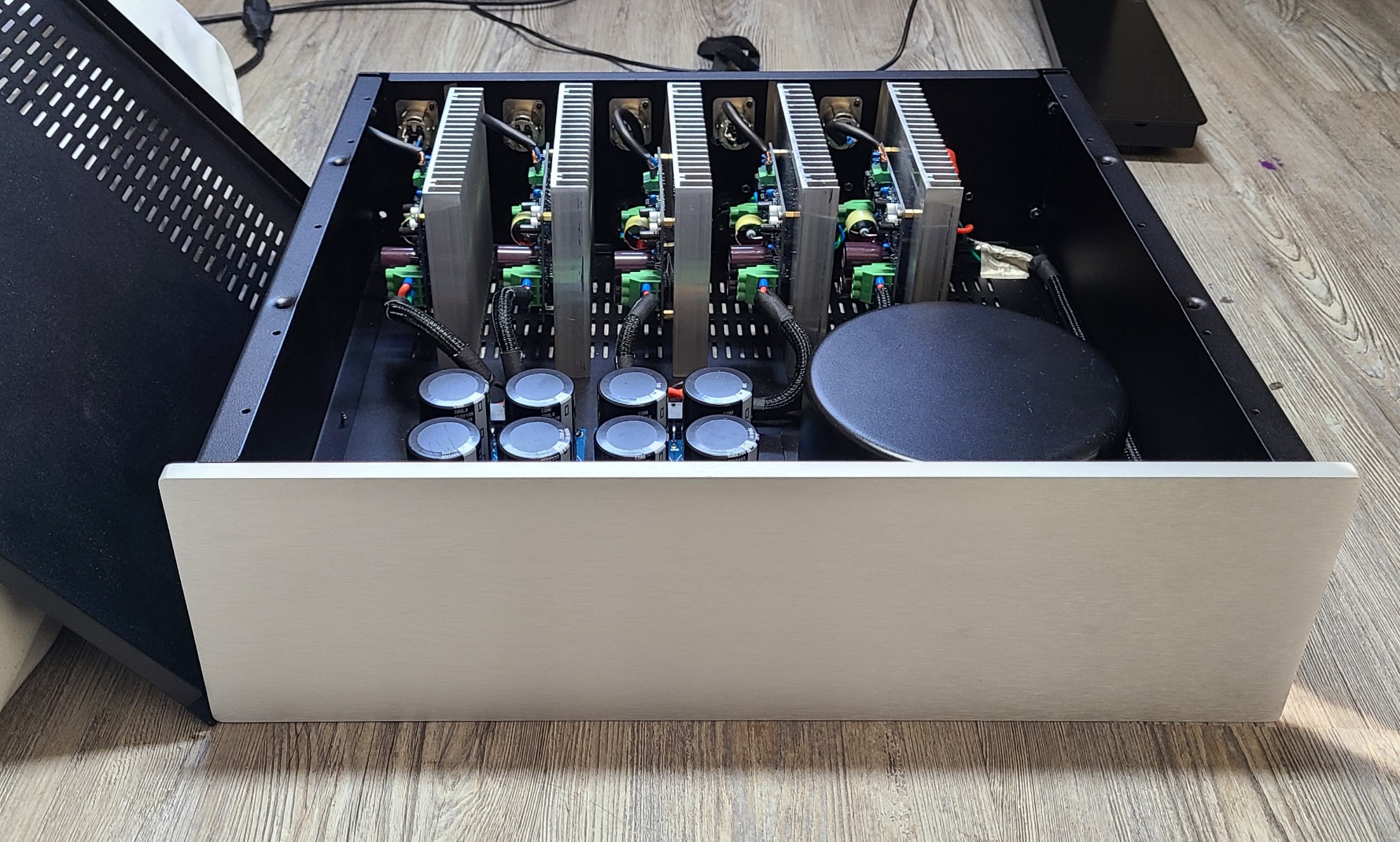

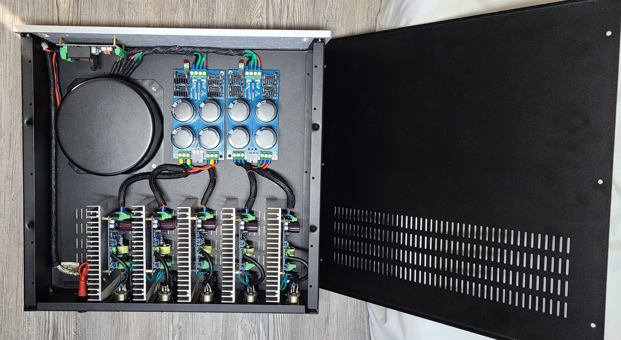

One amp is finished. Some cable dressing remains. Unfortunately listening tests will be on the weekend as I have some speaker cables to sort out as well.
That's a very well organized build diyadnut, congratulations.
