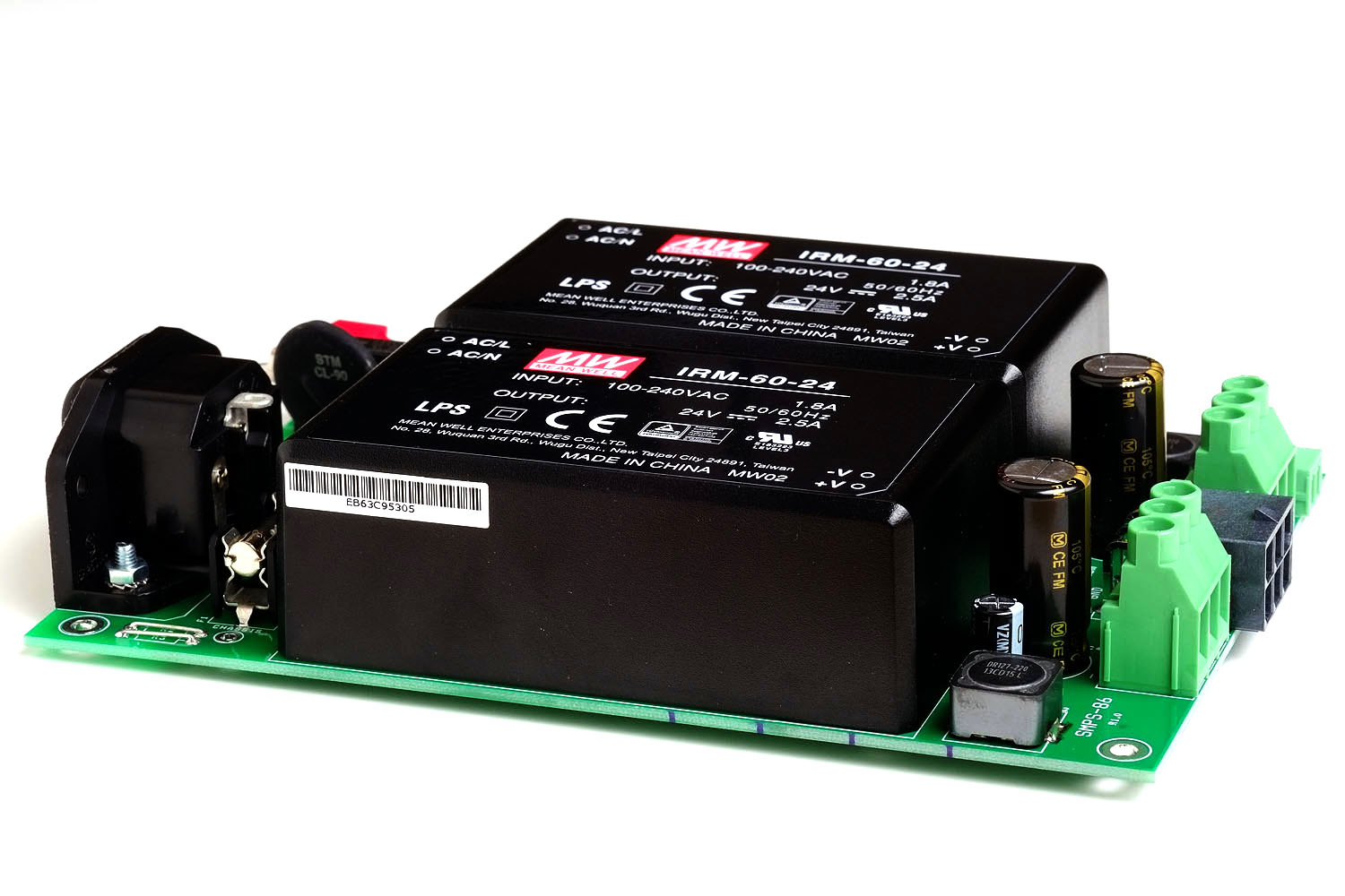

Those of you who are on the fence about the SMPS-86 might consider getting off the fence and onto the internet. I have three boards left and will likely not make more of them. It's a pretty slow seller and there are many more SMPS options available now than when I designed the circuit.
The SMPS-86 is an excellent candidate for a desktop LM3886-based amp, such as the Modulus-86. With that supply, an LM3886-based amp will deliver 28 W into 8 Ω and 28 W into 4 Ω. However, due to the current limit of the switching power supplies used on the SMPS-86, you will only get 2x14 W into 4 Ω if you build a stereo amp.
Thus, the SMPS-86 is mostly suited for mono blocks, for amps driving 8 Ω speakers, and desktop amps.
The SMPS-86 provides ±24 V @ ±2.5 A by default. It can be built for ±5 V (±10 A), ±12 V (±5 A), and ±15 V (± 4 A) as well. Many use it to power preamps and it would be an excellent, albeit a bit overkill, power supply for my Universal Buffer.
To see the current stock levels, please see my website. The current stock is indicated just below the price.

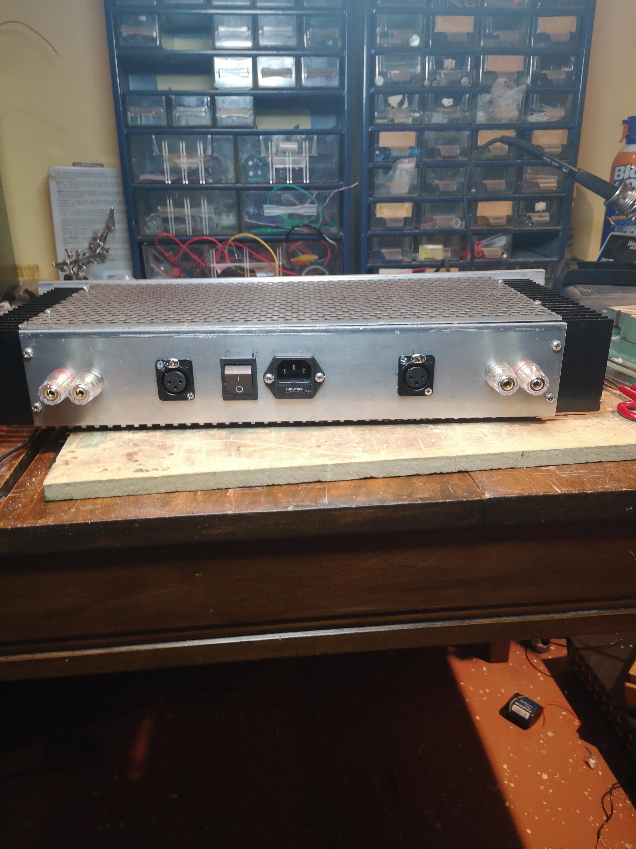

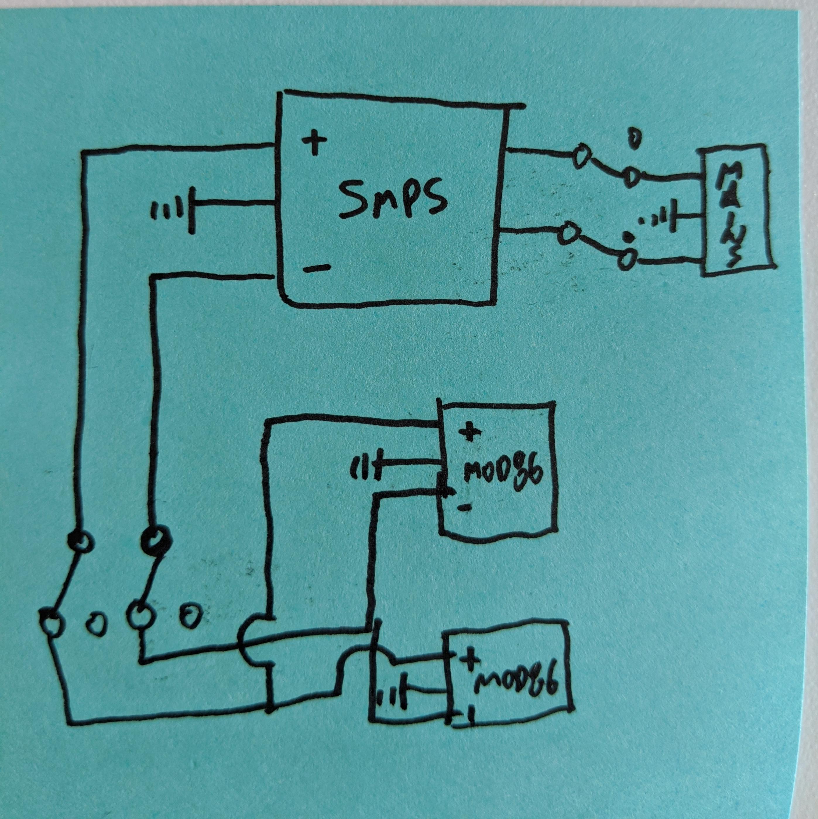

Changed to balanced and added a power switch!!! It's quieter. I really blew the initial wiring, but somehow it worked. This is better -- I'll try it in a full range system later this week, but for now, it's on the experimental system doing horn duty.
I too just stuffed the wire in.
Tom, I have a question. It's basic....In the docs I have, the power86 shows two ground points.
I've used only one -- the one on the DC connector. This is wired to a lug that is shared by safety earth.
Is this correct or should I also wire the AC ground connector? If I should wire it, should I also bring that to the safety earth lug.
AC mains inlet ground pin goes directly to the chassis. Sand off the anodizing and preferably use a grounding lug with 'teeth'. I recommend using a lock nut on the mounting screw for the grounding lug to prevent it from coming loose.
Then connect a wire from the grounding lug to the ground output of the supply.
Tom
Tom
Exactly what I did, except there was no anodizing to worry about.
My concern was solely due to the added gnd symbol on the version 1 drawings I have.
Thanks for clearing that up.
