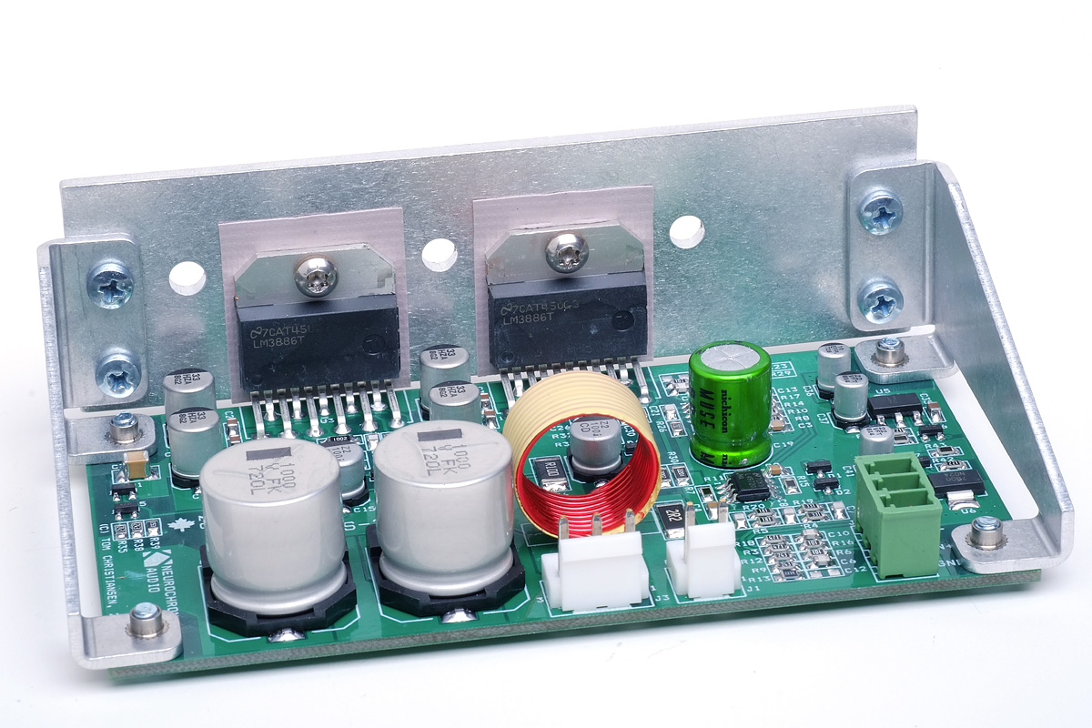

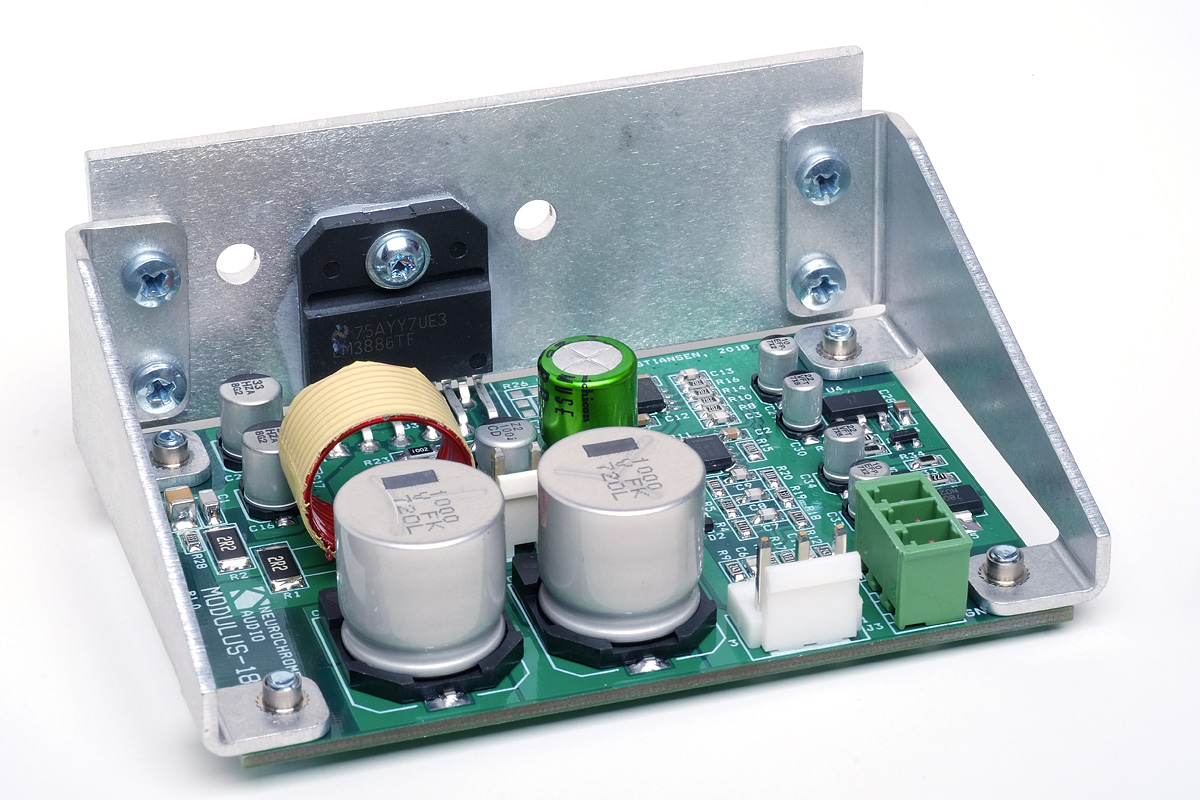

That's part of the design for sure. You'll find the Modulus-186 and -286 vendor threads here:
Neurochrome Modulus-186: 40W (8Ω); 65W (4Ω) @ <-120dB THD Composite Amplifier Module
Neurochrome Modulus-286: 65W (8Ω); 125W (4Ω) @ <-120dB THD Composite Amplifier Module
Pictures show the prototype builds of the two amp modules. The final version will feature Neurochrome Blue circuit boards and metal back LM3886es (LM3886T/NOPB, to be specific).

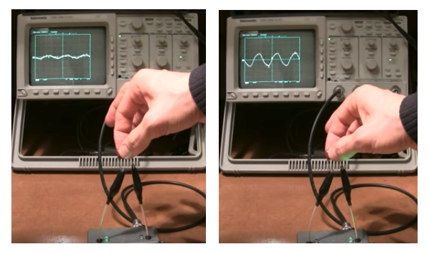

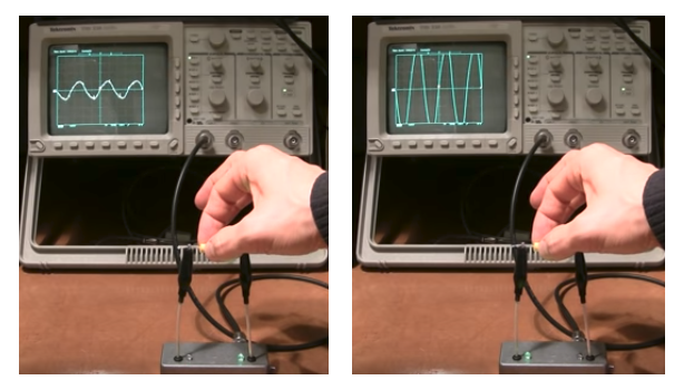

I'd add a correction to that video. I didn't watch the full 45 minutes of it, but in the introduction he mentions that film caps have a polarity. That's incorrect. What they do have is two sheets of film rolled up with a sheet of dielectric in between. As result, one sheet of film/foil will be on the outside. You can reduce hum pickup (important in phono stages and tape circuits) by grounding the outer foil in cases where the caps connect to ground. In those cases, there's usually a marking on the package to indicate which lead is connected to the outer foil.

Yes, that's the theory, but what that video shows is that these indications are often wrong. If that is really the case, it looks quite surprising to me that no one else had ever noticed this behaviour. Looks quite "suspicious" to me at the very least.In those cases, there's usually a marking on the package to indicate which lead is connected to the outer foil.

Capacitors that are wound such that there is an inner foil connected to one lead and an outer foil connected to the other have differing noise characteristics. You cannot go by things like the direction of printing because when caps are manufactured they are not lined up in rows like little soldiers, but instead binned between manufacture and printing. So the outer foil is essentially random as far as the printing goes.
It is said that the outer foil used to be marked on caps with a bar at one end, but if that was ever true, it changed in the 1950's with different manufacturing equipment. The bar was retained (why replace a perfectly good cap marking machine?) but meant nothing.
In-circuit the outer foil should face the lower impedance side of the circuit. That provides the lowest noise performance.
You can determine which lead is attached to the outer foil with a test apparatus, or with a 'Scope. The procedure is, basically, using your body, touch the cap and note the noise level; one orientation will be noticeably lower noise. Your body acts like an RF antenna.
The reason is the outer foil acts as a shield.
Electrically there is no difference, so other capacitor-related values will be identical either orientation with non-polarized caps.
Manufacturing of consumer electronics almost certainly has no patience for such testing and assembly, but we're DIY nerds, who take a bit longer to build an amplifier than Pioneer or BOSE does. So I think it's OK, or at least understandable, that we obsess over these details, if only to help us sleep at night ;-)
