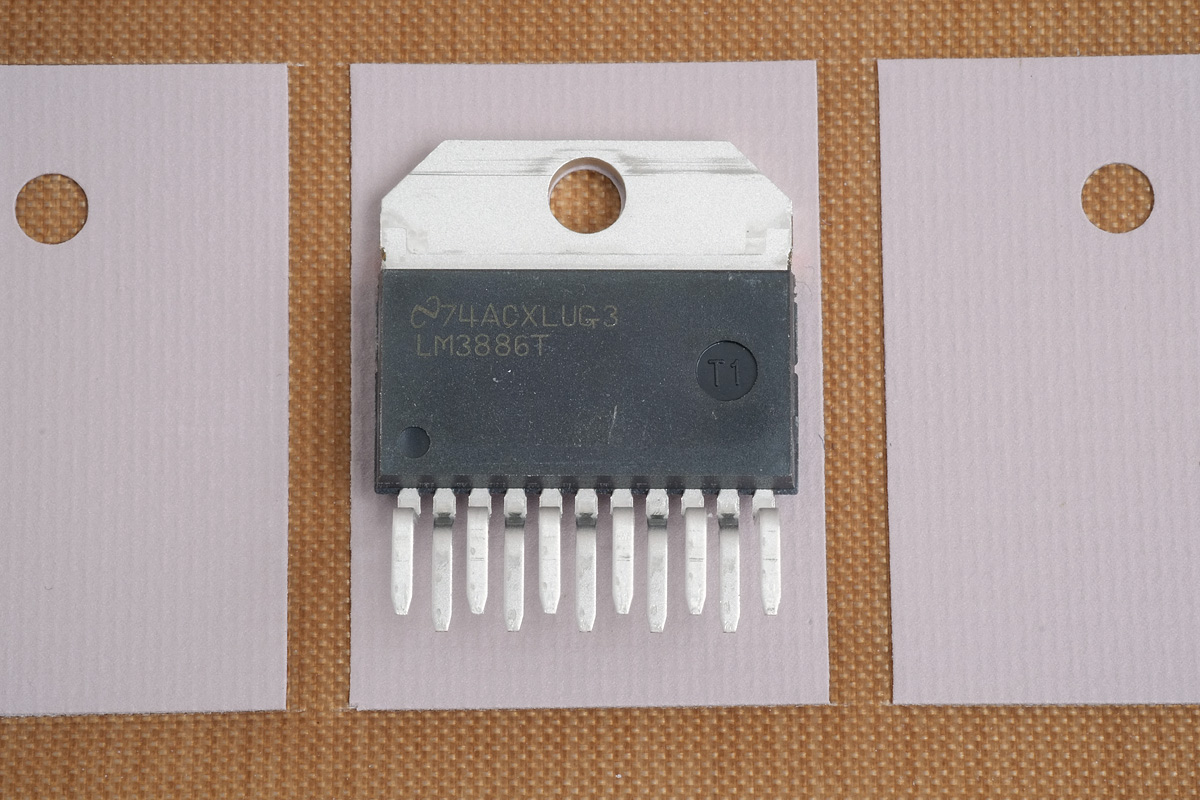

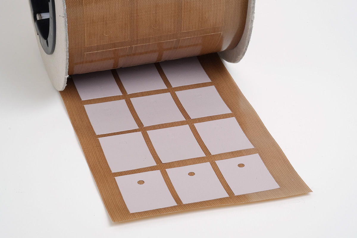

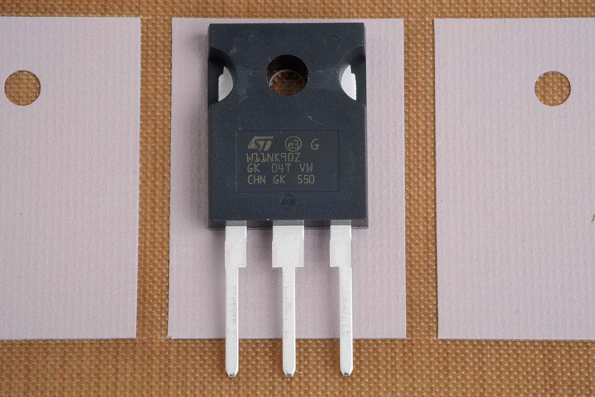

Those who wish to push their Modulus-86 to the limit and, hence, use the metal back version of the LM3886, may find these interesting. Keratherm Red 86/82 thermal pads. Fit the LM3886 to a tee. To the best of my knowledge, they're the lowest thermal resistance pads available on the market.
Similar pads are available at the DIY Audio Store and I am not intending to compete directly with them. In fact, I might charge slightly more per pad as I'll be offering them in lower quantities (QTY = 3). I needed them for the fully assembled Modulus-686, and figured I might as well become a one-stop shop and save people a little on the shipping charges.
I'll have them on my website by the end of the weekend.
